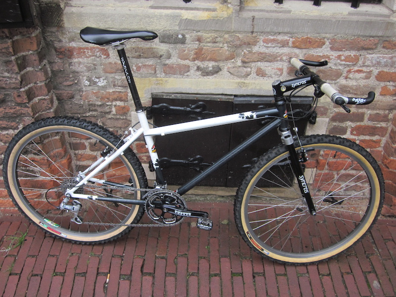

Earlier this year, I came across a great set of rigid forks on Marktplaats.nl: fair-priced, very good condition, Sycnros Powerlites that were offered from closeby; so I bought them :D .
The initial idea was to exchange them with the RC30's on my DEAN Ti, that I have been using as a commuter throughout last summer :cool: .
Unfortunately, the steerer on the Powerlites was just a tad short for the DEAN head tube, which started off the hunt for a suitable frame to do my new Syncros forks justice.
After my plans involving a wishbone RM Stratos frame turned sour :( , I decided to swap my Zaskar frame (that built up did not evoke the excitement I'd expected..) for a 1996 RM Blizzard frame, the well-known Anniversary Edition that has been the centre of several build threads on here recently.
And that was the basis for this period-incorrect, but (IMHO) sweet, build with kind of a Canadian theme.
Frame: 1996 Rocky Mountain Blizzard (17.5")
Fork: Syncros Powerlite
Headset: Chris King Sotto Voce NoThread, black 1 1/8"

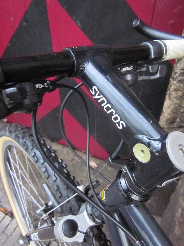

Stem: Syncros Cattlehead, black (+ top cap)
Handlebar: Kore
Grips: Lizard Skins
Barends: Onza
Brakes: Shimano Deore XT BR-M734
Brake Pads: Shimano XT/BBB
Brake Cables: Shimano
Cantilever cable hangers: Shimano
Brake Levers: Shimano Deore XT SLR
Shifters: Shimano Deore XT SLR STI units
Front Derailleur: Shimano Deore XT M738 31.8 tp
Rear Derailleur: Shimano Deore XT M735
Derailleur Cables: Shimano
Cassette: Shimano HG 7-speed
Chain: Shimano
Cranks: RaceFace Turbine (110bcd, 2-ring)
Crank Bolts: of course
Chainrings: TA specialties
Chainring bolts: SRP
Bottom Bracket: Shimano UN-55
Pedals: Shimano M737 SPD
Hub Skewers: Shimano Deore XT M735
Rims: Araya RM20, grey (super hard)
Hubs: Shimano Deore XT M732
Nipples: Love 'em
Spokes: yes
Tyres: IRC Mythos (front), Piranha (rear)
Tubes: Specialized
Saddle: Flite Alpes Titanium
Seatpost: Syncros, 26.8mm
Seatpost Binder: No brand, 30.0mm
Weight: Relatively heavy (it's steel..)

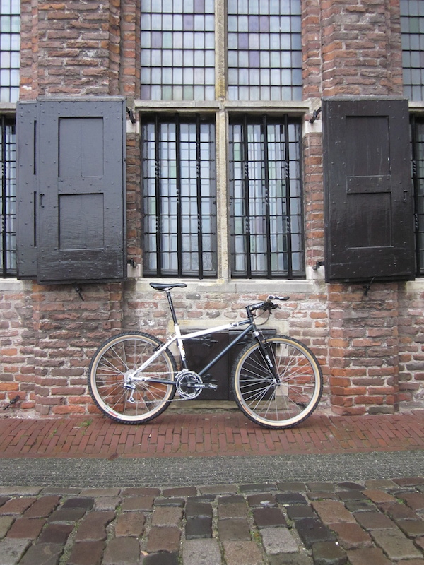

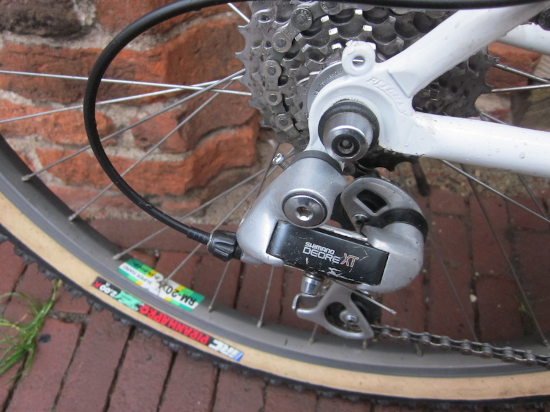

Last week, after having the final cabling done by my LBS :oops: , I took the Steel Rigid out for a spin around town.
What do ya think?
I cannot wait for spring to arrive, so I can get out of the car seat, onto a Flite and start commuting on this baby!

Very nice Eef. I always think the smaller sizes look the best :D

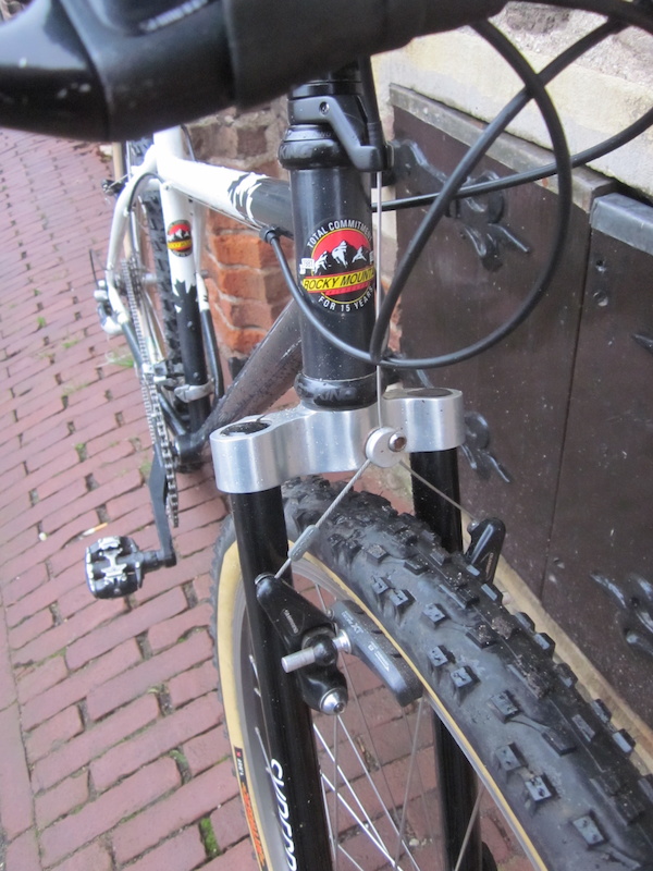

Build looks nice, I just don't like the forks on it :oops:
I'd be interested to here how it rides, though for commuting I doubt it matters.
Short pre-suspension forks on a mid 90's 60mm travel era frame.
Also I think the forks should be clamped a little bit lower on the leg ?

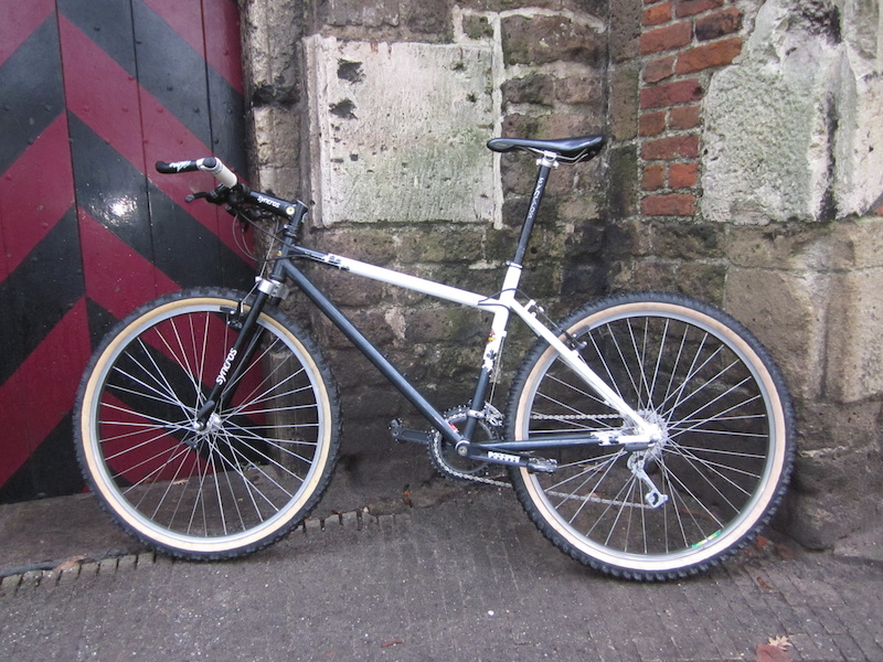

Looks way to small for you too, you should be on ~19" by the looks of it :LOL:, but I'm not riding it.
Is it me or is the seatpost bent backwards ?

Im i agreement with fluffy, in that the forks just look out of place :? and it is a bit small for you. Next size up would have been perfect :cool:
Im of the high saddle ilk with mine towering above the bars .Comes with being a real giant :LOL: but mine is a 20.5" frame so theres not a lot of sized above that/ and / top tube length.
If you look about you might find a 190mm long stem :p :LOL:

Nice to see another Blizzard here in Holland. Are you going to get the original decals applied?

you need an earlier RM for that fork, 96 is just too late in my opinion.

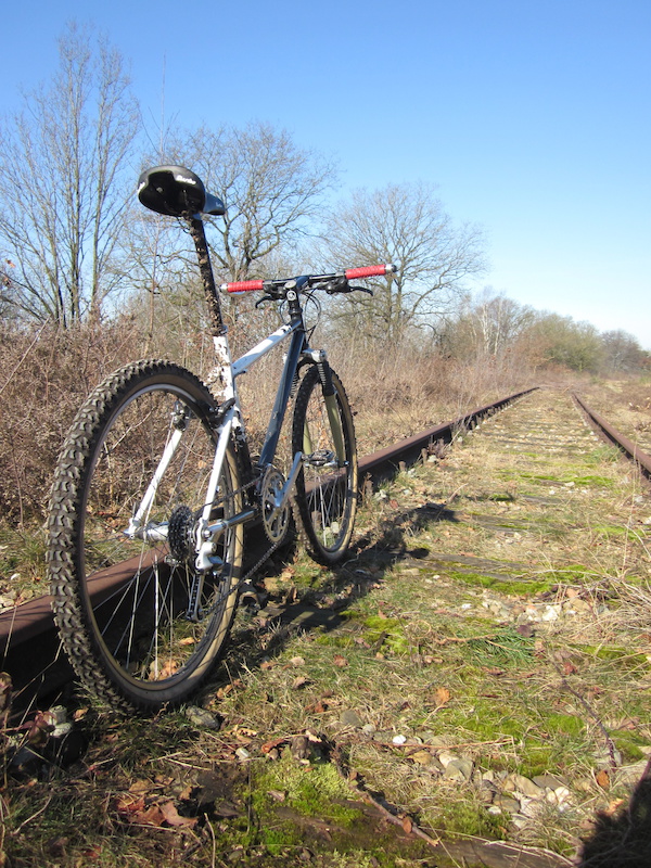

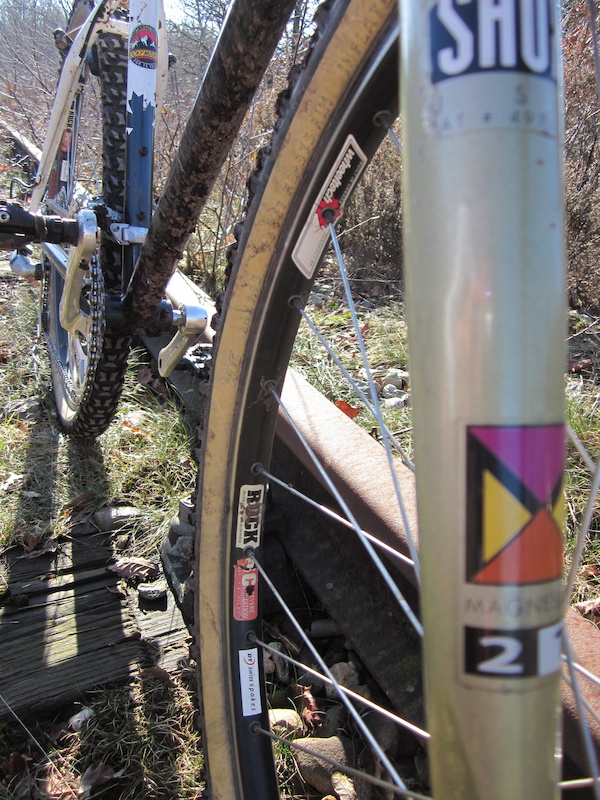

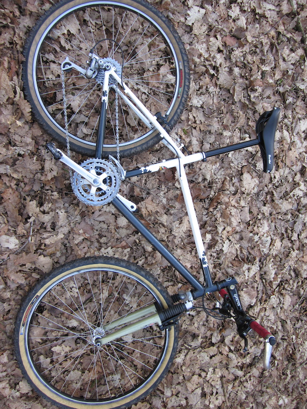

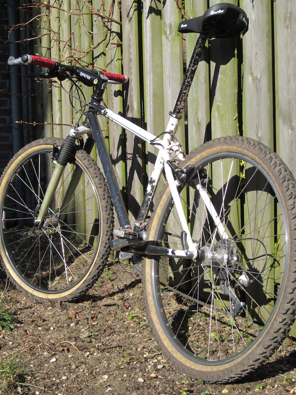

Spring has been in the air all weekend already: a great opportunity to head out on the Blizzard after some slight modifications to be able to ride off-road as well: suspension forks, triple crank set, the original Wheeltech-built wheels..
So, put on my bib shorts :shock: ;) , sunglasses :cool: and got on my way!
Oow, what a beautiful morning :LOL:
Despite the clear blue skies and warm sunshine, there are still loads of leaves and mud :D !
Right side of the tracks..
And back home, ready to be cleaned :)
After having commuted on the rigid version for quite a while, this bike also handles very well off road: I love it!
Hope you guys are also out there enjoying the lovely riding weather, looking forward to all your pictures..!
