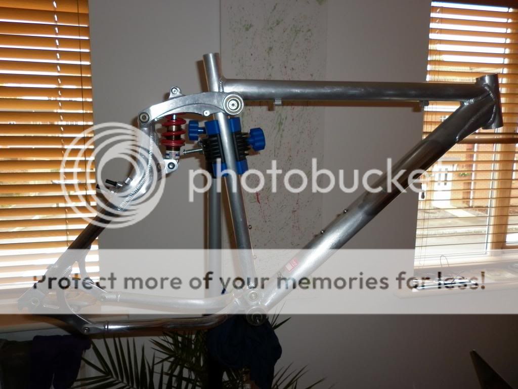

The frame, belive it to be a Lts 2 or 3, circa 95. Came as a bare frame other than the rockshox delux and a grumbling BB. It has been flatted ready for a re polish but that's not where im going with this frame.

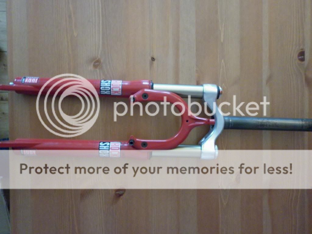

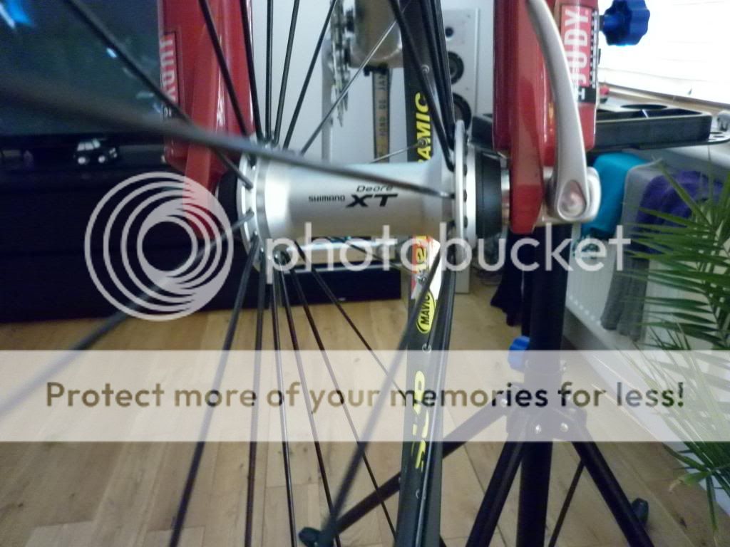

Forks, with thanks to Gio on these, lovely condition Rockshox judy DH.

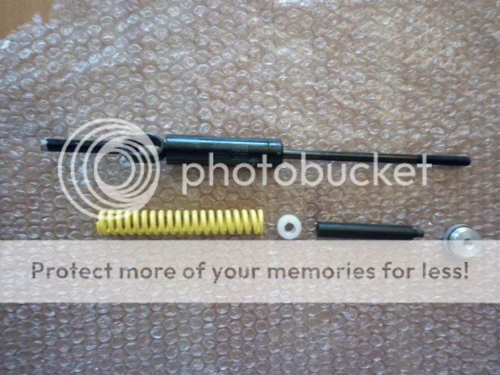

Couldn't help myself, had to have a look inside, anyone seen this set up? is this standard? dosnt look like it to me :?

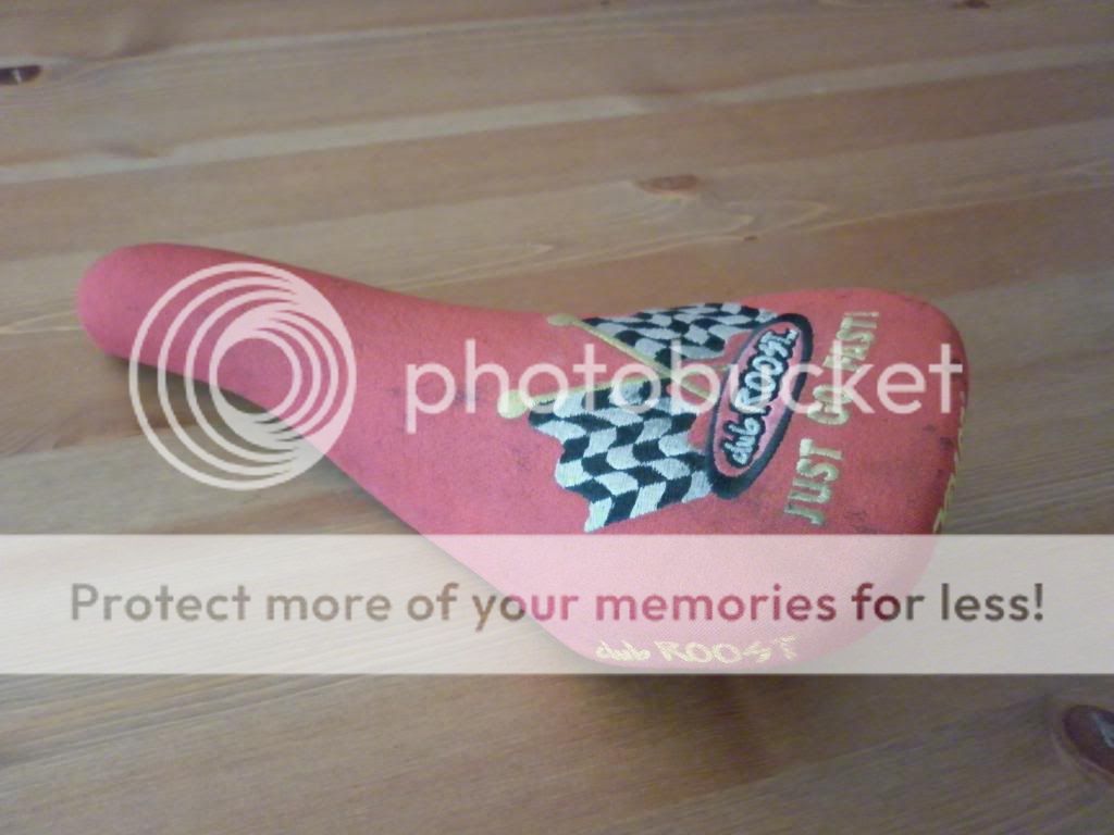

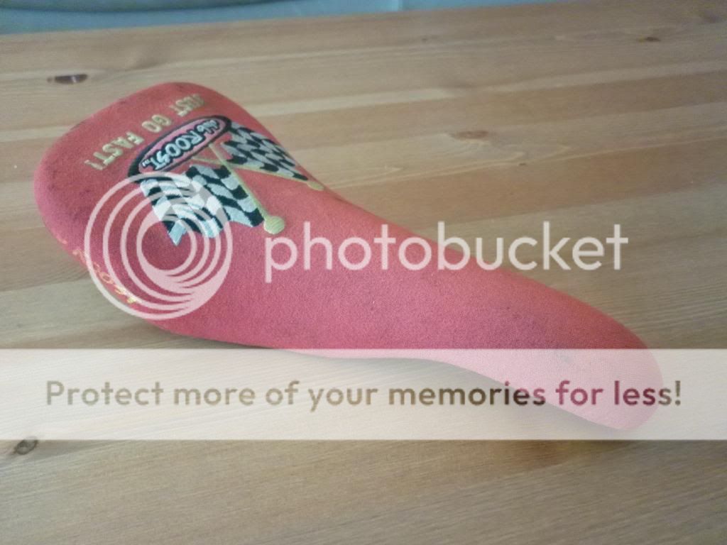

Club roost go fast in red.

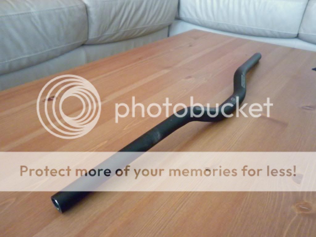

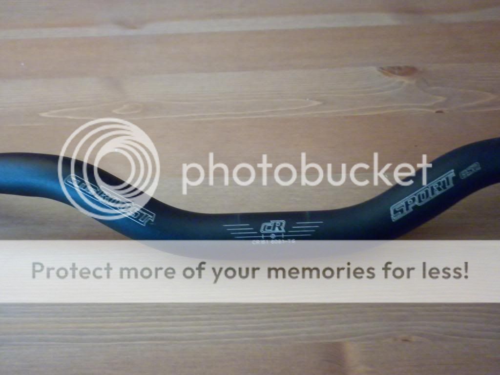

Bars, from my stash of bits, Club roost sport.

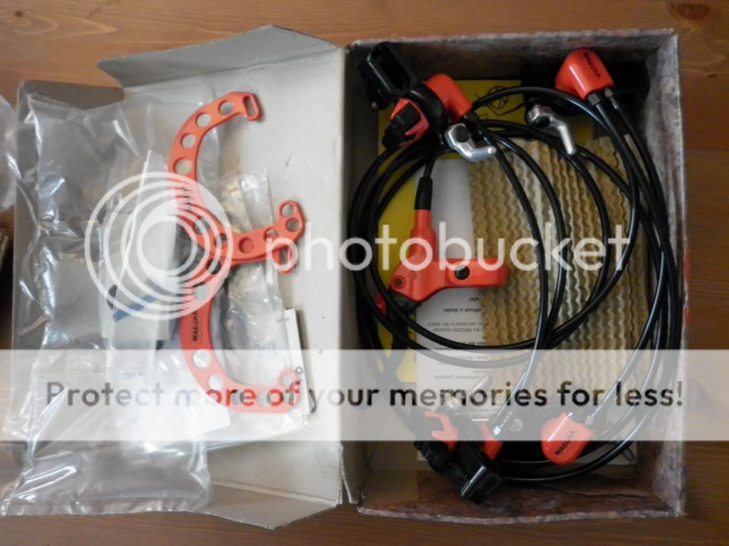

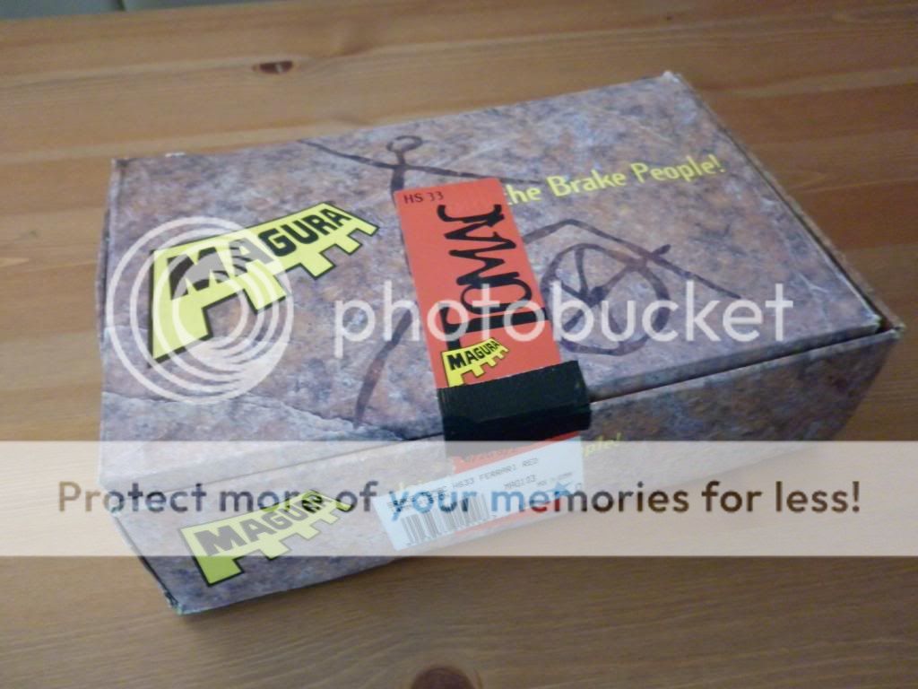

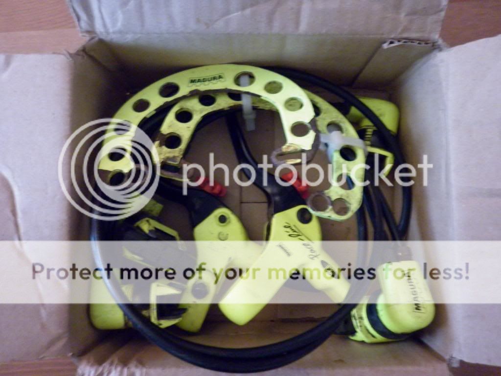

Brakes, now im not sure which to go with, going to be Magura's tho!
From my stash of bits, NOS tomac reds....
Or, Raceline 'D HS33's,not NOS and needs couple new bits of pipe and some refurb work.

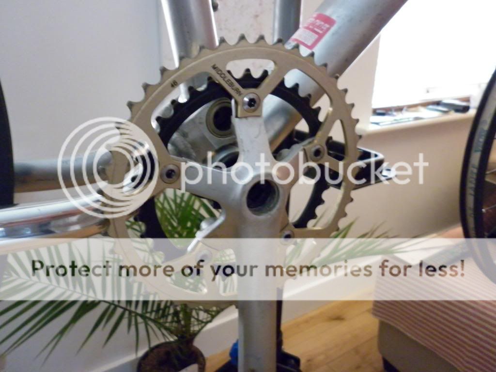

Cranks, nothing special at the moment, but will run a single middleburn 46t chain ring.

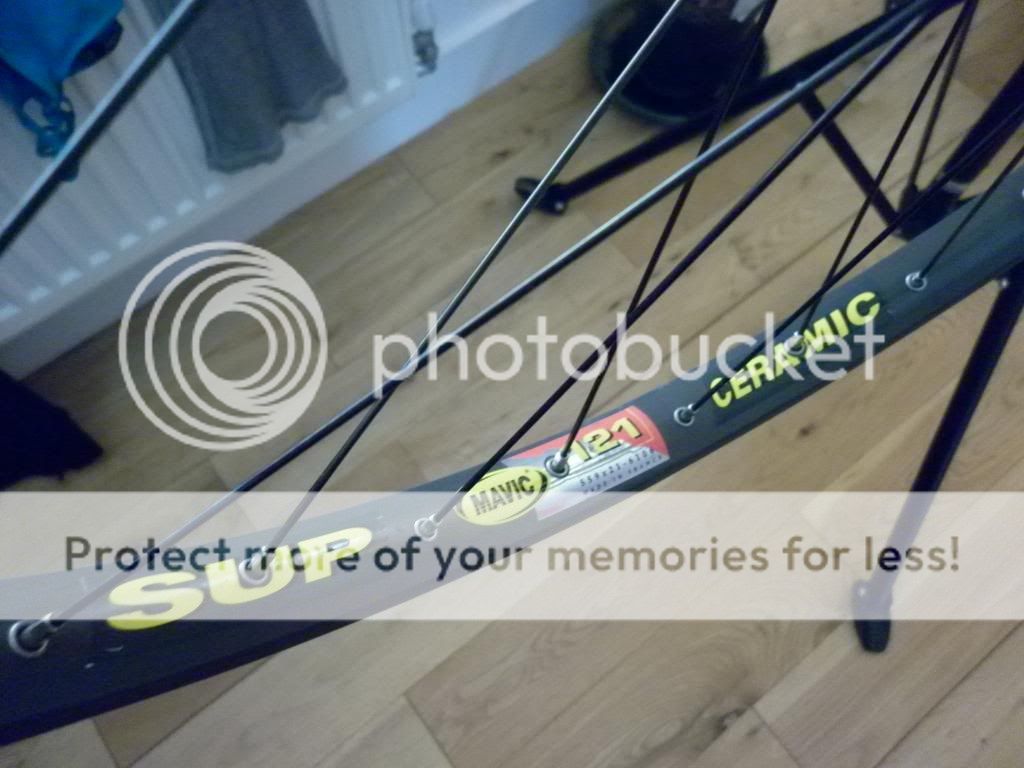

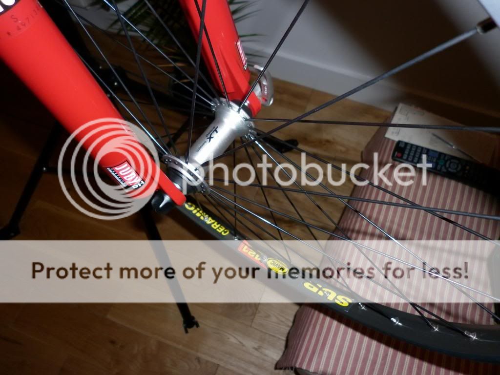

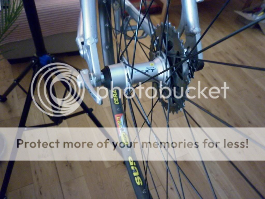

Wheels-spokes-hubs.
Now I love this set up. New XT hubs with radial laced on the front using black DT spokes,on the rear XT hub standard lace black DT spokes, both rims are NOS mavic 121 ceramic's.

Looking good so far!
and you are right.. thats not a standard setup in the judy's
its a wings damper.. I'd be interested to know how well it works compared to a normal judy setup..
i ordered one from the states a few years back and got sent a manitou version instead!!

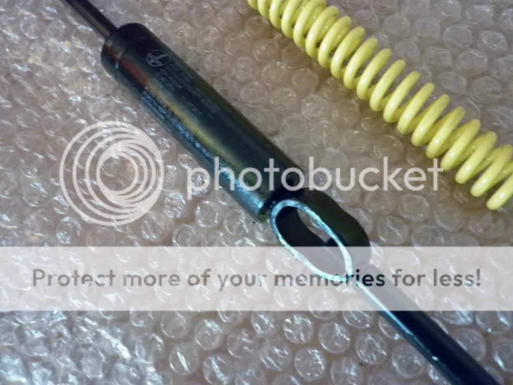

umm that's interesting, I have to be honest its not very good quality, and the spring that goes with it is VERRY stiff! :?
And it looks home made, half hours research could find the same parts to make the kit :wink:
PostPosted: Fri Nov 08, 2013 10:13 am
Joined: Tue Nov 04, 2008 12:00 pm
Posts: 840
Location: YORKSHIRE!!
i thought the same about the kit that i got.. the loop of metal just below the damper is just plain weird!
the stiffness is probably to do with the short yellow spring... im sure that wont even compress the full 75 / 80mm of the Judy DH..
is the other leg empty?
itll be a pain to change the system in the fork too unless you have spares.. you are pretty much going to need a whole new set of internals to replace the wings damper...!
PostPosted: Fri Nov 08, 2013 12:17 pm
Joined: Sun Sep 22, 2013 10:21 pm
Posts: 2362
Location: Aldershot
The other leg has the original damper and a spring upgrade, I have left the wings kit out at the moment as im not using them yet.
I do have a new replacement spring/damper kit I may end up using.
The metal ring on the bottom if the damper is just squashed into that shape, you can see the grip marks from a vice :?

Your rims would be perfect in my STS-DH build! :P
I'd say the frame is either newer than you think it is or has had the rear stays replaced. Seatstays are definitely '97+, first year for the Taiwanese LTS-2 was '96 and that year will have the canti mounts closer to 90° to the seatstay below the kink. In '97 it becomes the LTS-3 and they angled the canti mounts down to give clearance for V-brakes; they don't fit on '96 seatstays.
Looks good, interesting to see where it goes.

Hi Shogun, this frame is a bitsa frame it seems, not entirely sure on the year of the frame components.
Update on this tho, after seing a couple of "different" gt full sus builds I may change the plan, but not 100% sure yet. Watch this space!
PostPosted: Thu Nov 14, 2013 6:26 am
Joined: Sat Dec 29, 2007 7:21 am
Posts: 885
Location: Hobart, Tasmania, Australia
What's the serial? Will clear it up very quickly.
