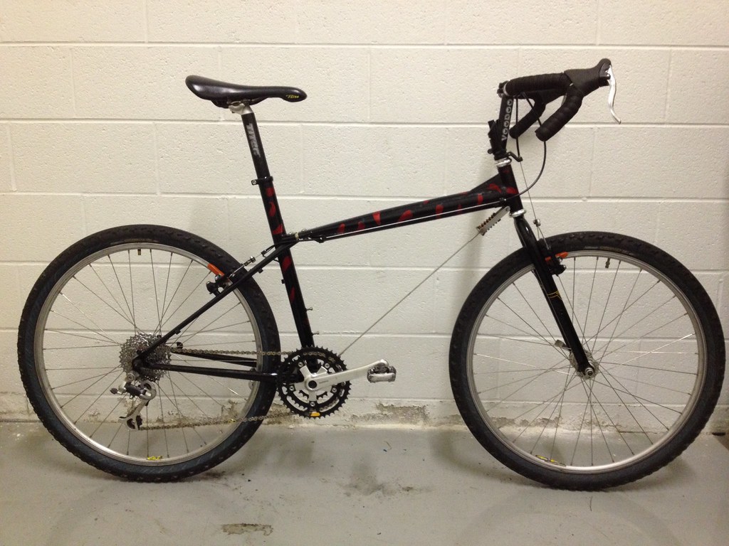

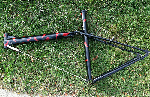

Almost done with this one. The 7th Slingshot I've owned (previous: 1991/1992? mtb in lilac, 3 Farmboy 29ers, 2004 BigShot Serial #1, and a 2005 folding road).
Picked up locally from the original owner. Frame was requested paintless from the factory and a friend of his did the custom chili pepper job. The peppers are airbrushed on, then covered with clear coat. For a 20 year old frame it's in pretty great shape. The Scotch-ply board looks great.
It didn't come with the original Sling fork, but instead a Kona Project 2 - which also (and unfortunately) has clear coat over the branding. Geometry seems right though (410mm A-C).
Hard to read the serial numbers on the BB due to thick paint, but I'm guessing it's somewhere in the 1993-1994 range based on the dropped top tube and 1" head tube.
Build is likely going to end up as a 1x7 using most of the XT kit from a low mileage (but rusty) 1991 Stumpjumper that I salvaged. Now on the hunt for a 31.8 Syncros post. I originally mocked up a dirt drop build (below), but scrapped that.

Thanks for the comments - the paint is ok - I wish it was purple/lilac like my first frame of this gen. Chili peppers belong on Salsa frames - haha.
I'm getting close. My 1" silver ahead stem arrives tomorrow (currently using a shimmed down Thomson, which looks like poop). No way I can run a narrow flat bar on it - sorry folks. My 40yr old self needs a little more rise and sweep, especially with my carpal tunnel.
Not sure about the weight thing - I'm 165 lbs now. I was pretty close to two-hundy a few years back, but I was riding the beefier modern Sling frames back then. They were fine.
I've ridden it a few miles so far- oh how I love these. They are so alive underneath you.

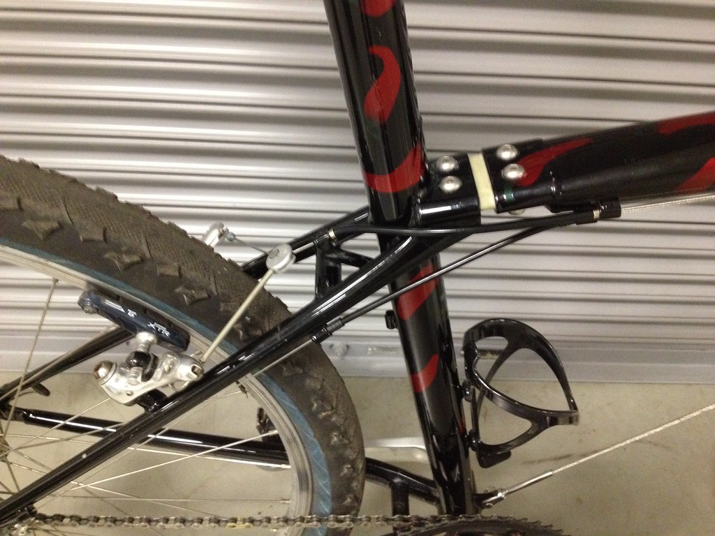

the flexy bits:
Still need to dig out a silver cable hanger, some proper brake levers and get my more period correct wheels on there, but it's coming together. It'll never be a show bike, so I may not bust myself up too bad trying to go 100% period correct.
