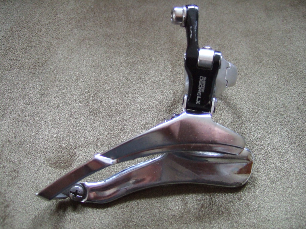

The components are a mix of Shimano Deore LX M550 and Deore DX in the MT-62 and M650 incarnations.
So you'll need the following parts:
M550 Deore LX rear mech
M550 Deore LX front mech. I think it's a 31.8mm band size for a 92 Tufftrax Elite.
