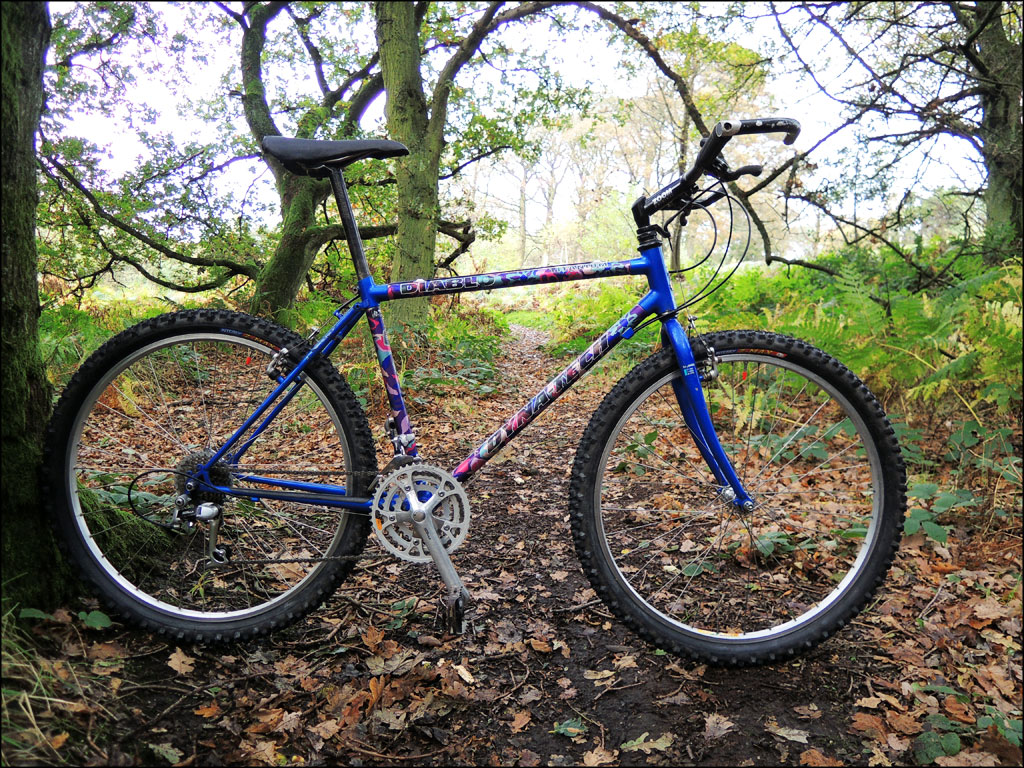

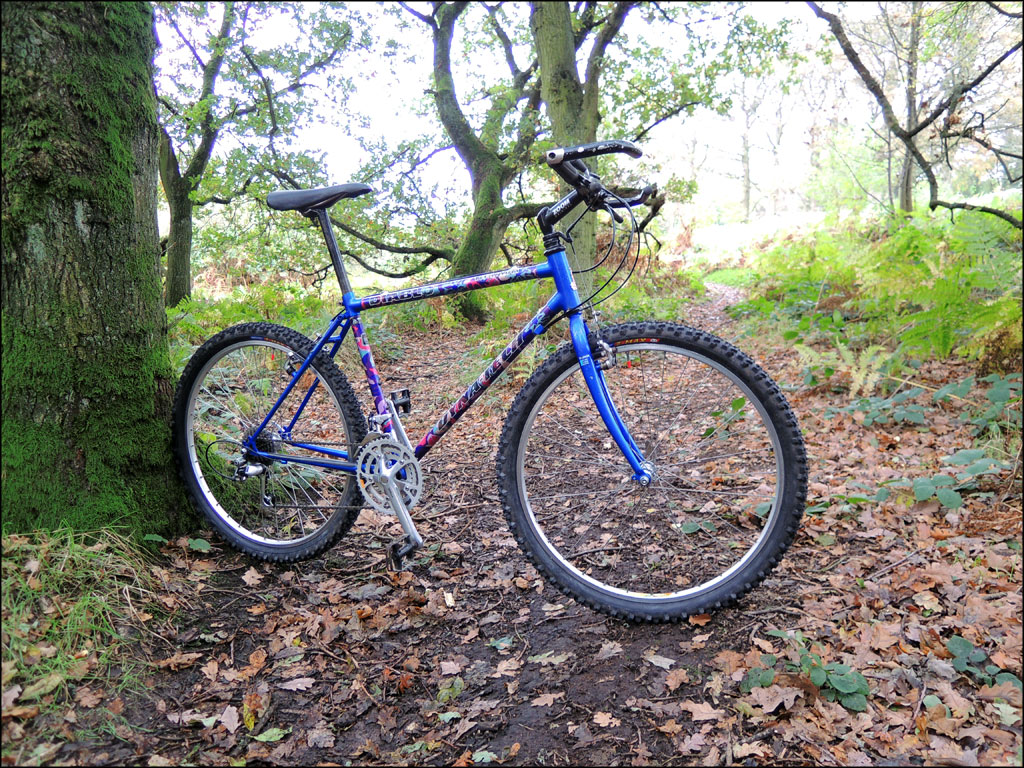

When I collected this bike during the summer it wasn't in the best of states. The original stem had been replaced with an ill fitting quill adaptor and the titanium bars were bent and distorted. The rear hub was also badly worn. However underneath the grease, dirt and cobwebs was a bike that was in reasonable condition.
So the whole thing was stripped back to the frame, all the parts and bearings cleaned, regreased and reassembled.
There are still a few remaining issues, namely one of the brakes which has a broken plastic spring cover and the pads are worn but they'll be replaced in time.

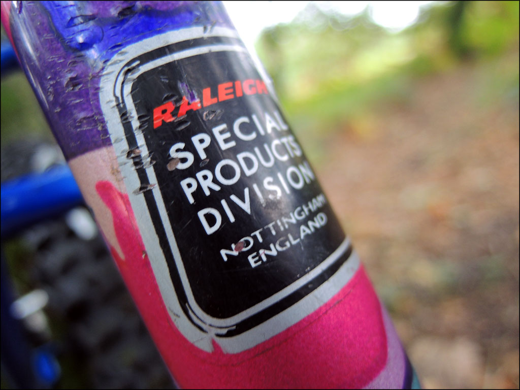

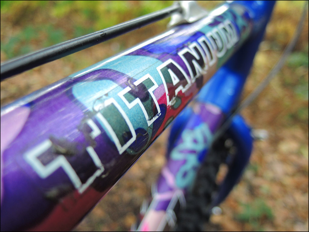

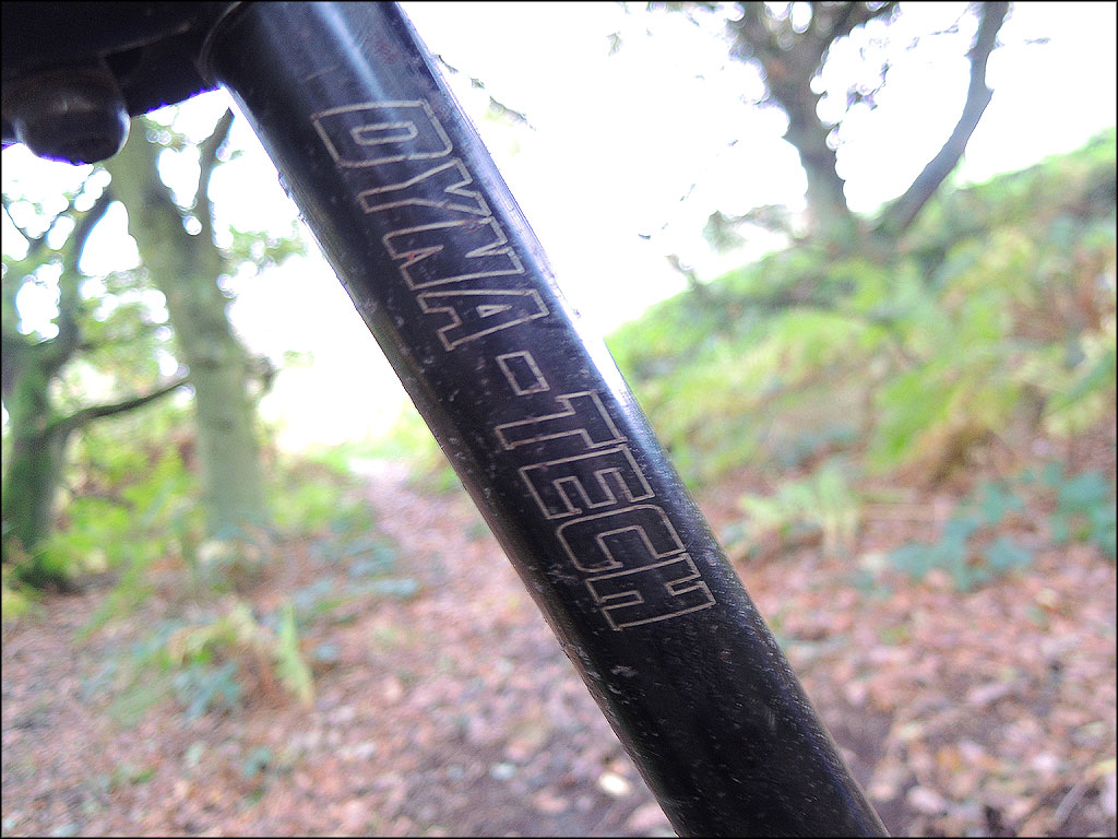

The frame of course uses the innovative thermally bonded tubes and lugs to construct it. The three main tubes are rolled and seam welded titanium with the distinctive design printed onto it. The lugs are cast aluminium with steel thread inserts in the BB shell.

1992 Raleigh Dyna Tech Titanium Diablo
Spinner cro-moly forks
Dia Compe SS-5 brake levers
Zoom Original cro-moly stem

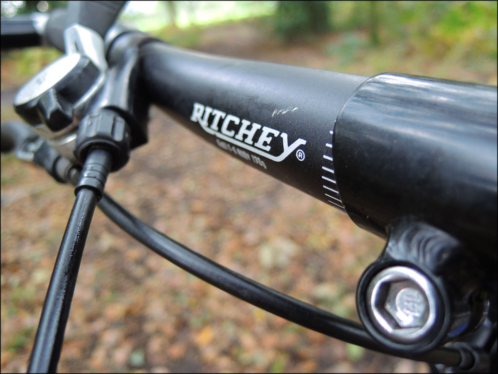

Ritchey bars to replace the damaged original titanium ones

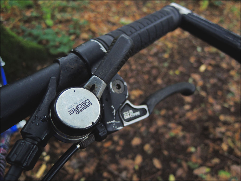

Shimano Deore MT-62 thumbshifters
Dia Compe 986 brakes with Aztec pads

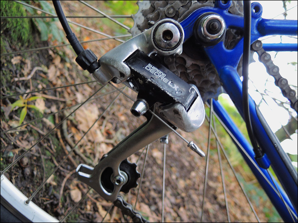

Shimano Deore LX M550 rear mech

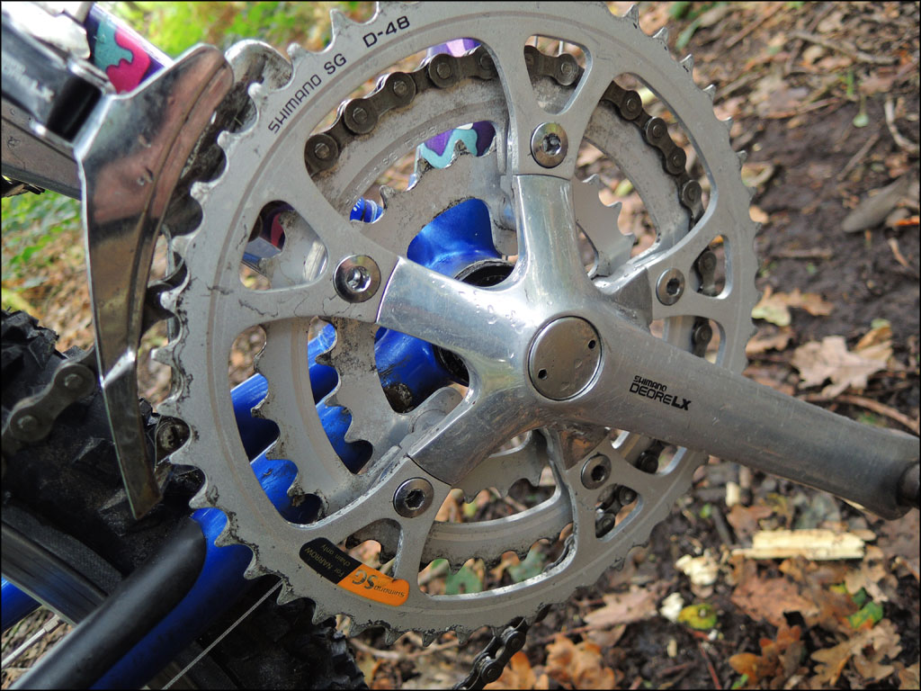

Shimano Deore LX M550 front mech and chainset

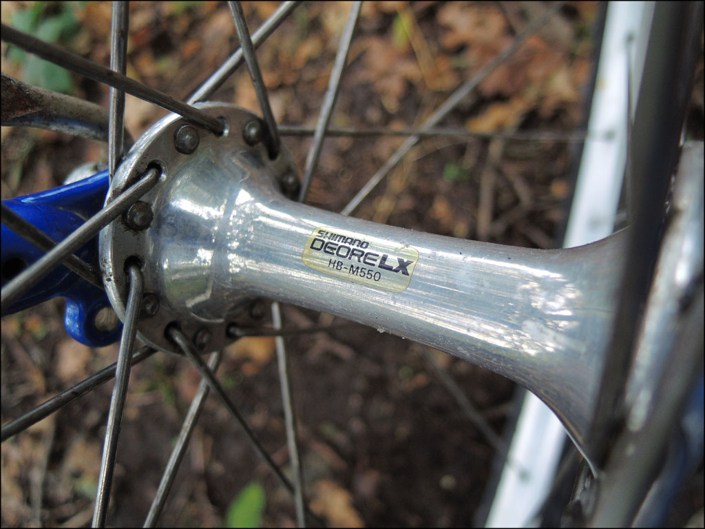

Shimano Deore LX M550 front and rear hubs

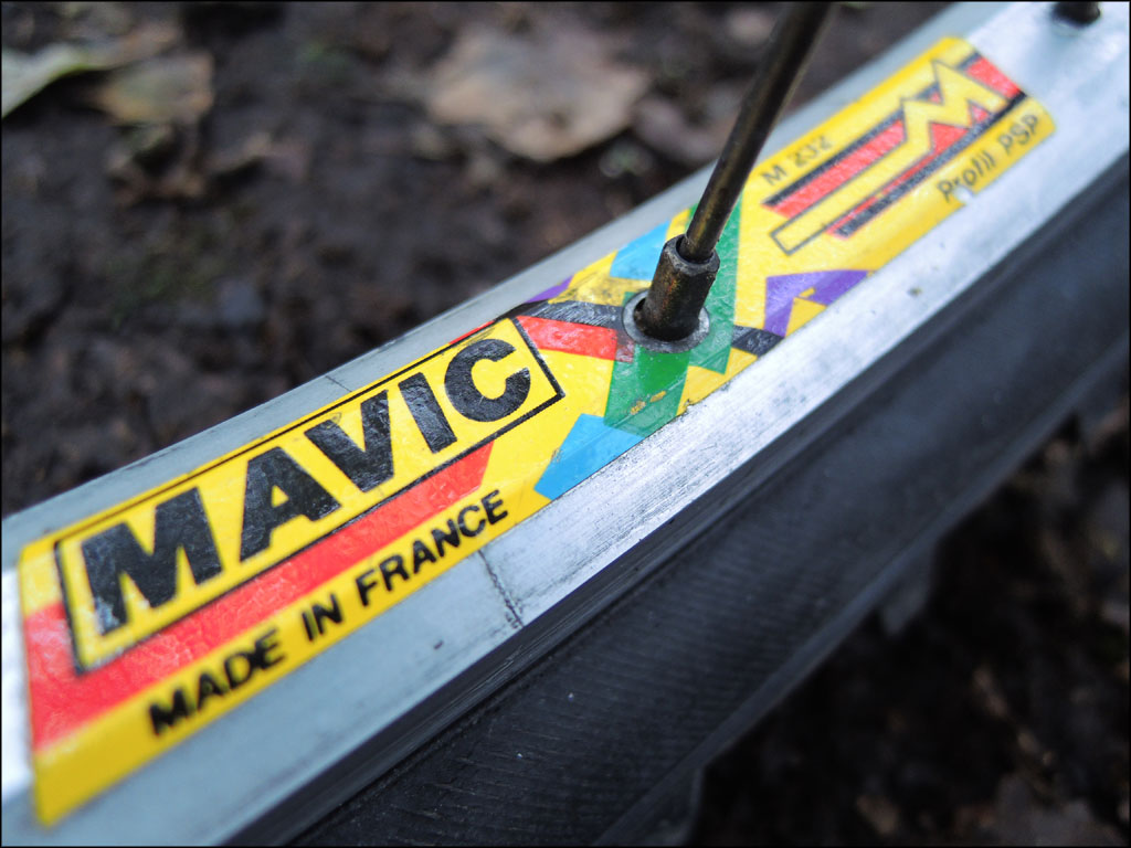

Mavic M232 rims - these were OEM rims which have no spoke eyelets unlike the closest equivalent M231 rims.
Dyna Tech 26.4mm cro-moly seatpost - Velo titanium saddle fitted
