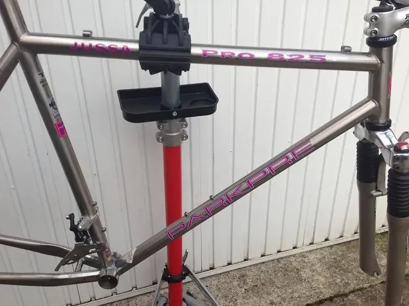

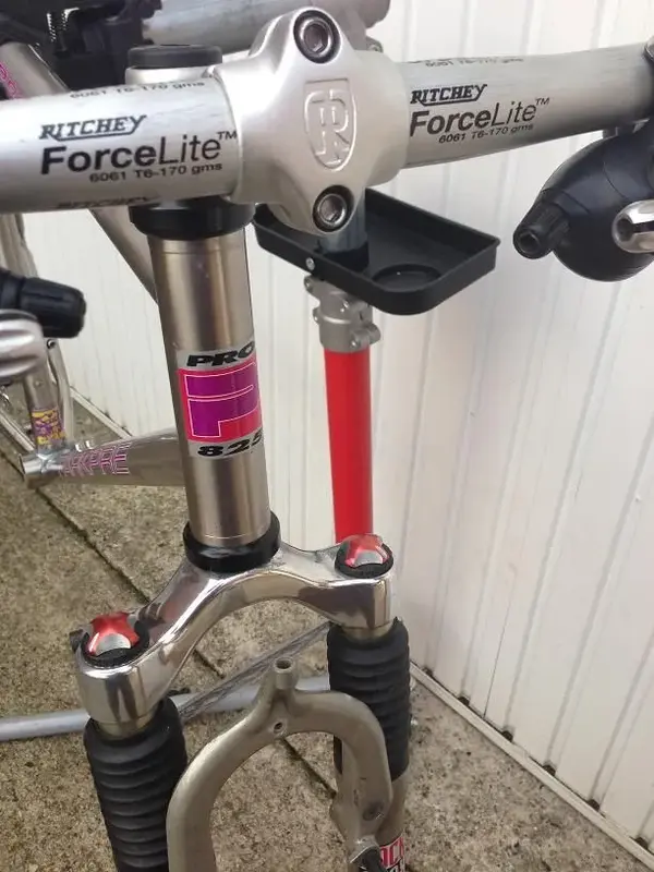

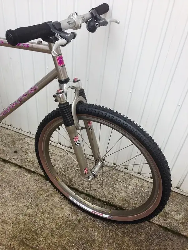

This frame was Karma'd to me a while back with a box of goodies from 'letmetalktomark'. It's been a very slow build as everything 'Orange' has been drawing my attention. Anyway this weekend I decided that now my Dynatech has been moved on to another RB'er I would start working on its replacement.

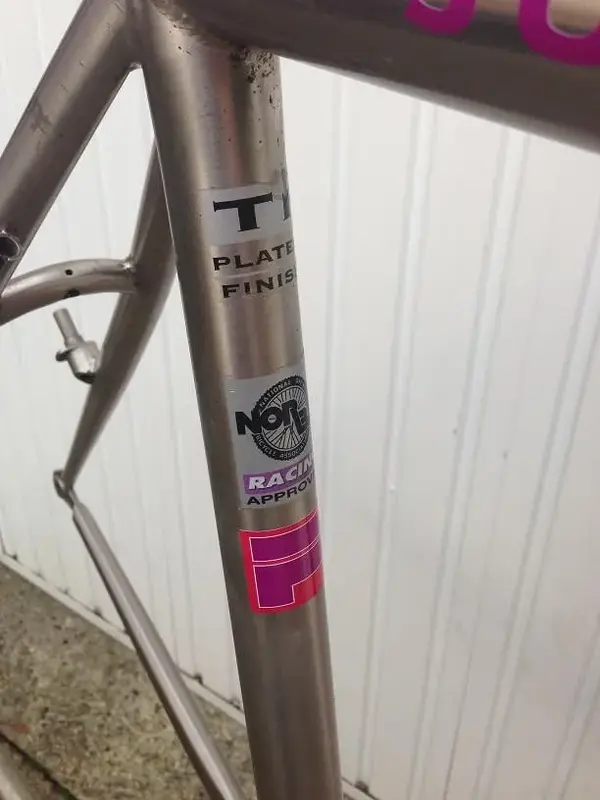

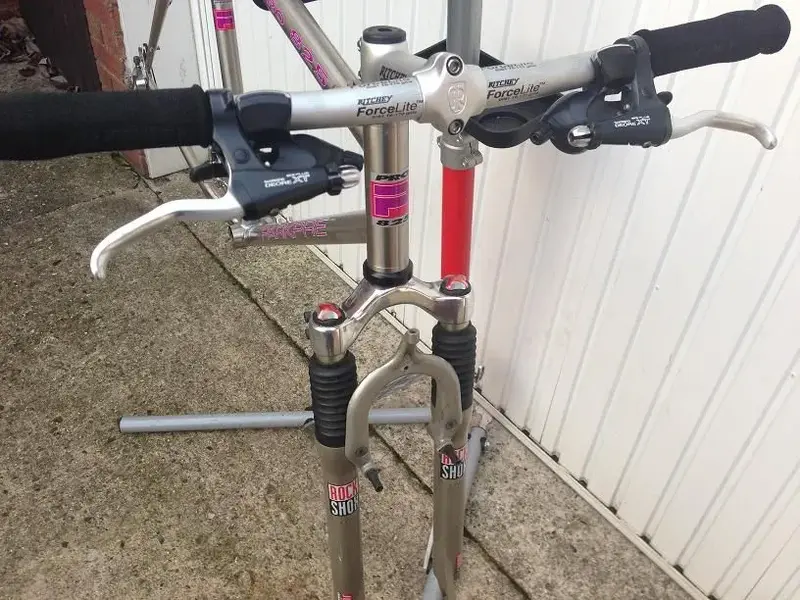

Frame is made from Tange double butted Superlight tubing. It has a great Ti finish which is pretty much in-tact apart from a few areas where frame has sustained cable rub etc. Original plan was to get the frame powdercoated, but i kept looking at it and thought I like it as it is, so frame was cleaned up and some new Graphics from Gil_m were sorted and replaced where necessary. Ritchey headset was purchased from CRC and after sourcing a longer steerer the Rock Shox Judy XC forks were mated to the frame. Ritchey Stem and Bars fitted along with Shimano XT737 combined Shifters/Levers. Ritchey foam grips finish the flight deck of this build. XT737 Front and Rear Mechs fitted to frame. Thankfully i've been hoarding some parts in the Man Cave so the outlay for this build has been minimal. With the Man Cave being a bit thin on 8sp wheel sets I may have to go with a set of Vuelta Champagne Rims on Shimano STX RC 8sp Hubs, just until I can source something more suitable. Seatpost & Canti's are next to be sourced.

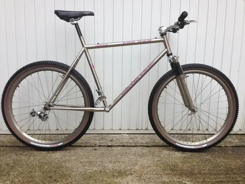

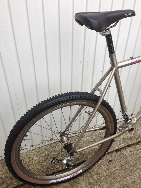

Wheels now clad with some rubber (Charge Splashback) and looking pretty good. I was dubious about the wheels but considering they are the only 8 speed I have in the Man Cave at the moment the Champagne finish of the Vuleta Airline rims compliments the frame and forks. Ritchey saddle and Bontrager seatpost in-place but looking for a 31.8 clamp in black. Not sure if I will keep the seatpost, or change for a silver one?

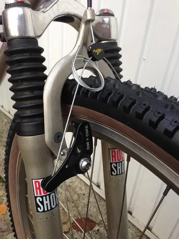

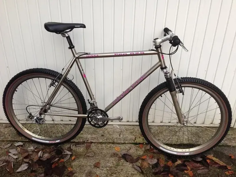

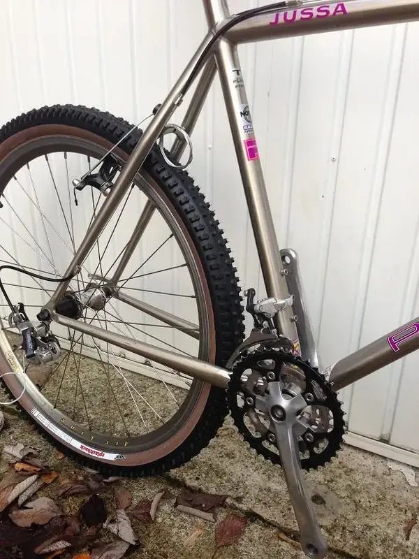

Ok, first of all my apologies for my absence, sadly work getting in the way of play and when HRH is your boss you do as you are told........Anyway took the opportunity today to carry on with the Pre. Photos pretty much explain it all but the additions are;
On-One Black Canti Brakes
ONZA Chill Pills (Canti Cable Straddles)
Shimano LX Chainset
Salsa Seatclamp
Rear Cable Guide*

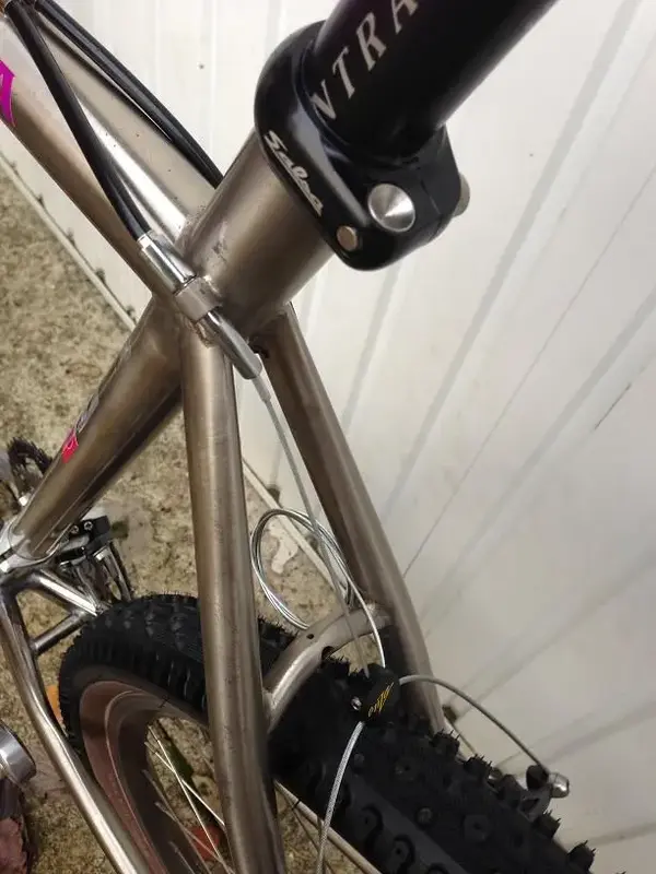

*The rear cable guide is pretty unique and getting hold of an original Park-Pre guide is like scooping a giant lottery win. So enter a Yamaha Motorcycle cable guide which was threaded at one end but cut down as part of the modification into a Canti Cable guide. Big thanks to our own Parkpre Guru Rekiborter who pointed me in the right direction on this dillemah :D
