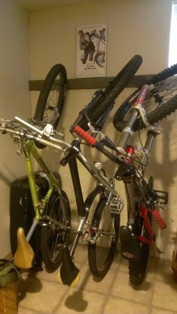

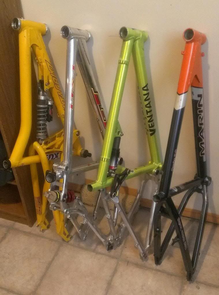

Left to right: '03 Santa Cruz Bullit, '97 Ventana Marble Peak, '97 GT LTS, '00 Marin Quake 7.0
After some random internet searching, I came across retrobike and instantly fell in love with the idea of building the high-zoot rig that I could never afford in junior high/high school.

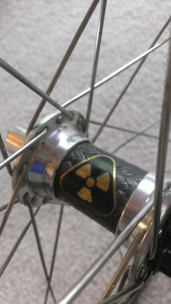

OG Nukeproof
Mish-mash of parts and uglier than a mud fence.

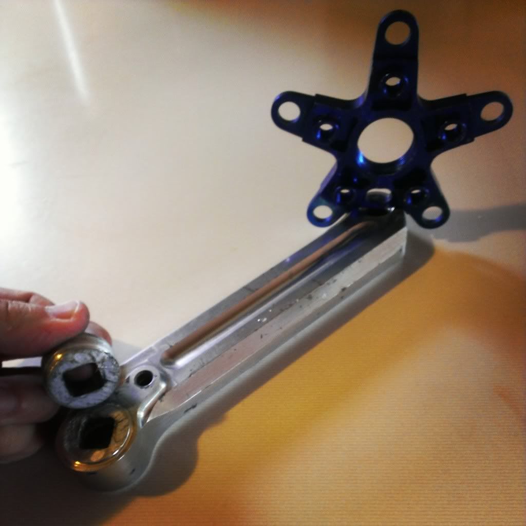

Caramba Double Barrels. Snapped like an old pretzel on the first ride because I didn't tighten the spider bolt. Live and learn...
V2.1 build. Busted Caramabas were replaced with some 5-arm LX bits. In compact drive too... Barf. The Precision Billet derailleur hadn't showed up.

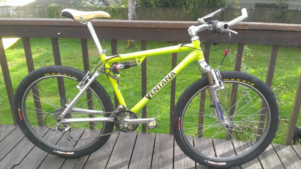

Current state of affairs:
Current issues:
-The 112 mm spindle is spaced for a 68mm shell width. The cranks just barely tighten up and there is no chain line adjustment. Not an ideal situation.
-The Precision Billet derailleur is partly anodized red. I will be taking it apart to strip it in a later post.
-Maxxis Hookworms are HEAVY, weighing 1.2 kilos each. Ritchey Tom Slicks are on order. Should shave off a pound and a half.
I need a Rollamajig.
