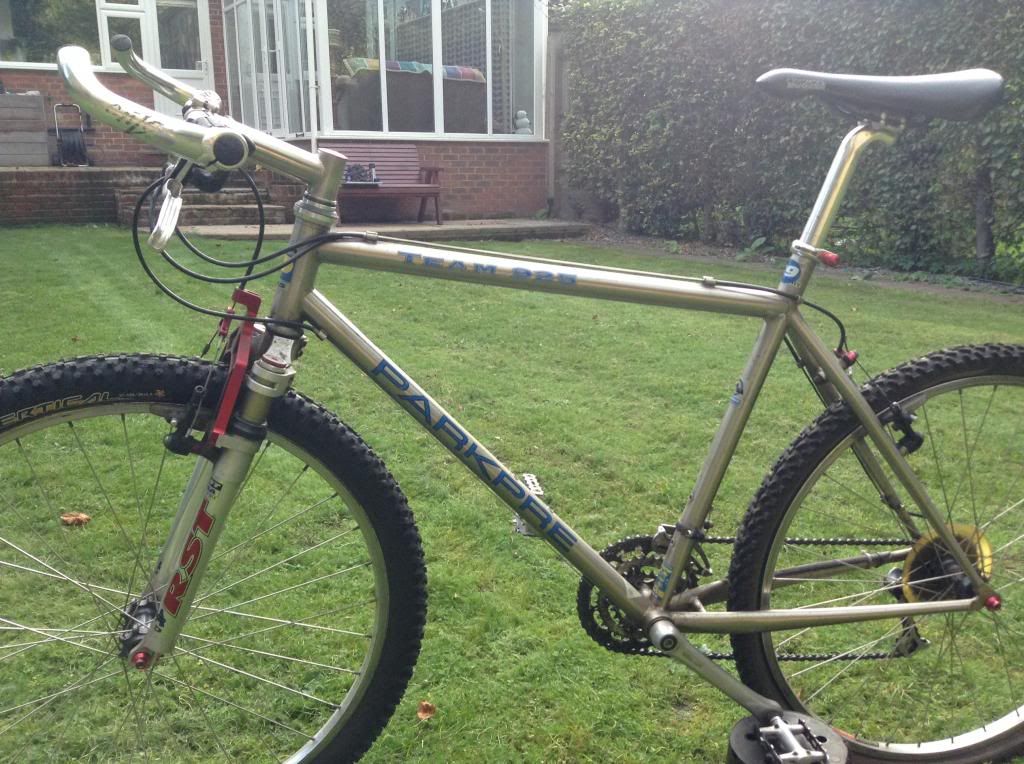

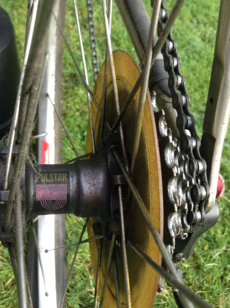

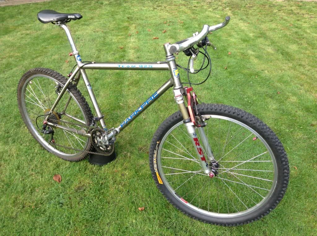

Full Shimano LX group set, PFR seat, RST MOZO Pro W shocks (that will be another tread) Pulstar hubs original wheels. Now gotta decide what to do with her? Its a steel frame that has been titanium plated, however it has surface rust spots all over it, so I'm now thinking about stripping the frame & going for the polished look, with obviously a new set of decals. Should make for an interesting build & will fit nicely into the 'stable' with my Parkpre Comp Limited.

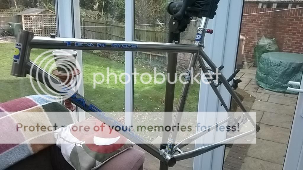

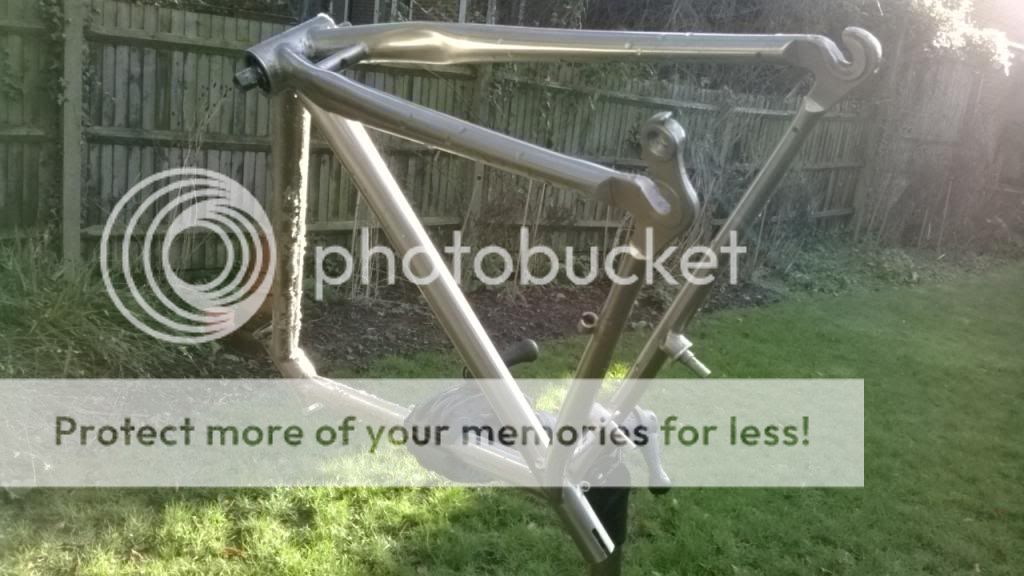

Right this one has been close to 9 months sitting in my shed, so today I decided to get started on it......

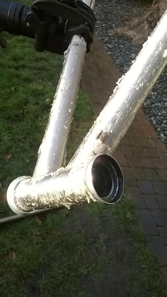

I striped the bike leaving the a-head set cups & the bottom bracket then I got out the paint stripper.......

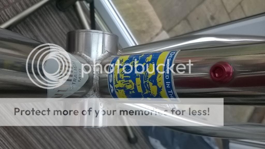

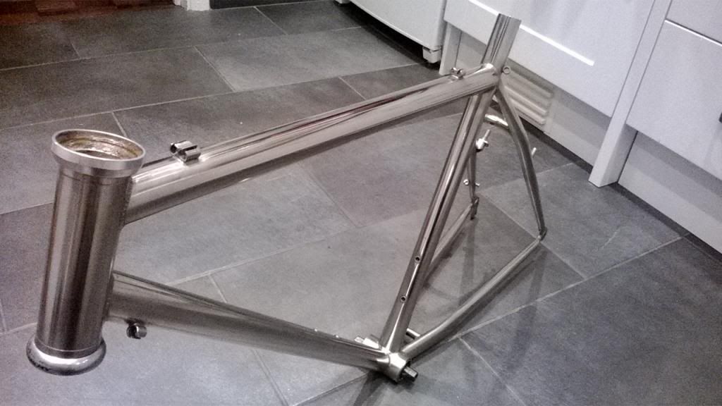

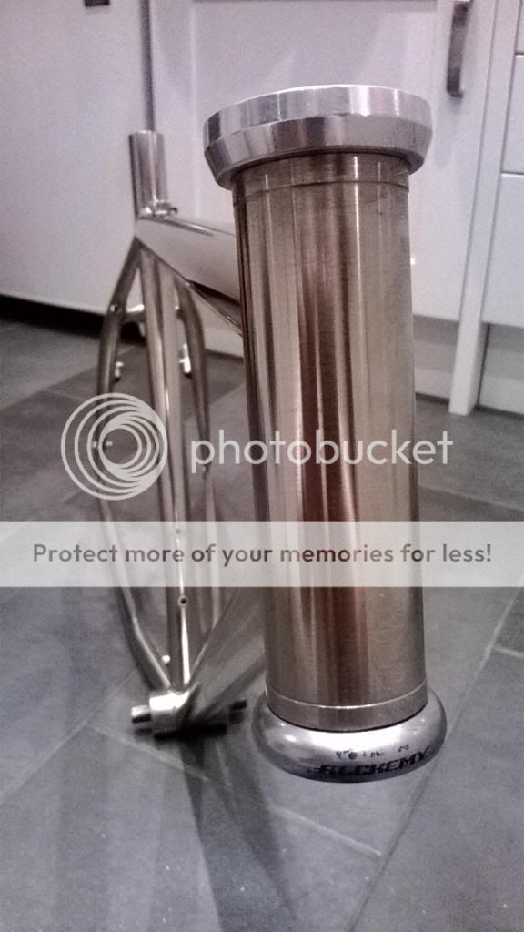

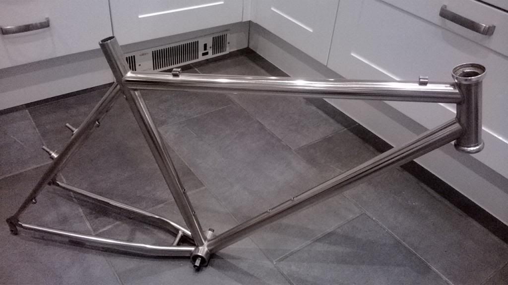

After washing it down & drying it off, I then got out the metal polish.....

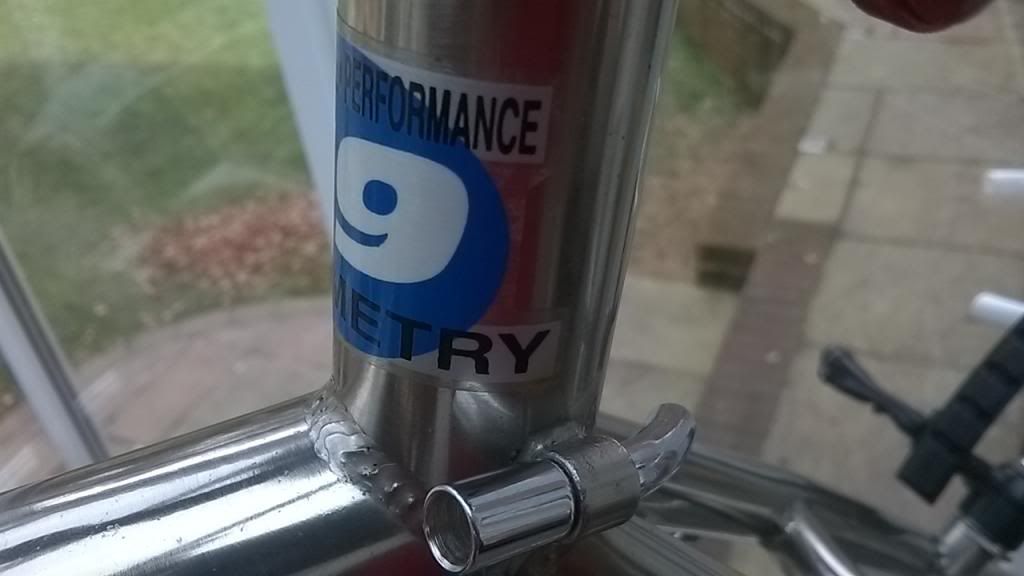

I did like the TI finish but there were too many surface rust spots for my liking, so this was the way to go. Already have the stickers from Gil.m so I guess they will be going on next before I think I will have to give it a coat of clear. Not sure whether to do this myself (rattle can) or pay for it to be done by a sprayer......how hard can it be..........!!!!

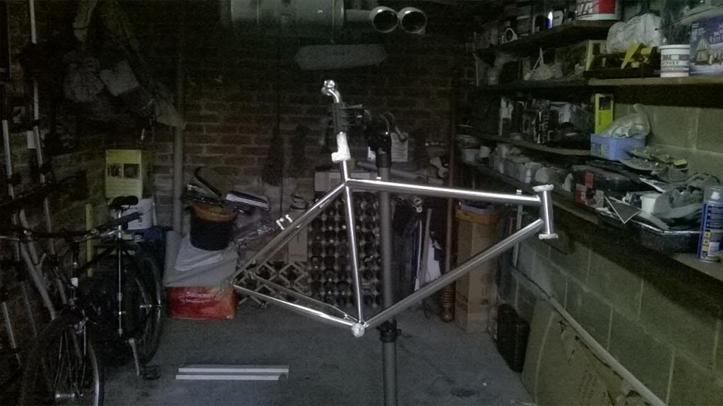

Got the rattle can lacquer out today, 3 coats with 24 hours to harden, fingers crossed

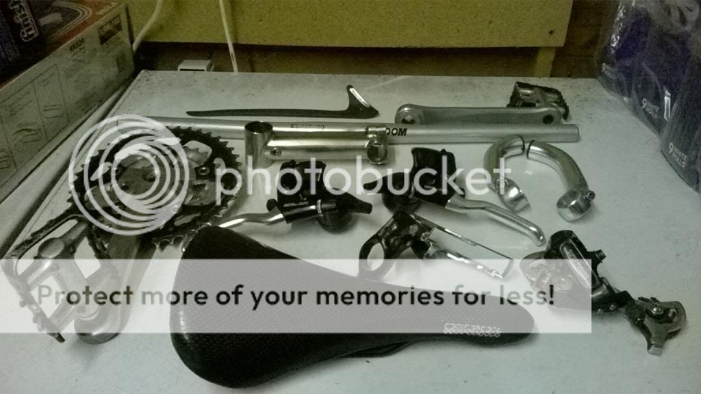

Then started to clean up some of the LX components
I think I might just keep the red anno parts, they are beginning to grow on me, progress is defiantly being made.....

Nice job with the strip and polish!!! looks really good!

Ok, so after trying the Halfords rattle can lacquer idea, let the frame cure for a week, I went to apply the decals & as it tried to attach the decals to the bike they peeled off all the lacquer I had applied the week before.
So, strip down number 2, this time I went clear powder coat (£20) & that was £20 very well spent, great job & a lot tougher than my lacquer attempt.

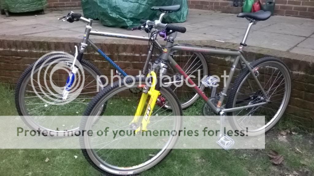

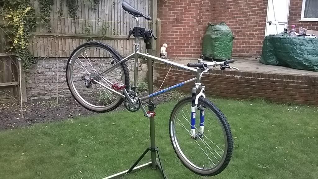

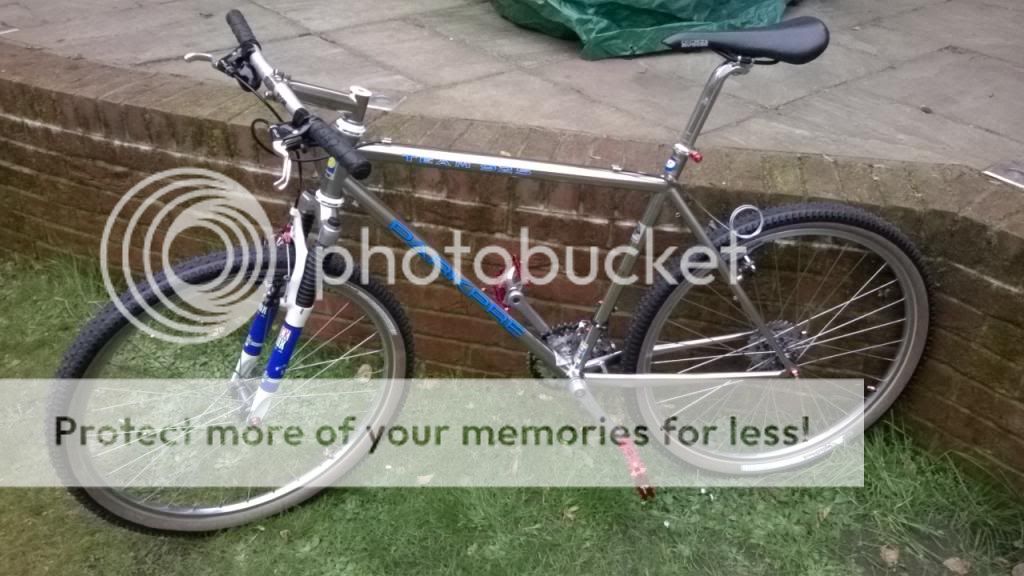

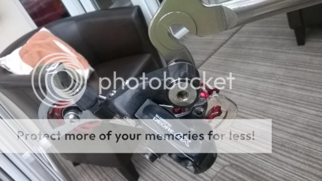

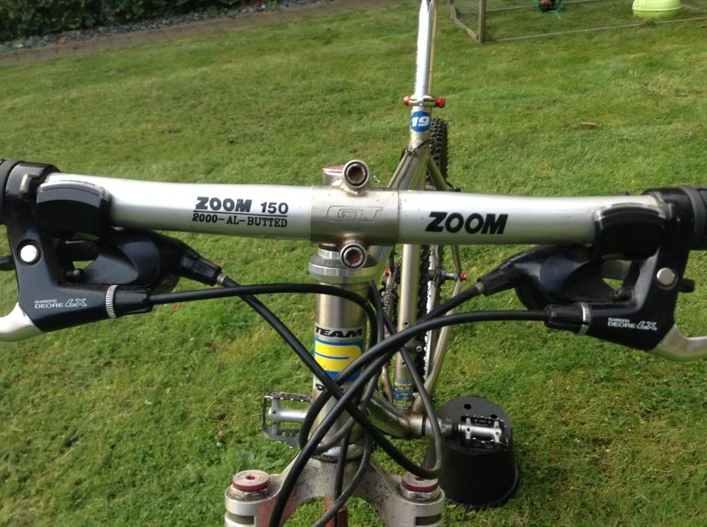

Progress has been made today, after buying a second hand set of Rock Shox Indy c forks & getting my local BS to put my new FSA Orbit headset & forks on for me I was able to get going with the build.....
and one with its stable mate, my Parkpre Comp Limited....
I decided not to go with onza bar ends, I think I prefer the cleaner lines with out them. I know REKIBorter got some stick recently for what some people thought were Charge Splash Backs on his Litespeed Parkpre Pro Elite. But I like them so they are unashamedly on my Team 925. The old system the bike had for the rear brake wont work for me now as I have a Parkpre brake noodle so I'll have to order a new red hanger for the rear before I can finish that off. After that a chain might help & then finally gears! Only bought this bike back in 2013 so not been the fastest of builds but hope you like how its turning out.

Lovely bikes, have both a Pro Elite and a Comp limited, the ride on both of them is inspiring, very much underrated frames and pretty rare.
