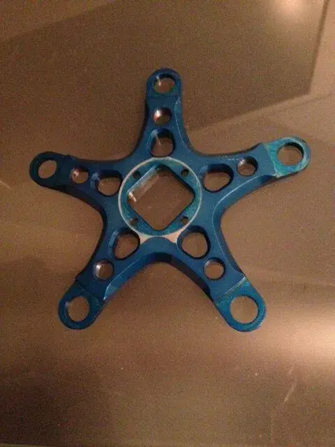

the classic middleburn creak used to be the spider against the driveside crank arm. fully strip the crank down, remove the spider, clean everything. then when you re-assemble use (non permanent) blue threadlock for the spider/ crank interface.
PostPosted: Sat Oct 05, 2013 8:51 pm
Joined: Tue Dec 01, 2009 10:24 pm
Posts: 295
That's a top shout - and it was something I'd been considering when I saw how the crank had worn the anodizing on the spider like this.

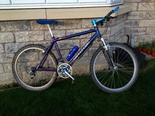

As the chainset is now so clean, I couldn't resist taking some gratuitous pics ! Might get round to giving the old girl a proper clean,
