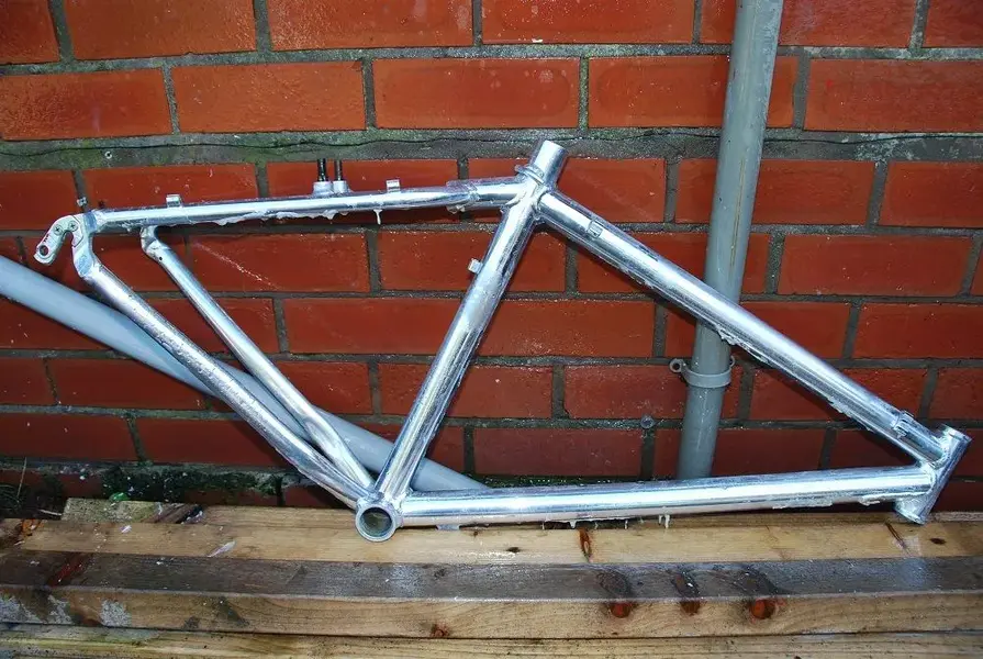

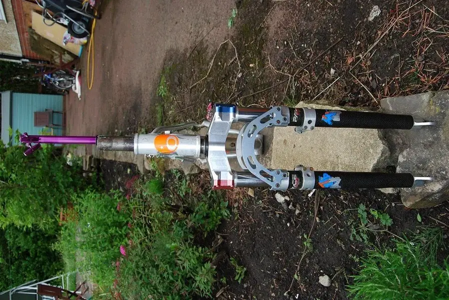

Here is my Orange E3 retro build thread.
I bought the frame/forks/seat post on Ebay locally and consisted of the frame, a 1996 E3 - A0601, a pair of Pace RC35 MCXD’s and a purple USE seatpost and shim. I think the £115 I paid was reasonable. It was a buy it now sale and I’ve seen the forks alone go for £60+. See pics
The frame looked virtually white and the seatpost was missing the lower part of the clamp, so I contacted USE who couldn’t provide a purple one, so I settled for blue. I do have a thing about having blue trim on my bikes, but blue and purple, well we’ll see…

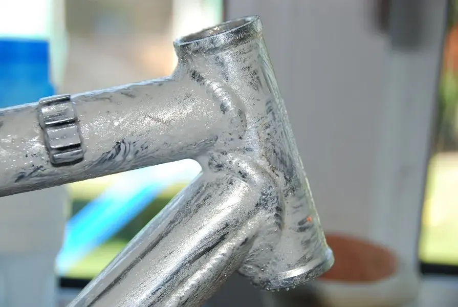

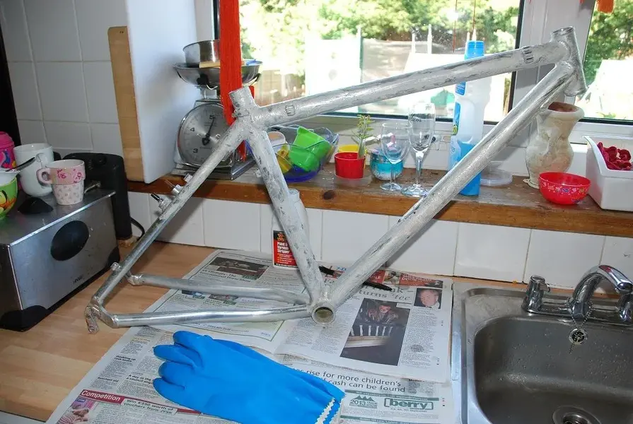

Interlude 1: Stripping the decals and lacquer and cleaned up the frame with used scotchbrite and a bit of fine steel wool where necessary.

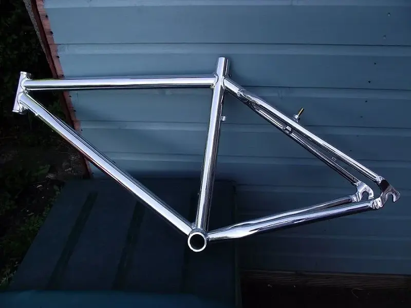

Interlude 2: Polishing the frame with Mothers Mag and Aluminum Polish.

I stripped the RC35’s down and used swarfega to clean out all the old grease and crud. Found a tub of Pace grease from the deal I did which got me a pair of RC36 Evo’s and found a “PUCH” metal tag inside it! Re-greased the elastomers and internal hardware. When tested they seem to be okay and will be fine until I can get a Judy springs upgrade. But one thing at a time…

Pics of bike when bought:

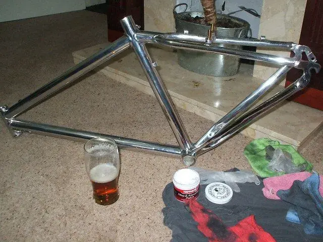

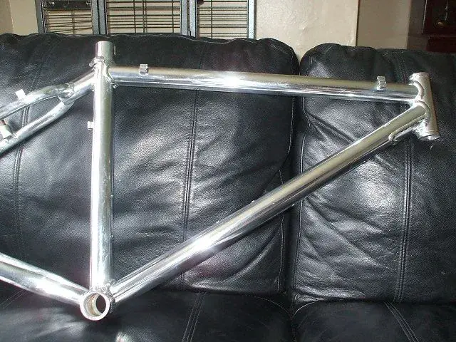

Polishing sessions.
Looking good, but still a long way to go...

2nd update.

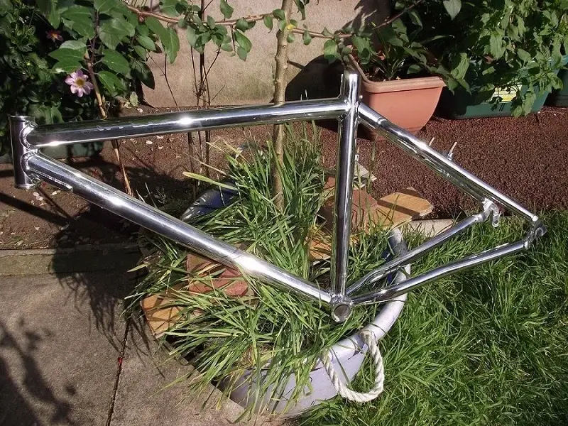

The "base" level of polish is complete. Now I need to finish the drop outs and black polish residue and it's done. I will have to curtail my need to get the frame perfect and remember that after all the frame is 17 years old. I must say the frame looks a lot better in a pic than close up...
Se the pics below. The 2 by the shed are in the shade with and without flash.
Thanks to the suggestion of stewlewis and My_Teenage_Self about the shoelace method. I got some thick flat white bootlaces and they worked a treat.
Do we have a permanent thread were useful ideas could be collected?

what was the process/products you used to strip lacquer off with? Just purchased a similar project. Damn you!!!!
PostPosted: Mon Mar 10, 2014 11:21 am
Joined: Mon Aug 19, 2013 9:02 pm
Posts: 304
Location: Lancashire
I got some Ever Build X3 triple strength paint and varnish stripper from my local hardware shop. About 5 quid for a tub. It worked a treat. All I did was follow the instructions on the container, using a paintbrush to apply the stripper to the frame, especially the nooks and crannies. You can see the old lacquer bubbling as the stripper starts to work. Then I hosed off the frame when completed. I just wish I hadn't taken off the foil tube spec decal and that I didn't use scotchbrite to remove the excess stripper that wouldn't hose off. I think a cheapo sponge would have done the job just as well and not left scratches on the frame.
