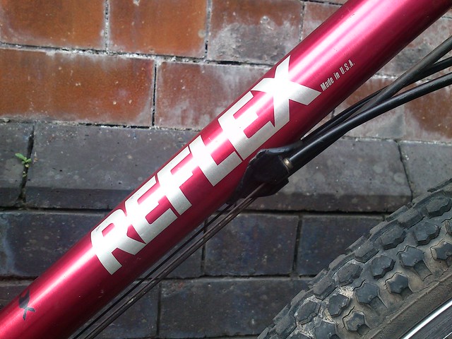

The anodized logos and patterns are particularly swanky

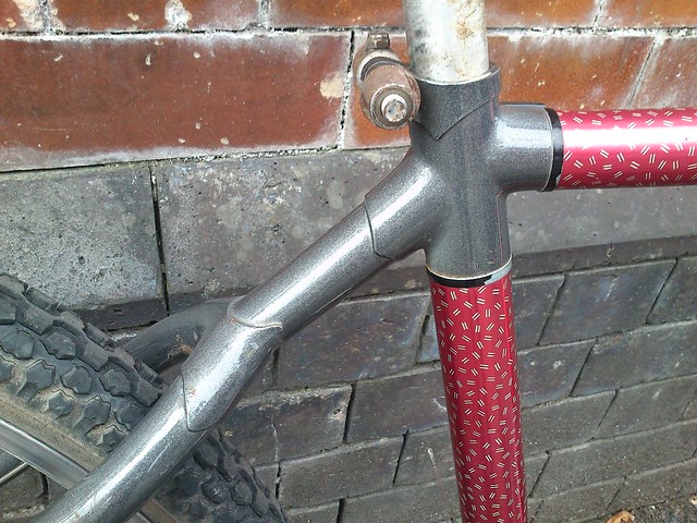

The frame has Easton E9 aluminium main tubes, bonded to steel, but it still feels quite heavy. I'm not sure what kind of steel they used, but you can really feel it when you lift it - all the weight is at the back, and the overall weight doesn't feel any lighter than a steel frame to me.

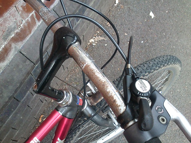

The groupset on the bike appears to be original, and is mostly in pretty good condition. I haven't had a close look at the part numbers, but I think it's all MT60 or MT61. I suspect that the steel handlebar isn't original, as it seems like a really weird part choice compared to the other components. The stem is a Sakae in ropey condition, and the wheels have Maillard hubs (dated as 1988) and Araya RM-25 rims.

Once off the train, I found a quiet spot and swapped the handlebar for a Kalloy Uno bar that's 2 inches narrower (the old one was enormous!), and about a third of the weight. I neglected to refit the bar ends, as they're a bit crummy, and it looks like the LH brake lever might be a bit broken. I need to have a closer look at it, as it may just be the adjustment screw that's knackered.
I had hoped to swap the stem for something longer with less rise, but it's a 1" stem, and I've only got 1 1/8" stems knocking about. From the feel of things, a longer stem will sort the bike out nicely!
