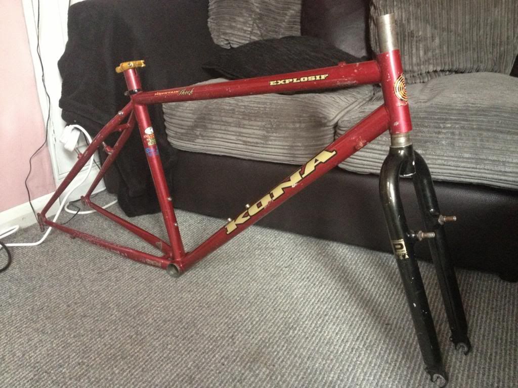

Been after a decent old steel Kona for a while now, got chatting with Rojo and he had this little beast in his treasure trove... So after a swift drive down the West Country yesterday (5 hour round trip!) I now have it in my living room

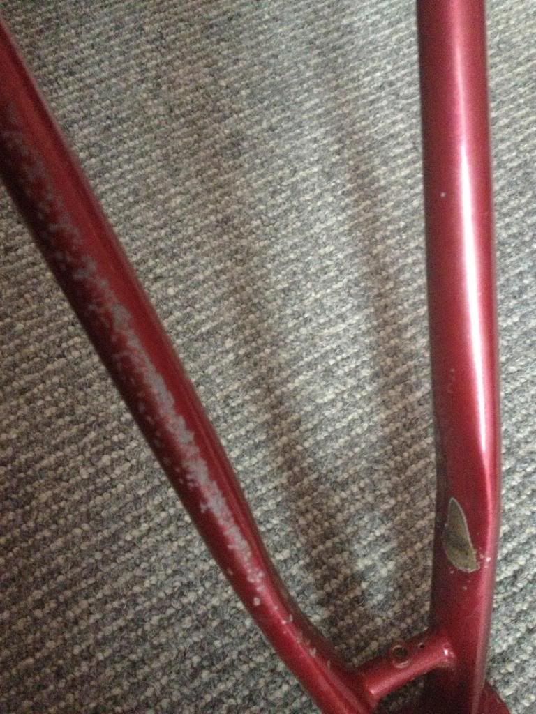

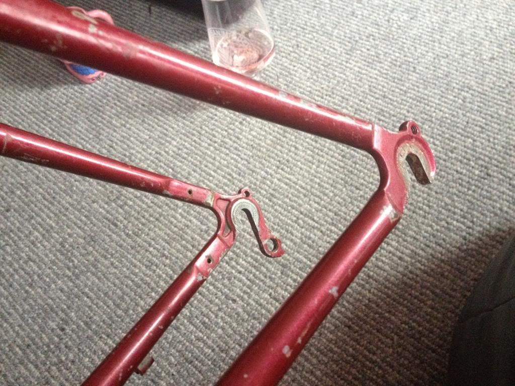

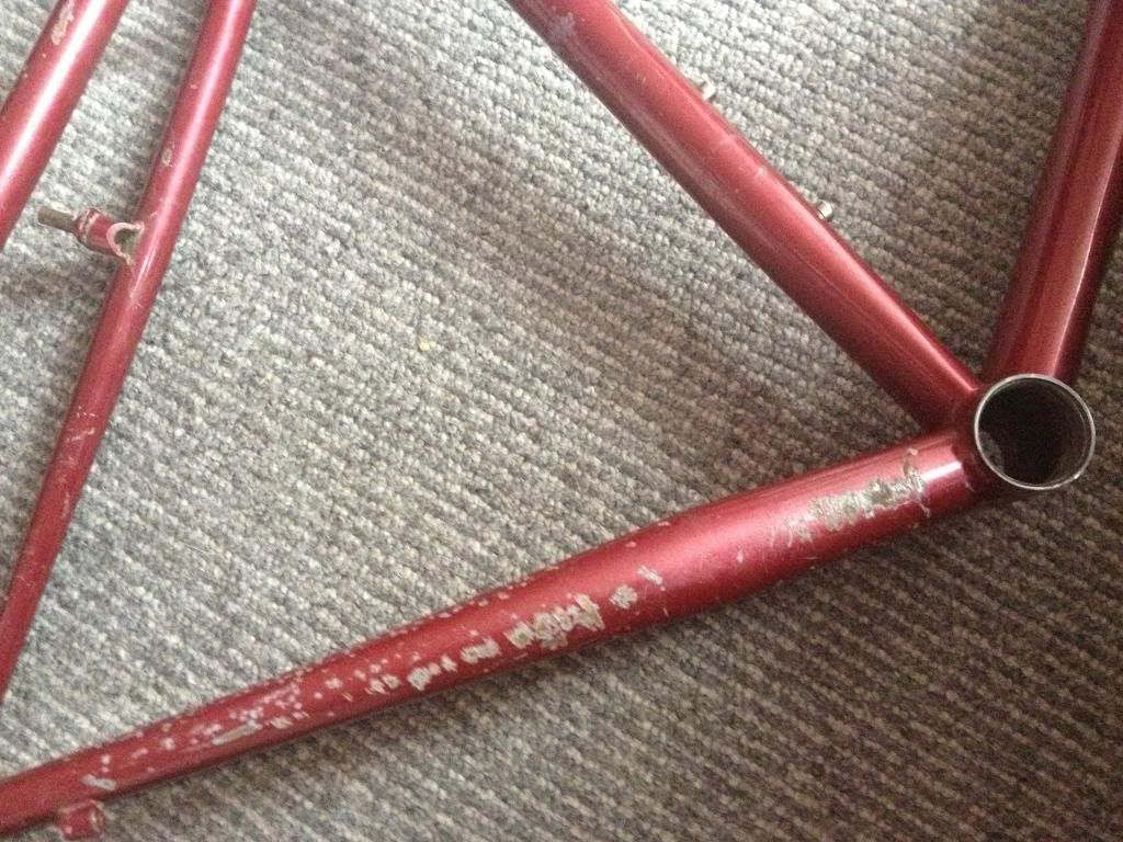

The plan is to build a single speed rigid bike with good kit and kept quite light... So far all I have is some cannondale p-bones up front which arrived this morning, I'm getting a doner bike in a couple of weeks so the build will start then, one question.. Shall I leave it in its original state or get it re-sprayed?! I have new decals ready but Im not sure I want to lose the original paint ... I gues the paint is 5 out of 10 condition, plenty of chips and scrapes and lots of cable rub/tyre rub and generally quite scruffy :-( I do have a touch up pen though...

I'd say keep the paint. A good clean, t-cut or similar then a polish will probably make a hell of a difference. Wrap the drive side chainstay to hide the paint damage and protect from further chain slap. The decals look pretty good from your pics and the 95 is a nice colour so it would seem a bit of a shame to repaint.

No respray will ever equal the quality of what you've got. I wouldn't T-cut it too much, you just need to clean it really, not remove the surface. Also the usual formula - 1. remove any surface rust with a fine craft file, 2. seal all bare metal with Kurust, which will stabilise any remaining bits of brown, 3. touch in with a reasonably close colour, darker better than lighter, gloss modelling paint the best vfm. Once you've done that and polished it, if you stare at it from a metre away, you will see all the repairs. But as a built-up bike out on the trail, nobody will notice them.
The correct length P2 fork is 41cm long from where the crown race sits to the centre of the axle. I may well be wrong, but the one you have looks a bit like an earlier 39cm fork.

those cannondale forks look chunky! not seen them on a kona build before. keep the paint as it is bud-shows its been well ridden/loved :)
