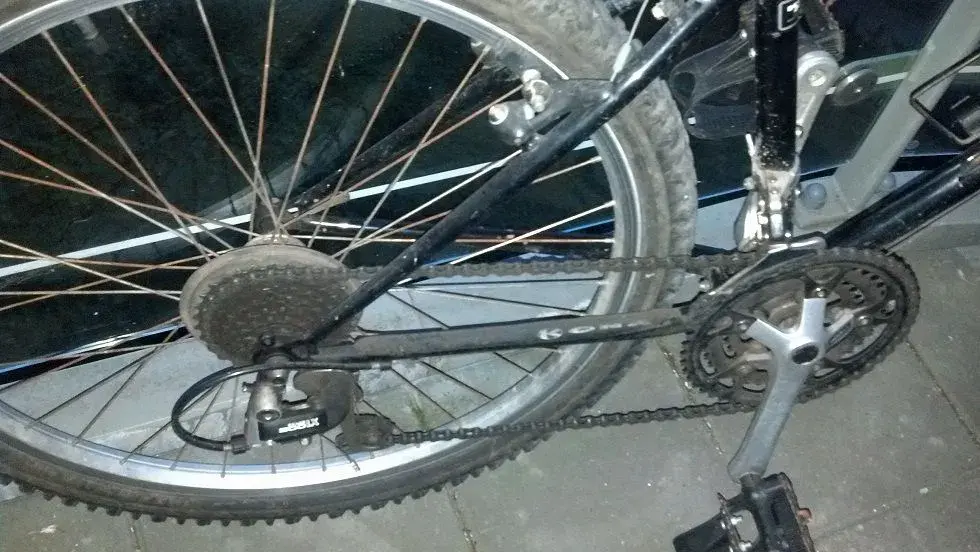

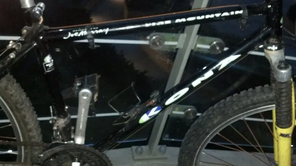

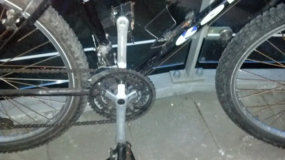

I picked up this Kona Fire Mountain on Ebay this week, I think it might be 93? The spec might indicate that year, although I think it might have come with threaded P2 forks originally. Does anyone know what exact forks these are? I think they may be 199- Judy? There have been other changes to the original bits as well, I don't think this bike came with Araya wheels, the front cali has been replaced with v-brake, the rear shifter is different, and there is an ahead stem with different bars.
Any advice on where I should go on this? Is it worth caring about keeping it original as some of it has been changed, or should I source some nice bits to bring it back to life, the levers and shifers have seen better days.
Sorry for poor pics, no space, too dark! Thanks for looking.

It's a 1992 model, 1993 had the dual colour fade schema. You could have it in lime green or stealth black...to make it look like an Explosif perhaps ;-)
That does look like a Judy, probably from 1996/7 as it hasn't got a canti-brace. I can't tell from the pic's but as they've fitted a v-brake to the front, did they also change the lever? If not you'll have some "fun" although I see they've fitted a converter on the v as well.

ahhh your right! It is a 92, so the Araya wheels are original, thanks for informing me :) Yep, lots of scrubbing to do. I think I might get some threaded P2's and the velocity stem on it and offload the Shox. Levers are original, just the front v-brake has changed. Tempted to go full original, we'll see!
