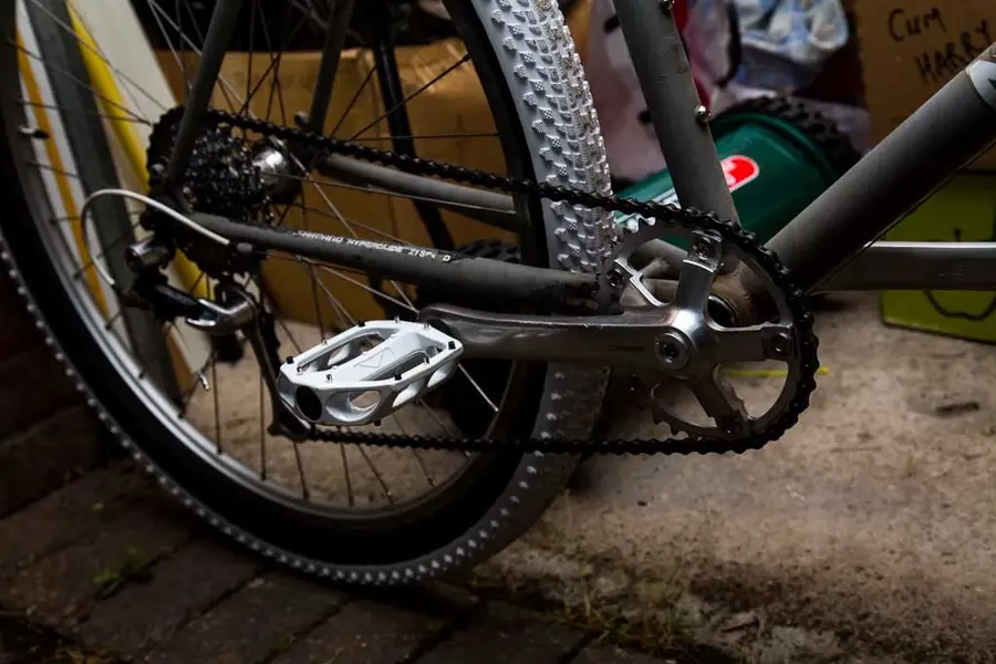

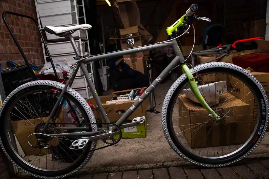

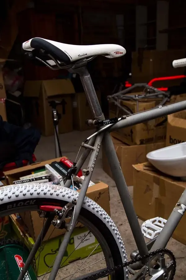

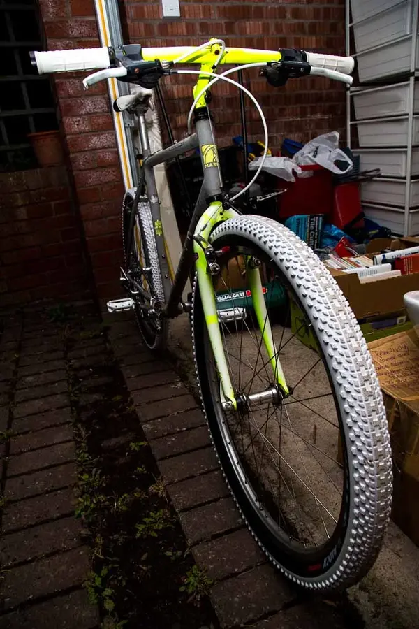

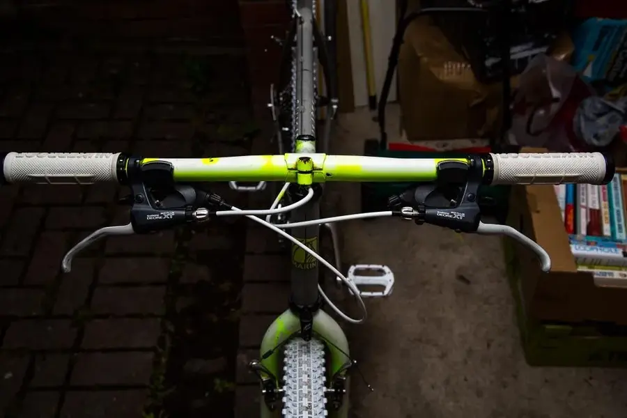

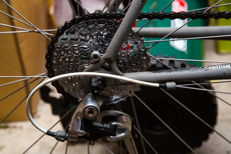

So, this is my first project. I joined probably about 6 weeks ago after being inspired by a friend's raleigh burners while helping them move house. I don't remember what led me to zolatone Marins initially but I was in love with them in the 90s and now I have one, I'm just stoked. Check out the below for the 'before' shot.
http://www.retrobike.co.uk/forum/viewto ... p;t=260352
The learning process began, my initial thought was to make it a single speed, then a 1x7/8, then the full 21/24 speed MTB with upgraded parts. I settled on a 1x8 hybrid type of urban commuter with a distinctive style and quality parts.
The strip down was done the same week as the purchase. It wasn't too difficult, the headset and BB were shot (had to weld several feet of rebar to the BB fixed side to get it undone!) but the frame was good. I began purchasing parts. I decided on XT as the bike came with an M739 rear mech. First came M730 crank arms (thanks trek_y) and then some M737/Mavic wheels with correct skewers from the bay. Then we decided to move house and I knew I had to get a move on or it would get packed up.
Next was a large order from CRC; BB, chain, headset, cassette, pedals, grips, clarks cable sets, self extracting crank bolts and some tools. Some M737 shifters and cantis (including kool stop salmons), a period incorrect Marin QR seat clamp, some Ti bolts, stronglight 34t chainring and bolts, NOS canti hangers from ebay. A flite in white thanks to Pace on here (awesome part). Tyres from a random online bike shop, they only just fit.
While this was on the way I set about cleaning and enquiring about having the frame, forks, stem and bars brought back to life. In the end due to cost and time constraints (and the fact it's only a Palisades) I decided to go with the original finish as I thought it looked cool cleaned up and I had seen some really cool rat builds on this site. Since it's a commuter/pub bike (not that i ever see the inside of a pub these days), perfect refinishing would have been very hard to keep pristine anyway.
So, after an evening of cleaning, dismantling, degreasing, repair, re-assembly and lubrication I was ready to build. At first i motored along; my first BB install 5 minutes, brakes, straight on. Then I got to the headset... I had the old threaded rod with washers home made tool, armed myself with copious research from the oracle (youtube) and set about the crown race first. Had a few goes of whacking it home with a length of plastic pipe, no joy. So I put the kettle on for the crown race and I shoved the forks in an old pop bottle full of iced water. Then I set about the cups. To cut a long story short, ISO headsets don't go into JIS framesets - i still have the wounds from wrestling with my (now broken) tool and frameset for over 90 minutes. Back to the drawing board...
So, I had a frantic search for a JIS headset. Massive thanks to Skeelsie for coming up with a NOS Richey logic, which was fitted in minutes just a few days later.
The rest of the build went without much of a hiccup. The chainring needed moving into the middle position after a couple of chain off incidents and a wheel that needed a 5mm buckle taking our which was done for only £5 by LBS. I think I did a good job, the bike rides like new and I love the look. I took inspiration from the original Marin decals and did everything in white. I'm sure there will be some who have some opinions on this but I bloody love it. See what you think.
