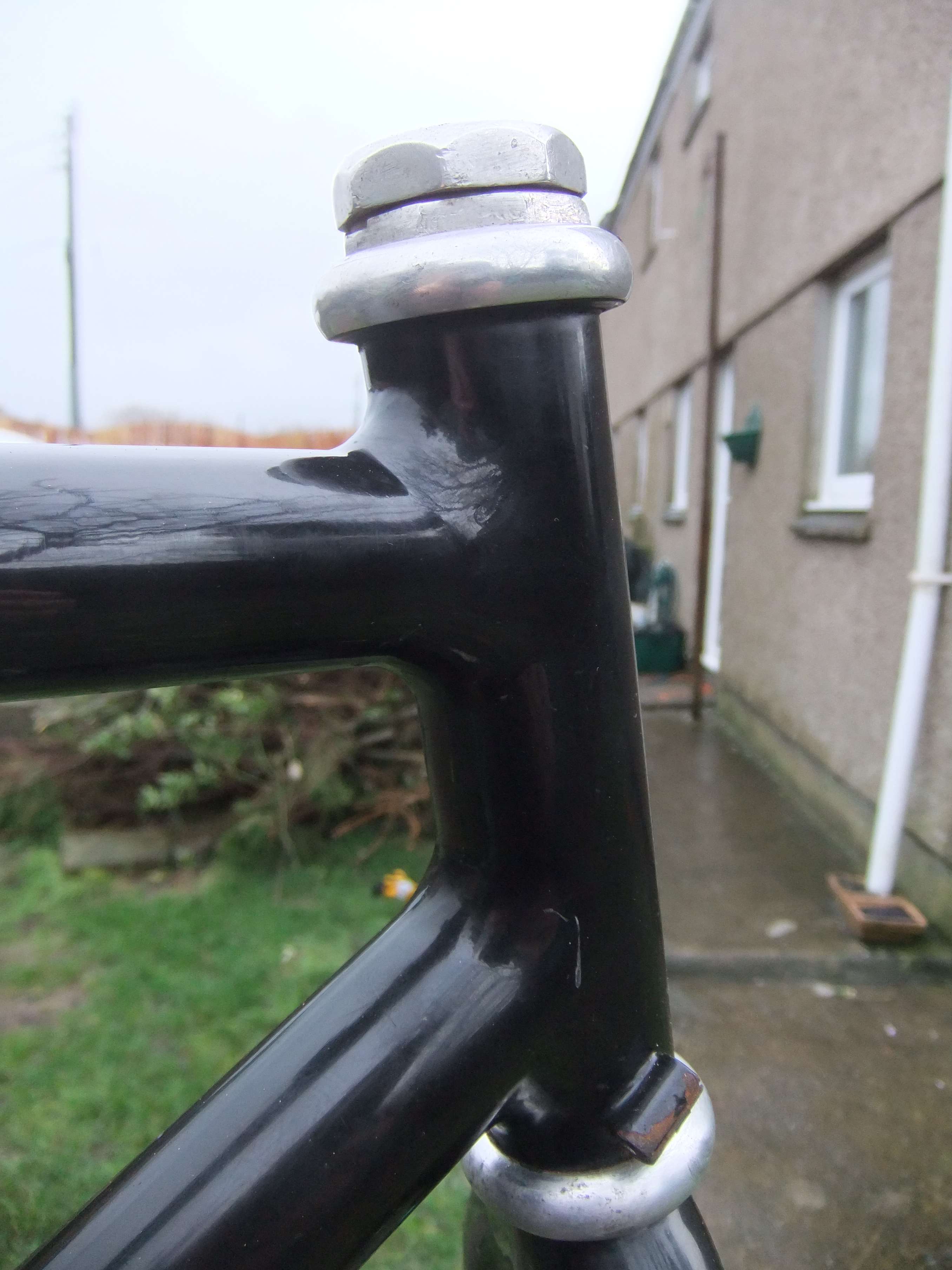

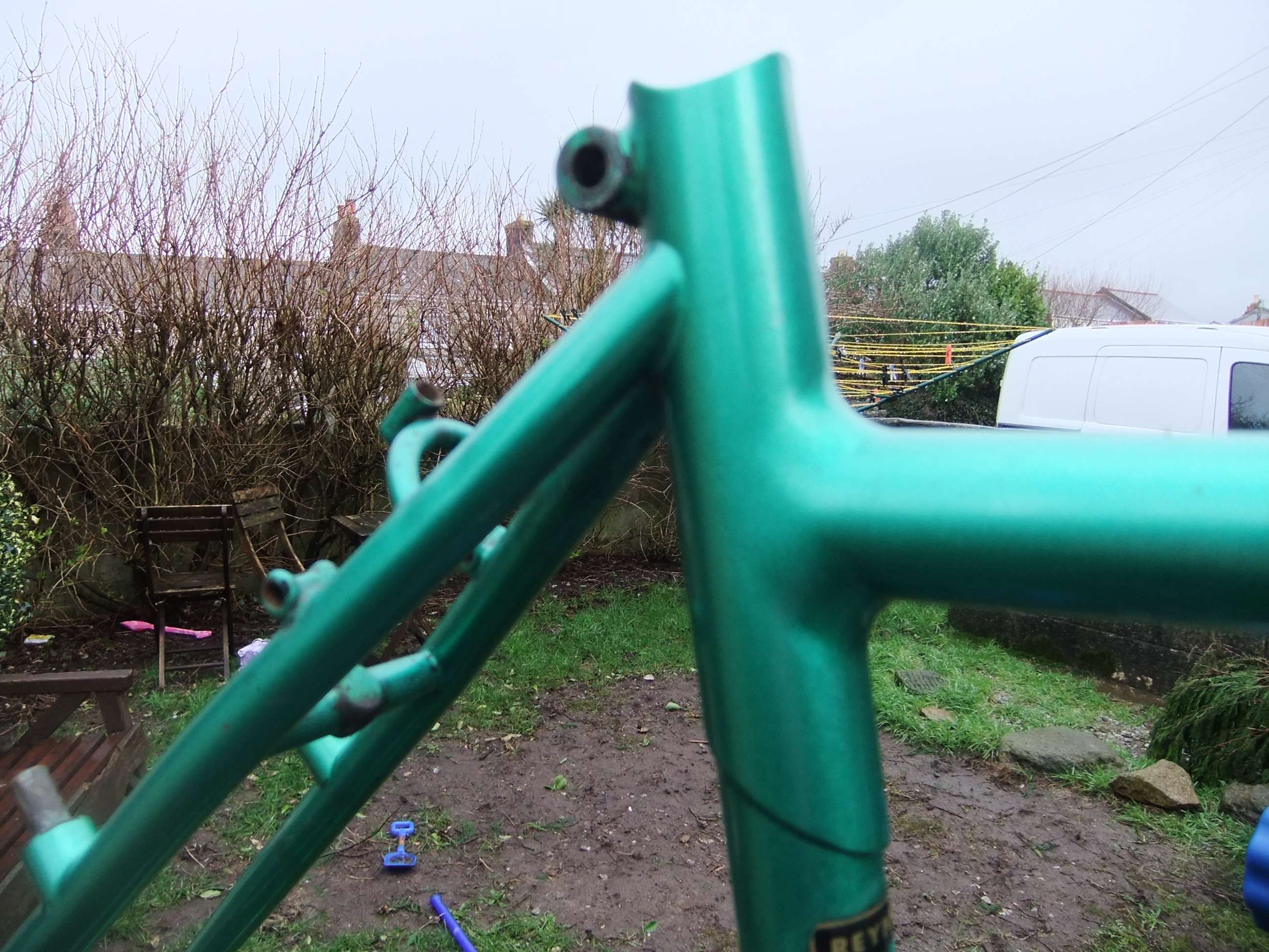

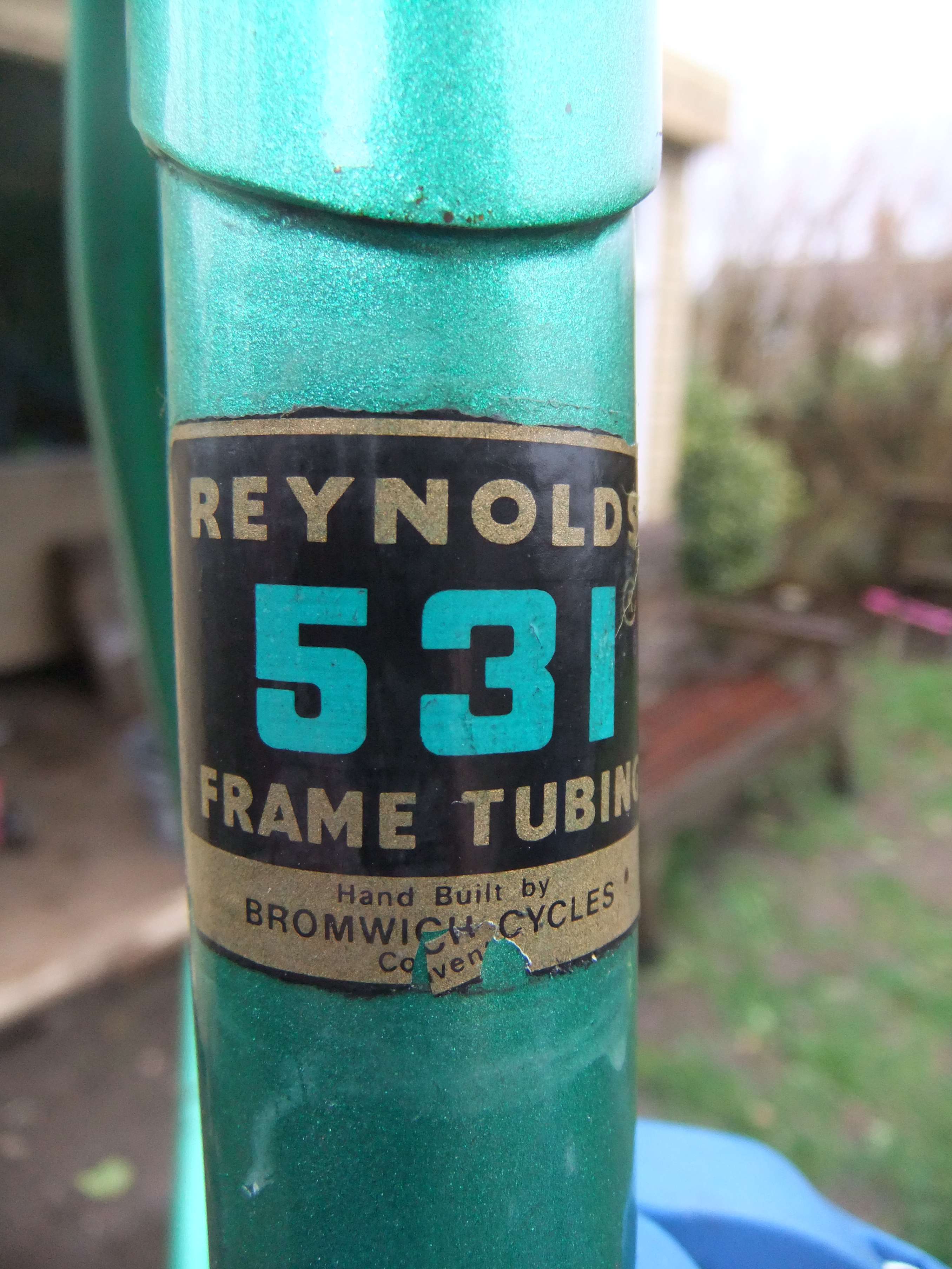

I bought this in January from a new forum member who purchased it 2nd hand around 1990. It was black and yellow when he bought it and had no decals. He had it resprayed by Bromwich Cycles where early original Overbury's decals and a Bromwich 531 decal were applied. These are pics of the frame as purchased after I removed all the parts. Please excuse the garden, it does look a little better now :oops:

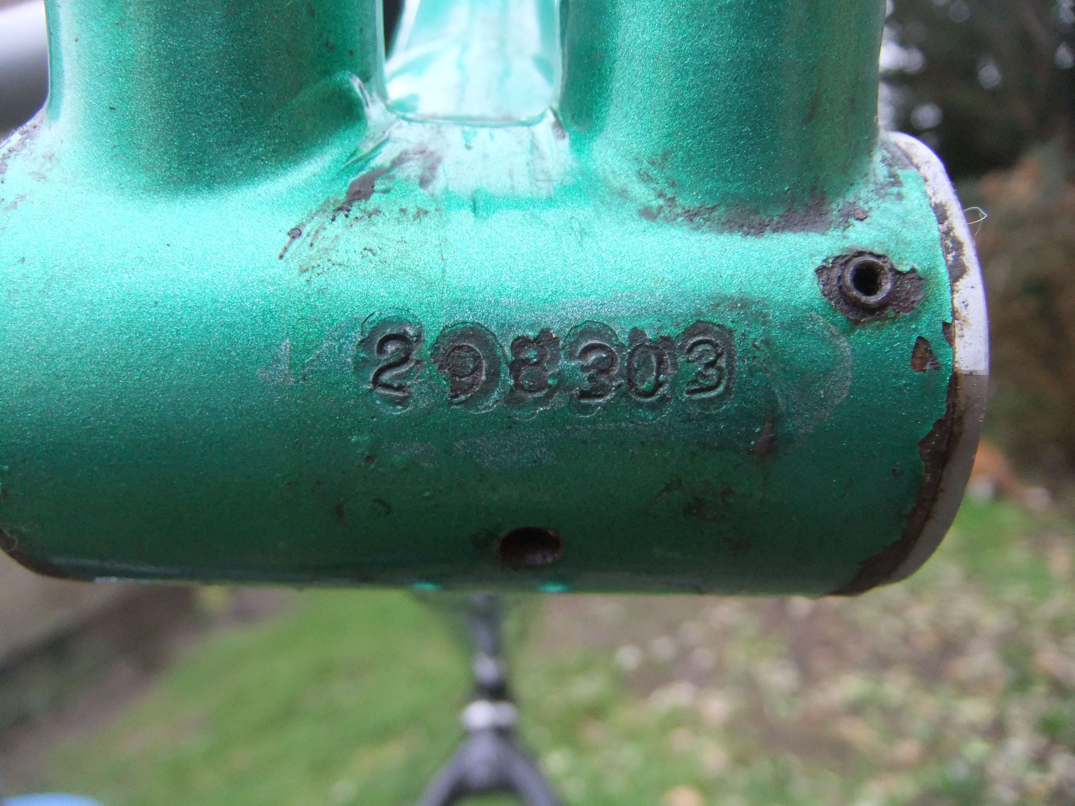

What I didn't know at the time (and neither did the seller) was that the BB threads were partially stripped. Someone had overcome this by tapping three small threaded allen bolts around the BB shell to grip the cup in place. Pretty clever if it works. If not I'll have to go with a threadless variety. The paint is now stripped and I'm pretty much decided on the new colour scheme. More to follow.....

Clearcoat...? Just because it seems a shame to hide any of it's beauty ;)
Re: 1988 (?) Overbury's Pioneer
Some neat brazing work there.
I'd get a LBS to chase those threads, as I managed to get a BB's to securely thread into something just as bad, when I rebuilt a Bigfoot.
It would be worth getting the bb shell threads "chased" as they don't look too bad to me, also If you get hold of a BB with longer cups that insert further, they would stand a chance of holding fast.
The threadless BB's are pretty good, especially the old Mavic ones, which are pretty light too.

I will get the threads cleaned out after it is painted but they are actually worse than the photo suggests.
