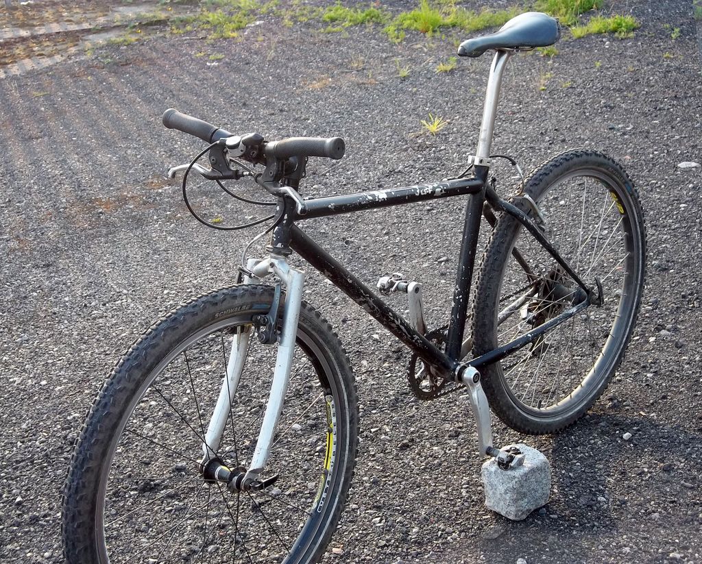

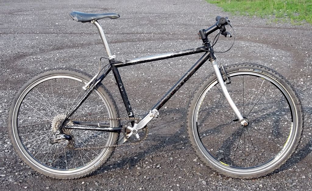

Allow me to introduce my beloved hack! An uglified P7.
I just wanted a bike that I can happily leave locked up outside the shops but
one that still has decent spec hung off a good frame and this was the result:

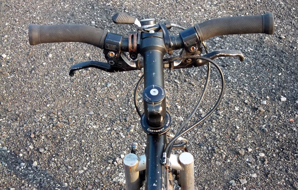

A close up of the controls...

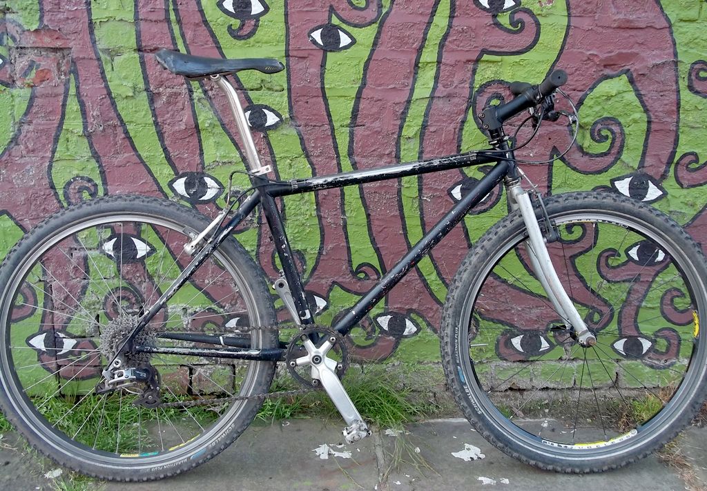

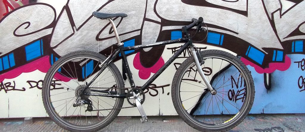

Plus a couple of graffiti pictures 8)

Frame: 17" Orange P7
Fork: Orange F7
Stem: CODA
Handlebar: Syncros Riser
Headset: FSA Orbit Extreme
Brake Levers: Deore II
Brakes: XTR V (front), No-name V (rear)
Shifter: Deore II Thumbie
Rear Mech: SRAM X-9 Short Arm
Cassette: Deore LX
Chain: Hyperglide HG40
Cranks: Race Face North Shore
Chainring: Middleburn
Bottom Bracket: Deore LX
Pedals: Deore DX
Front Wheel: Mavic Crossroc UST
Rear Wheel: Mavic 121 SUP on Deore LX
Tyres: Shwalbe Marathon Plus MTB 1.9
Skewers: Mavic
Saddle: Selle Italia Grey Flite
Seatpost: Orange
I'm currently in two minds as to whether to keep this bike as it is, or swap out the frame with an incoming Lava Dome and do a nice repaint of the Orange frame adding a higher end, lighter spec. Either way, I'm sure the best solution will present itself to me over the next few weeks...

The right hand thumbie for rear mech shifting would be enough to put some off stealing it. That is one of weirdest setups I have seen. :lol:
However the use of canti brake levers with vee brakes is just dangerous. Do yourself a favour and get some basic vee levers. You can find shimano acera ones for £15 a pair brand new. You could probably get some used shimano deore or avid speed dials from the for sale section here for £10 or less.
How wide are your handlebars by the way? Are those just really long grips are those bars less than 550mm? Not sure I could steer that without falling off!

The brakes work OK actually - for canti levers I think they've got quite a long pull. Often get comments about the ridiculous handlebar width but it comes in handy fitting through little gaps and riding narrow canal towpaths.
