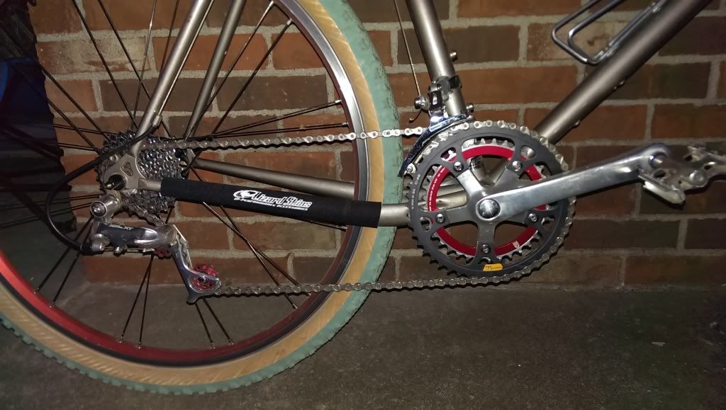

Got a new wheelset on the bike now. Found a Rolf Dolomite wheelset w/ red anodized rims that fit the bike perfectly. Now running a M737 NOS rear cassette, and also a black 46T Shimano SG chainring to go with the black/polished/red theme of the bike. With the Rolf wheels the bike is now under 23lbs and its coming in at 22.45 lbs. Going to pop some lightweight tubes on as well, and a different stem eventually. Trying to get the bike under 22lbs and then Ill be done with it.
pics.... Let me know how you guys and gals like it.

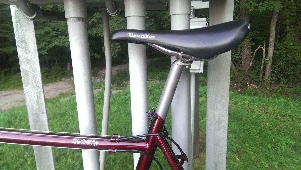

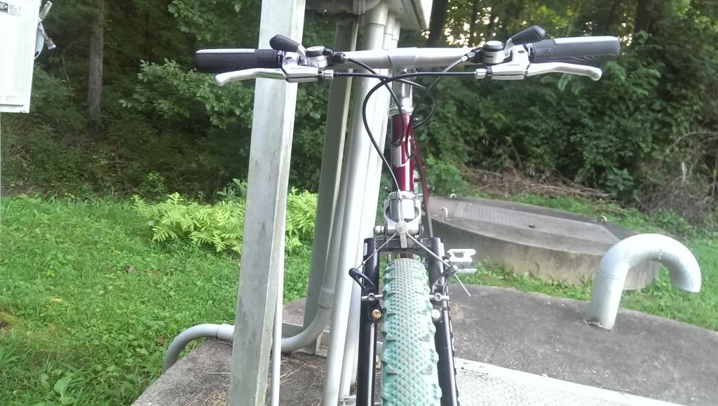

Put some new mods on the bike. I just love this frame, it climbs so well...its so fast, agile. So I wanted to keep it lightweight but put on a SUS fork so that I could ride it as a hardtail and make it more versitile. Found a AMP F1 from a Univega Alpina s6.7 and put it on mine. Got a Trek System 3 stem, FSA Orbit-x 1" threadless headset, and a Chopsaw 36T middle ring. Updated Specs List....
Frame: Univega 969 Racelite Cromoly
Fork: AMP F1 w/ 4130 Concept Legs
Headset: FSA Orbit-x Polished 1" ahead
Stem: T System 3 4130 Cro-moly
Handlebar: Univega Concept Alloy 580mm
Grips: Bontrager Inform RL
Barends: None
Brakes: Shimano STX Cantilever
Brake Pads: Dia-Compe
Brake Cables: Shimano M system
Cantilever cable hangers: Shimano
Brake Levers: Shimano
Shifters: DX Thmbies MT62
Front Derailleur: Shimano STX Top Pull
Rear Derailleur: Shimano XT M737 Short Cage w/ Red Jockey pulley
Derailleur Cables: Shimano M system
Cassette: Shimano XT M737 11-28T
Chain: KMC X8 Nickel Plated
Cranks: Deore DX
Crank Bolts: Shimano
Chainrings: 46T Black Ano Shimano SG/ 36T Red Ano Chopsaw
Chainring bolts: Shimano chrome plated
Bottom Bracket: Stock Shimano UN Type
Pedals: Wellgo WR-1 Silver
Hub Skewers: Salsa Flip Off Ti
Rims: Rolf Dolomite Red Ano 20H front/24H rear
Hubs: Rolf Sealed bearing
Nipples: Rolf
Spokes: DT Double Butted
Tyres: Michelin Green WildGripper Sprint
Tubes: Bontrager
Saddle: Ritchey Vector Wing
Seatpost: 26.0mm Univega Concept Alloy
Seatpost Binder: Concept
Weight: 23.1 lbs

Rode it out on some trails and its not as plush as my 100mm fork on my 2011 hardtail, its actually really stiff...stiffer than I expected it to be. The fork doesnt soak up as much as a typical fork but it does smooth out the ride and it still feels like a rigid bike for the most part, I think thats how the AMP fork is designed to work...feel rigid and provide just enough travel to even everything out.

you might want to try a lighter weight spring and/or perhaps use lighter oil in the shock. as much as i LOVE amp forks, i wouldn't have considering swapping them for the original colour matched fork.

Well the AMP fork was 2.4lbs and my stock fork was 1.9lbs so it didnt add much weight to the bike and I ride a lot of XC and singletrack and the AMP fork does well in that regard. I may try a lighter spring, and also the oil. The fork after the ride seems to have softened up a little bit. I think it was sitting for some time since it had been ridden maybe it was a little bit stiff.

Nice bike - chain looks a bit short even considering it's on the big ring.

It is a bit short. I had it on a triple before and short cage rear mech was not picking up the slack in the granny ring. Now I removed the granny and probably need to add a couple links back in. Good eye
