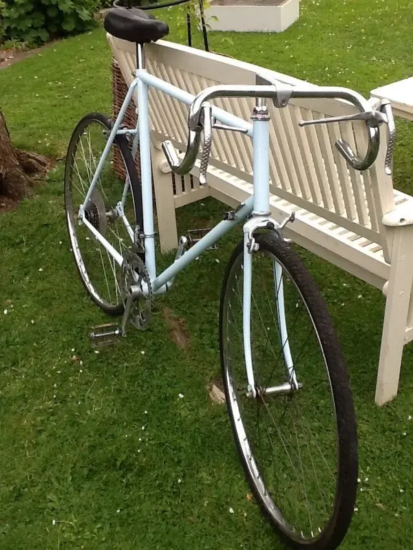

Hey guys,
Hope you're all well, this is my first post! For the past 4 months I've really got into into cycling, currently riding 3/4 times a week and I've gone to just over 70miles. I've recently taken up a project, my uncle found an Peugeot racer, it was pretty battered, I've spent about 20 hours getting it too this condition, I've still got lots of work (new wheels, saddle, crankset, brakes, etc) so far everything is from the existing bike, but, the big question is do I turn it into a fixie? I hear they're fun, just wondering what they're like over long rides? Any advice is really appreciated!
Thanks guys!

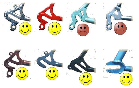

I can't see from your picture, but if you've got slot type dropouts on the frame, you can try out single speed very cheaply.
Leave off the derailleur, select a front chain ring, and a rear sprocket, shorten the chain so that it fits and adjust the tension by moving the rear wheel back of forth in the dropout. Ride it around and see how you like it. :D
