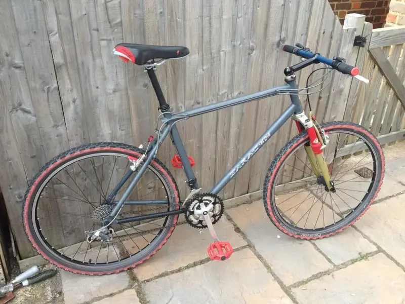

So heres how it started, 95 tufftrax elite frame
xt front and rear mechs
specialized chainset, with specialized rings
USE seatpost
Rock shox Mag 21
Kona impact headset
Cook bros Dogbone stem
Pace/renthal sub 130 bars
suntour xc thumbies
Mavic 217 rims
Bullseye front hub
XT parallax rear hub
Deore DX cantis and levers
cheap saddle

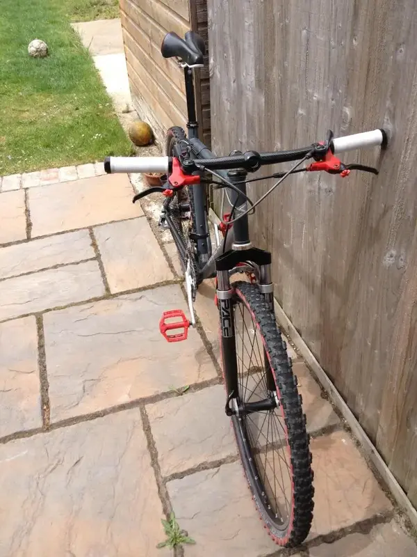

And heres how it looked mid way through, I swapped the wheels for some Mavic 225 rims with shimano and specialized hubs, because i wanted black wheels.
I sprayed the outer ring black and changed the saddle, it looks a little bulky but i want something comfertable for my daily ride to work. :)
oh and the seat post got a spray job too!

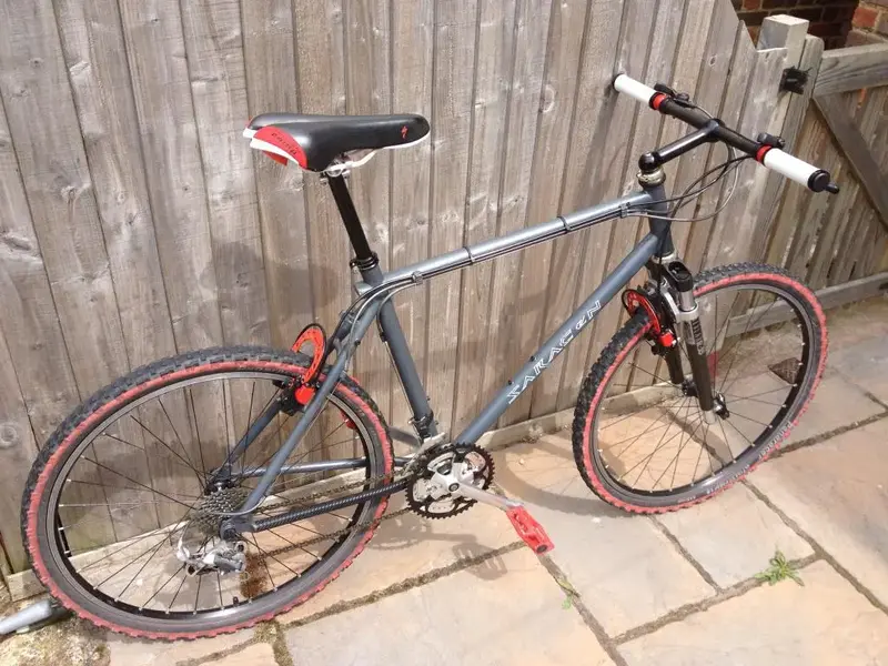

And seeing as the whole tart up started because the shox were looking a little dated and id always fancied a pair of RC35's , this is the direction i went in, with some generic carbon bars, after stripping the RC35s for a service and to change the steerer, the crown was looking pitted, tatty and needed a rub down, but being too impatient to send them of and have them re-anodised or plated i decided to spray it black and have to say that i quite like it. The maguras came as a red set, but they too were a bit scuffed and worn so they too were treated to several layers of new enamel spray paint. all the paintwork i have fone is enamel sprayed paint, the compoments are rubbed down with 180, then 280, grade wet and dry, then given a coat of primer, the paint is built up in layers and left to hang in the airing cupboard overnight in between each layer, the maguras took a week and a half to paint like this!! and the crown about 4 days
