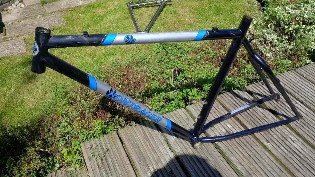

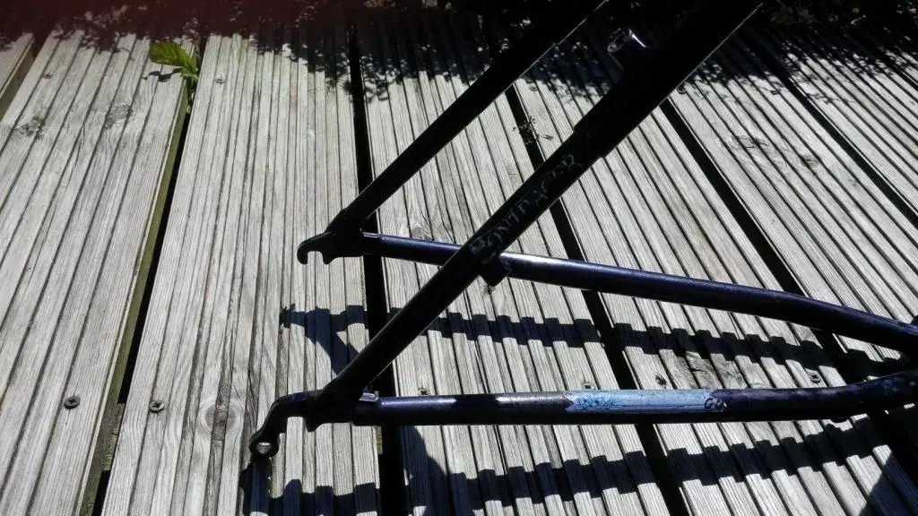

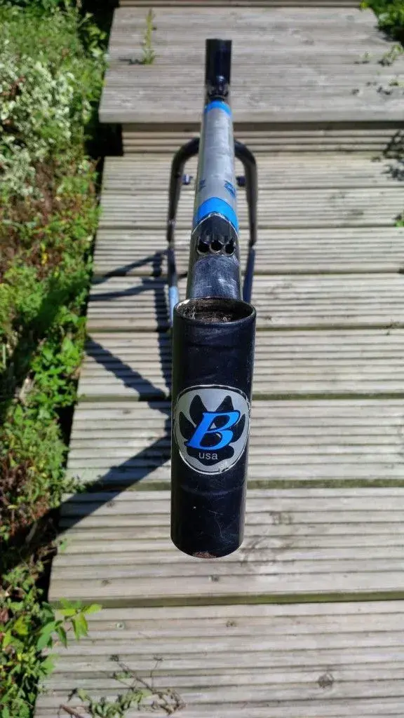

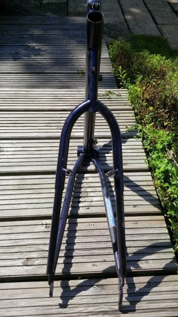

Stumbled across a really nice and original Race Lite a little while ago, and have finally got my hands on her. Have stripped her down, as I'm going to get her repainted and re-decaled and rebuild her into something that might have stumbled off the production line back in 91/92.
I've attached a couple of pics here, but have a gallery online of hi-res images if anyone wants to see them - so this is the starting point of this thread - however, I have a couple of questions about her to really pin down the details:
1 - Does anyone know how to exactly identify the year of build? I ask, as I am 95% confident that she's a pre-Trek Bonty and is probably somewhere around 1990-1994. However, I need to source some forks and I'm trying to work out whether she's a suspension adjusted geometry or not - my gut says that she's probably not.....
2 - I can't find a frame number on her - is there anywhere that it should be? (I've probably missed it somewhere).
3 - My preference is for rigid forks, soooooooooo has anyone got an appropriate 1 inch steerer forks for this? My preference in an ideal world would be some Bonty Switchblades or similar to set this off perfectly - but also love the look of Syncros Powerlites or Pace RC30's etc - but the geometry does seem to determine this issue for me....

PostPosted: Mon Jun 03, 2013 10:31 pm
retrobike rider
retrobike rider
Joined: Tue Feb 23, 2010 8:30 pm
Posts: 1096
Location: Nottingham
It looks like 94 to me but I may be wrong. Switchblades are the only way to go IMO :wink:

Thanks ratcapa - two questions from me:
1 - How do you know it's a '94 as opposed to being something earlier / later - is there a particular feature that marks it out? (just learning).... and... if it's a '94, does this mean that it's a suspension adjusted geometry frame?
2 - I would tend to agree on the Switchblades - what really annoys me is that I used to have a set of Tange Switchblades back in the early 90's on my M2, but swapped them out when I managed to get a set of Powerlites - cannot for the life of me work out what I did with them, so assume that I sold them! (Ggggrrrrr) Would have been perfect for this!

Well I'm pretty sure that those decals came in around that time presuming they are original. My Bonty is what I can gather a 94 and looks identical and had the same decals although I have swapped to the earlier ones. The things I looked at are the gussets, drop-outs, head tube, rear stays and cable routing.
If I'm wrong someone will correct me I'm sure :wink:

It's a 94
Serial numbers are on the inside of the dropouts, and for all intents and purposes are useless

Thanks for the replies. Happy to accept its a '94!
However, does anyone actually know whether this is a suspension adjusted geometry frame or not? (or how I can find out?). I need to know as it clearly affects which forks I try to source for it...

The TT for any size sus corrected bontrager in '94 is .20" shorter than full rigid
Also the st angle changes from 73 to 74(rigid-->suspended)
