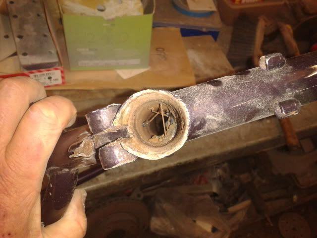

i got this karma frame off andyz, top bloke.
the seatpost was stuck and the seattube was...well, rusty, and thin.
i removed the post by the "post in a vice" method.
when the post was out, i had a look inside. the post was stuck because the seat tube had been welded just under the lug. the weld had been ground off, along with most of the tube, but the interior of the tube was still full of weld, and the post had been forced into the weld! :shock:
so, it was never going to have an ajustable seat tube again!
i should have taken before pics, but my battery was flat when i decided to investigate. :(
i welded up the holes in the seat tube, once i had removed the fibreglass.
then ground down the weld. the metal was so thin/non existant that it kept blowing holes even on the lowest setting, so i ended up bridging the tube with weld.
this is never having a seat tube inserted more than 3"!!

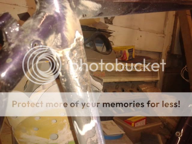

obviously, filler and paint needed, so tonight i started removing the paint around the rusty areas.......well :shock:

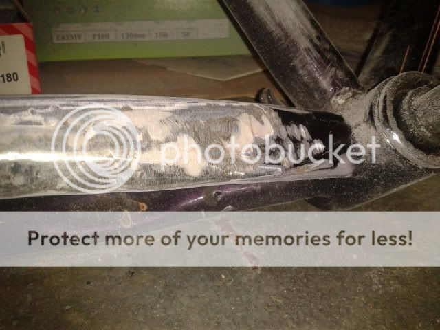

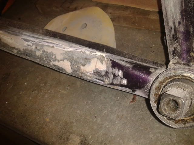

the drive side chain stay was also made of fibre glass, with the chain suck nearly piercing the stay for about 2"!
then there is the dent at the bottom of the seat tube next to the bb shell
this too was distorted and ovalised, and sort of twisted....strange! seems that where the top of the seat tube had rust/grind marks under the lug, previously this had split right through, and the seat tube had twisted, but the lug, top tube and seat stays had not!!! i can only presume the seat post has been in a vice before, and as the frame was levered back and forth, the seat post and tube broke away, twisting the bottom of the seat tube/bb area!!
this could also explain the original welds inside the seat tube!
i think this frame is dead!!!!!!

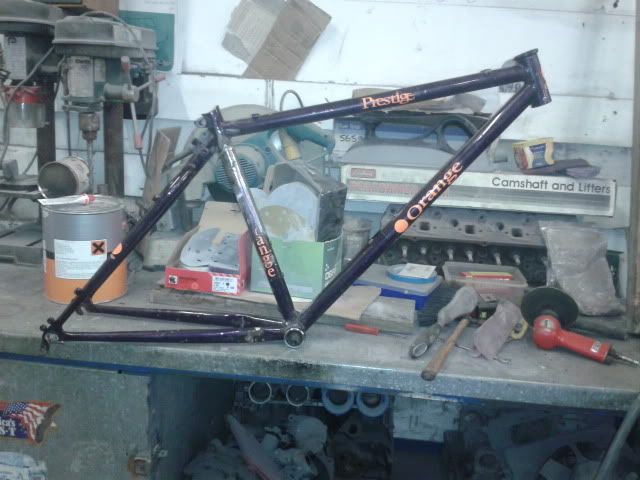

I'm confused. That frame stickers says its a Prestige, but your post title says Clockwork.
PostPosted: Thu May 30, 2013 9:43 am
Joined: Sun Jun 20, 2010 4:39 pm
Posts: 1473
ha ha, there's alot about this frame that isn't as it seems.....
the decals are not orange decals, they were cut out from a sheet. andyz told me it had prestige decals on it :D
PostPosted: Thu May 30, 2013 10:00 am
retrobike rider / Gold Trader
Joined: Sun Sep 16, 2012 9:59 pm
Posts: 2240
Location: Kent, UK
The chap I bought the frame off said that it was a Clockwork he had owned from new, and that it now needed a little re-furbishment :lol:
He re-stickered it when it was painted.
As soon as I saw the rust holes in the seat tube I thought I'd scrap it, but just in case someone wanted to save it, I posted it on here, and hey-presto here it is. I hadn't realised the chainstays were knackered too!
