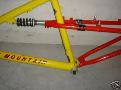

i am rebuilding a 1993 Rocky Mountain "The Edge" Full Suspension Bike. It was built with an rear triangle licenced from AMP Research. Someone called this Bike "Mongoose Amplifiers twin sister". It has some kind of bracing in the rear triangle too take up the force from the magura brakes. This link is missing on my frame. can someone post a picture of the rear section to show me much details as possible?
I'll add some pics of this kind of bike (not mine) , the black part on the rea is the piece i am talking about.

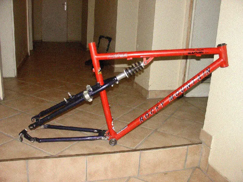

Mine actually looks like this. I'll have a visit to the welder next week.
Any idea were to get this "bridge" nowadays?

That clamp was an after market add on that did come with some bikes rather than an OEM part. It was designed to stop some on the twisting in the suspension rather than help with magura (just use a brake booster for that). Think it was made by AWP or similar - there was one on ebay recently branded as Fat Chance, not sure if its still there. Or just wait til the next (broken) mongoose/AMP gets sold on ebay for $50 and get the parts off that if they had fitted one(at least your frame is well made and won't break up after the first few rides!
