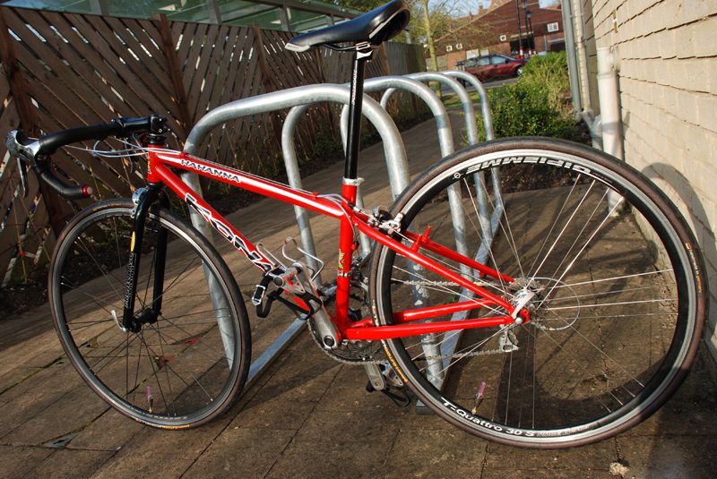

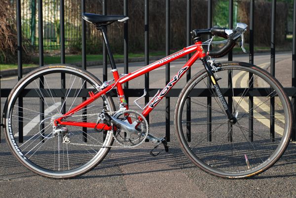

Here's some pictures and what I used and did:

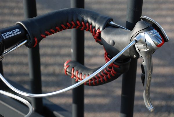

- Ultegra groupset. STI flight deck 9 speed shifters/cassette/rd/fd (double), and incidentally chunky Ultegra rear hub. Like a fool I decided to put gears on this bike. I basically went with what I could find on ebay at a reasonable price, and started with the shifters, as what I could get hold of would determine the groupset (eg. 8 speed, 9, shimano/campag etc). I bagged a good condition set of 9 speed triple STIs for a decent price, flight deck compatible (not that I could afford that!). That meant I had to find Ultegra 9 speed stuff - and did ok. Critical was finding by chance the rebuilt rear wheel with an HG cassette, Ultegra hub - ideal. No faff. The rim was more worn than I'd like, but still had a good wear groove present. Can't recall the precise cassette ratios but I knew at the time and calculated accordingly to get the short cage RD.

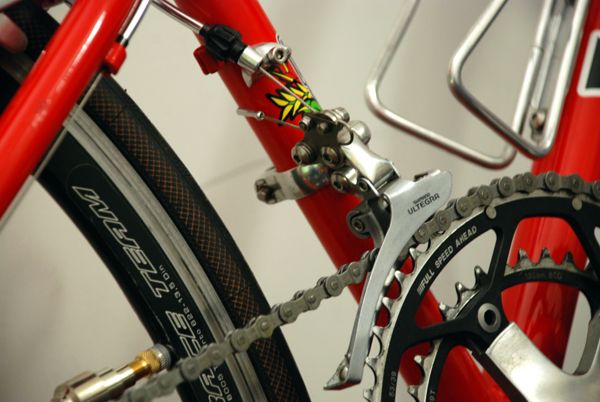

Front derailleur was a problem, because like a fool I hadn't realised that some derailleurs were bottom pull, some top. My frame only had cable stops for top pull. I had a bottom pull Ultegra FD. So, lots of reading later, we made an experimental titanium rip off of a Speen adapter, with some tweaks. My STI shifter was designed for 3 chainrings, so plenty of clicks to pull the cable across despite the slight mechanical disadvantage. Worse to come: because of this adapter, the cable had to come out at a sheer angle form the stop on the down tube - it was simply unacceptable. So, we hacked the back off an old RD, put a riv nut in the seat post tube, and bolted in a new cable stop. Elegantly done, but quite a wacky mod!
- Tiagra hollwtech pedals/XTR BB/FSA chainrings 52/39: The BB was new, from Rose cycles, and the cranks and chainrings came as one off fleabay. Again, what was available at the right price. Beggars could not be choosers with this build! Of course, I knew the chainstays might be wider than a road bike, and conflict with the HUGE chainrings. I researched fitting this well-reputed MTB BB with these considerations, and it worked to put one spacer crank side. It meant I lost a tiny fraction of spline on the other crank attachment, as the cranks are designed not to have spacers. My assessment was this was easily passable. The inner chainring is CLOSE to the chainstay, but acceptably clear. Alignment? Indexing? Of course I faffed for ages. No problems with chainline at all.In fact, fewer than I read about people reporting on standard road bikes. Worked very well in almost every ratio. It shifts so, so smoothly!

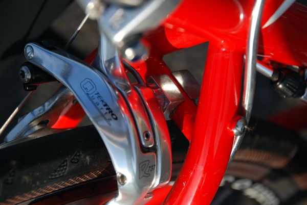

- Tektro Quartz normal/medium reach calipers/Kool stop salmon pads: Why not callipers on a MTB frame converted to 700c wheels? They work fine -but do need mods to the frame/forks. I originally had some nice short drop callipers but they were a fraction short. You'll see form the pictures we drilled the rear bridge between the seatstays and also the hole in the forks. The bridge has a custom ally washer, made by my father and I (similarly commented how hard the cro-mo is!). I could have ground off the cantilever posts, but the bike may get rebuilt and they may be wanted, so I didn't want to disable it. Kool stops to look after my rims!
- Gipiemme T-Quattro rear wheel and Gipiemme..something else..front: What was available to me at a good price! The front has a silky smooth original hub and is little worn; the rear is older but came with so much money worth of stuff on it and was so ideal I had to have it. We cold set the chainstays of course to fit a road wheel - bit hard getting it symmetrical, but got there in the end, and the wheel fitted nicely.

- Custom stainless STI shifter guards. Ever leant your bike up on a wall? Knocked it over? Crashed it? What scrapes the ground/wall first? The damned expensive STI shifters! Hence why I've got some red paint on the tips disguising some of the previosu owners misdemeanours. We decided to create some experimental shields, obviously compromising on weight and ergonomics, but what the hell. They are held on with jubilee clips, all stainless, and re-positionable. I made four sections of leather padded handgrip and laced them on (at bit like Gropes). Overall, for my riding style, it's all quite comfy and usable! Only fitting that the 'ram' should have horns..
