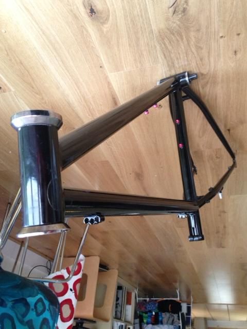

was told this frame was a 98 Explosif all I know is it's light and I can see the frame numbers.
I did quickly sling it together as a single speed to try it for size, it's a wee bit small for me, but gonna build it up all the same.
so two major questions before I start is it definately an explosif? is it a 98? that would make it 853 yeh?
then what decals to use, I like all years decals maybe 92 would suite the black, I know that a lot of Kona lovers switch years late bikes with early decals etc so what do you think?
built up for the school run

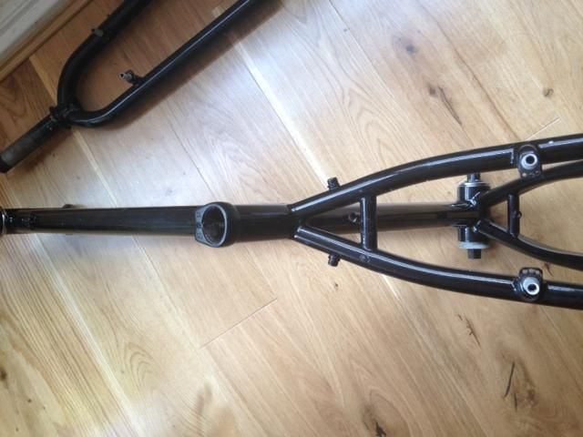

the frame
ignore the bottom bracket it's coming out again

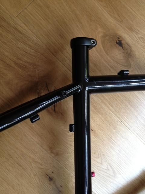

bit of touching up to do

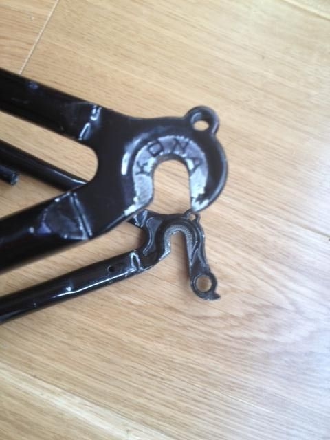

came with threaded forks, spinner on the drop outs but do recall some P2s having spinner on them or am I imagining things?

lovely tiny frame !! post 96' cause of the cable stop but strange it came with threated forks...

Def not a 1998 as they came with different dropouts, other than that I'm not sure to be honest, if you weigh the frame you can rule out a fair few options.

That's my only reservation that the drop outs look different
though I have seen different drop outs on small bikes somewhere

There's a link here to a tiny 1998 Explosif with the same dropouts as my 19 inch 1998 and 1999 bikes, that being said the dropouts are different from my 1998 Lavadome so it could be a 1999 frame? Not sure what though.

Dropouts look the same as my '97 cinder cone ? (Prior to the disc mount addition of course)
Can't quite see it in these pics, but the kona moniker is there.

By 1998 the frame would have been ahead, so wither they are mismatched forks or the frame is earlier.
They should be triple butted: IIRC that means TB stamped on the fork. Others (plain or DB) had Spinner.
My 18" 1995 Lava Dome is exactly 4lbs, weight wise you should be under 3.8lbs for it to be an Explosif.
