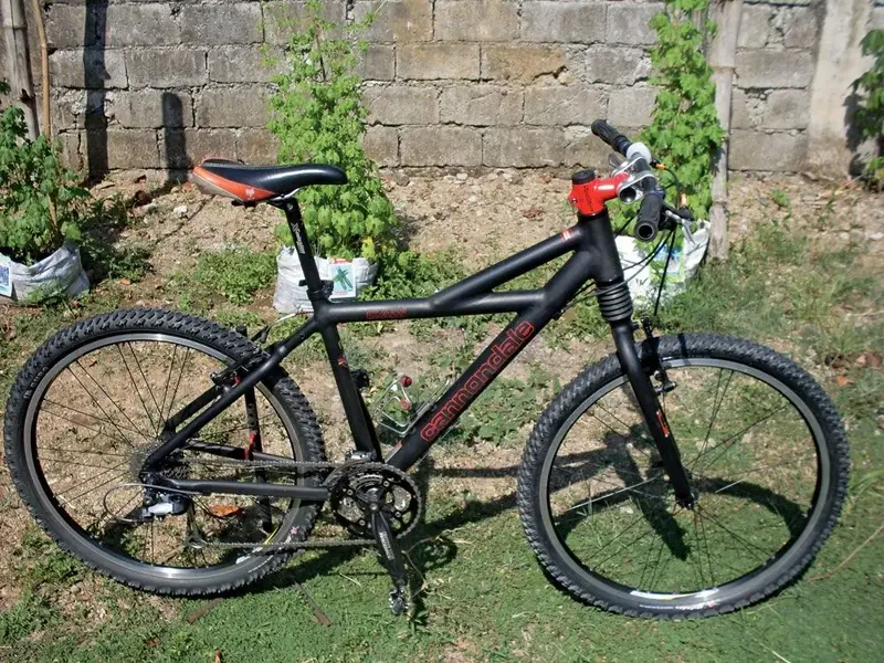

posted the frame/stem/bar in bike chat sometime ago... after a bit of scouring the shack for bike parts I finally built it up. The thing weighs 25.6lbs. and I'm giving it a long distance test ride tomorrow.

Frame: 97 Cannondale Killer Caad3 - Small
Fork: Cannondale Headshok
Headset: came with the fork
Stem: Syntace
Handlebar: Syntace V2 Ultralite 62cm
Grips: Amoeba
Barends: none
Brakes: Shimano
Brake Pads: Shimano rear / MOB front
Brake Cables: Shimano
Cantilever cable hangers:
Brake Levers: Tektro MT 4.0
Shifters:
Front Derailleur: Shimano Deore LX
Rear Derailleur: Shimano Deore LX
Derailleur Cables: mix of Shimano and Jagwire
Cassette: SRAM 9s
Chain: Shimano HG71
Cranks: Raceface Ride XC 172.5
Crank Bolts: FSA
Chainrings: Raceface 44Tand FSA granny
Chainring bolts: Raceface
Bottom Bracket: Raceface
Pedals: Shimano PD-M505
Hub Skewers: USE Spinstix Titanium
Rims: A-Class Vectra T5
Hubs: A-Class
Nipples: brass
Spokes: DT
Tyres: Duro Matador 26x2.1
Tubes: Giant presta
Saddle: WTB Rocket
Seatpost: X-Mission comp
Seatpost Binder: Cannondale
Weight: 25.6 lbs

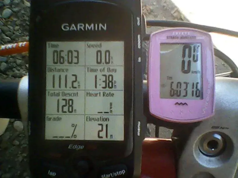

I'd like to shed a couple of more lbs. from this bike so a few upgrades are planned. The headshok gives a plush ride but seems to be on the softside for my taste. I think I lose a third of the travel from sag (designed that way?)
After my maiden ride yesterday I replaced the horrible Amoeba grips with my favorite Michelin gel grips. Loosened the tension on the SPD pedals and also replaced the stock seatpost saddle cradle as it creaks (problem solved) and then tweaked the shifting due to cable stretch. Now it's close to perfect.

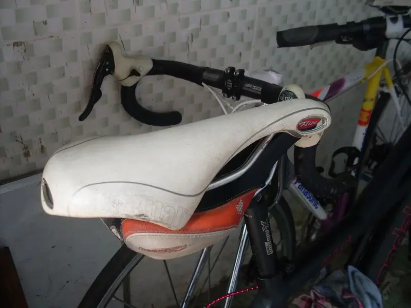

replacing the WTB Rocket saddle with this one... seems like the saddle of choice here altho a little on the late model
