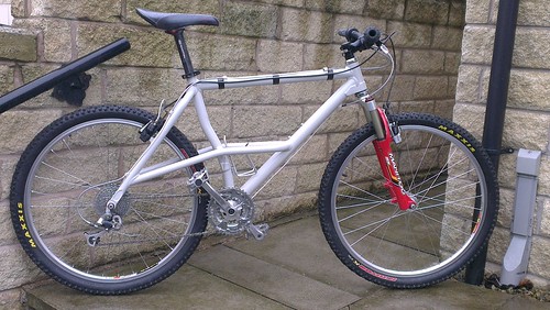

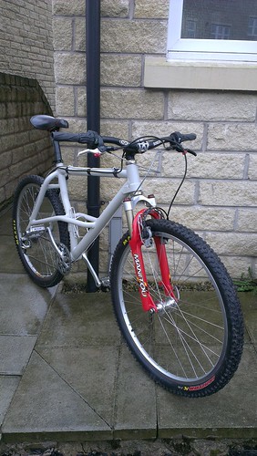

I picked this frame up from a Racin'snake as I have always wanted one and like a project. I had every intention of polishing the frame but after stripping the frame it was a little more pitted than I thought it might be.
So after a very cheep powder coat in a nice NHS bed frame cream/grey colour and the parts from my Nishiki frame I almost have a full bike. Some tit has cut off the front mech mount, so the post man in delivering a e-type mec and then just a brake booster to find and fit.
Turns out I like it, very understated and I think some white decal at some point.
You will have to excuse the use of electrical tape. :oops:
IMAG0178 by Brian Marshall1, on Flick
IMAG0179 by Brian Marshall1, on Flickr
IMAG0177 by Brian Marshall1, on Flickr

The E-Type front mech. needs some form of lug on the seat tube to secure the bolt to that stops it rotating in operation...
...not enough to just secure it in place with the BB cup; the chain will 'grab' it and rotate it until it comes up against the top of the BB shell.

God dame it..... :facepalm: I don't know that thanks for letting me know. Any ideas?
Cheers Brian

I think a low-mount front mech might just sit low enough to work, have you got one to offer up?
Remember you need bottom pull!

Was looking at a frame with the same missing front mech holder missing, didn't buy it in the end but found this, not sure if it'll work:
http://www.extrauk.co.uk/product/detail ... tors/2449/
