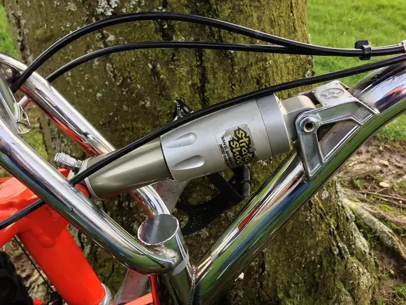

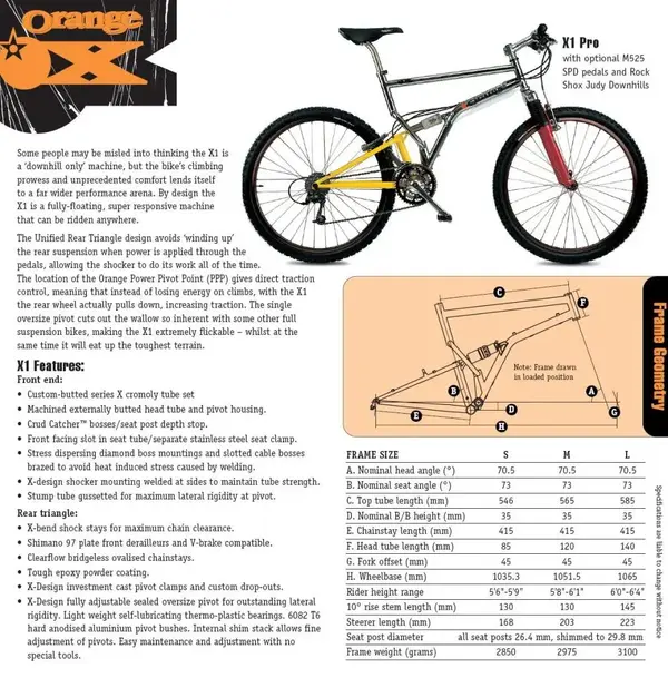

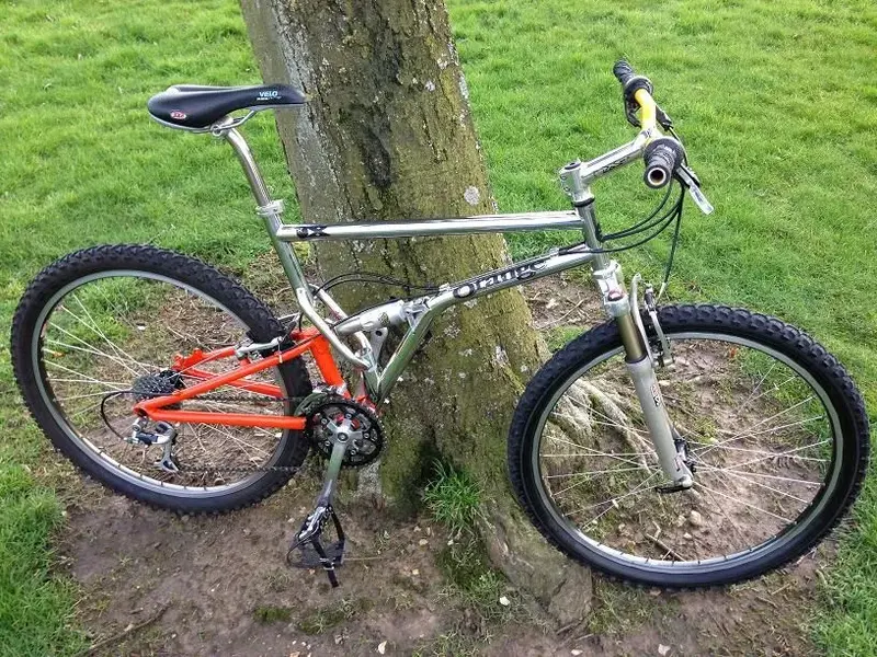

Behold one 1997 Orange X1 (Actual birth date of the frame August 1996) Now at this point I do realise that it is often referred to as the ‘Marmite’ of full susser bikes, you either love it or hate it, partly down to the Unified Rear Triangle (URT) Set-up. Now I’m used to quirky Full Suspension bikes and after having a fleet of Proflex’s I’m used to the Rock Hard Elastomers, unusual frame designs and the wonders of Girvin Crosslinks and Vectors, but I've always made my own mind up about the bikes I've owned and never passed judgement unless I could speak from experience on a bike. And after trawling through the many threads on RB I have found that owners of X1’s have enjoyed them, testament to that is some great build threads which have kept me going until the right bike came along. As small test ride has been completed and i can confirm that i love it, feels very responsive and not a glimmer of the 'Pogoing' often attributed to early full-sussers especially as i am used to the Proflex bounce ;).
And here it is, I'm the second owner from new and this has not been tweaked too much and is pretty much standard as the day it was purchased.
Frame - Size Medium
Forks – Rock Shox Judy XC
Headset - Ritchey 1” Threadless
Stem – Orange ‘OX’ SK9 Ahead Stem
Bars – X-Lite G-Force
Shifters – 8 Speed Grip Shifters
Front & Rear Mech – Shimano XT739

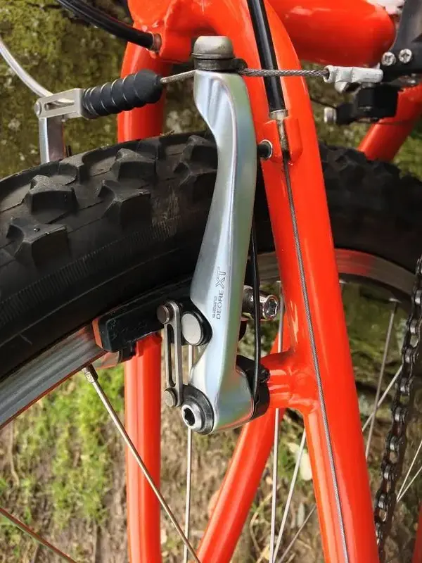

V-Brakes & Levers – Shimano XT739
Chainset – Shimano LX
Wheels – Shimano LX Parallax Hubs, FIR Rims with DT Double Butted Spokes
Tyres – Maxis 26 x 2.10
Seatpost – Orange 26.4 Shimmed to 29.8
Saddle – D2 Velo Plush Comfort
Rear Shock – Strata Air Shock
And so the deal was completed and bike loaded ready for the return leg back to Norfolkshire, not even the weather could dampen the smiles coming from me as I kept catching glimpses of the shiny chrome frame in glinting in my rear view mirror. This one is definitely a keeper........
There will be a few minor changes, including saddle, bars, tyres, but it will be kept pretty much stock. Some new decals from Gil_m just to freshen it up and it may just be my partner for Mayhem this year :D

As you say, the X1 is a real Marmite bike. Personally, I love it, and this looks like a really nice example. :D
I'm not a weight weeny by any stretch of the imagination, but would be very interested to know what it weighs. Weighed a Proflex 754 recently and that was 30.6 Lbs. If felt lighter than that though.

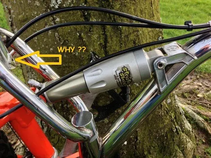

I love mine, its so butt f'ing Ugly / awkward looking it always creates a stir
just get ready for "is that a P7 cut and Shut" when they spot that left over single bottle boss
bolt hole that seems to serve no purpose what so ever ..... X1 owners will know exactly
what I'm on about.
I'm guessing yours must be a 97model a year newer than mine since its running V Brakes and also has disc mounts on the URT

File comment: W.T.F is this for ?

I always assumed that "spare bottle boss" was there to stop you lowering the seatpost too far.
