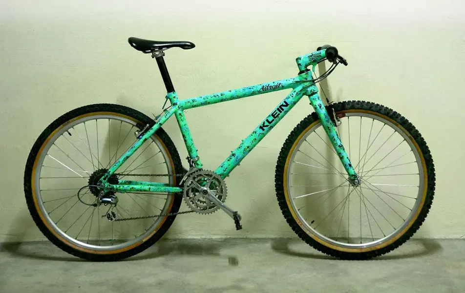

Just got her back from the shop, now to find meself a nice CRANKSET..Any suggestions? :)
ITS TIME FOR A COMPONENT FACELIFT!

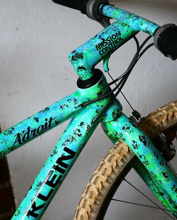

Another Shot

Yep no problemo here.. Nice mate, real nice..
When you say back from the shop, do you mean spray shop?

Thanks dude, I can view them now, seems like my browser's been having some weird issues.. happened a few times before.
She was at the shop for cabling and tuning, the paint is original from day 1 :wink:

Hey , by the way, can anyone tell me how to loosen and re-align the stem+bar? its a little off cantre and loosening the bolt on on top didnt do anything :?

Sounds like its a bit seized. Blast it with some WD or some GT85 and leave it overnight. Just make sure when you put it back in you grease it up.

Might want/need to tap the bolt once you've loosened it off a bit. Unwind it a few turns though, so the bolt's sticking up and you don't smack the paint on the stem...
the angle on the wedge on mission controls is much steeper than many quill stems, so it can sometimes stick mroe easily - once you've knocked the bolt (and bottom wedge) back down it should be fine.

I think these would look rather nice on there:
http://cgi.ebay.com/KOOKA-CRANKSET-NOS- ... dZViewItem
