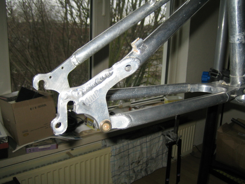

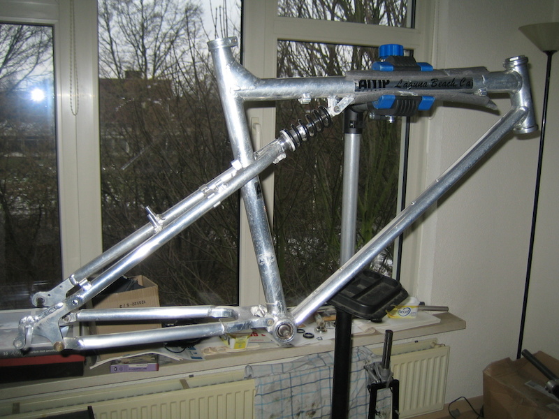

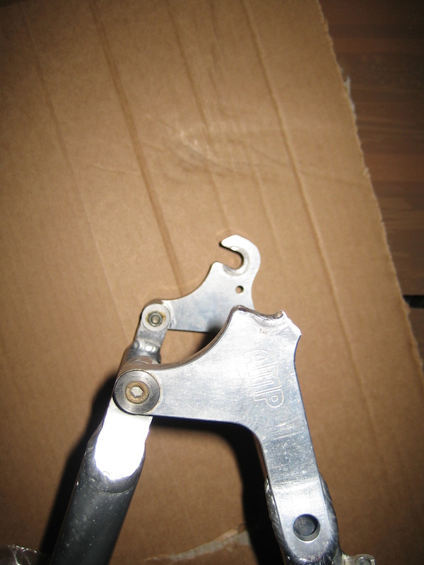

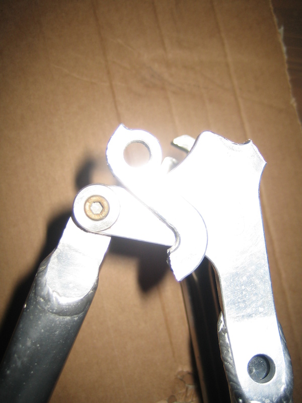

I am lucky that the broken derialleur hanger is weld back on the seat stay,so that i can build the amp :D
Her some photo`s from the broken derialleur hanger.
And her the result derialleur hanger weld back on the seat stay.
The Amp will be black and silver when it is finshed with the build.

Her i have one other photo taken from the weld derialleur hanger.
And why not save to ride with this frame :roll:
The person how weld it for me,had done a great job and it is know beter and stronger than before.

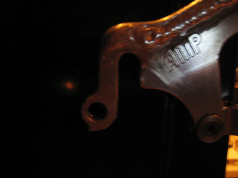

I'm afraid when I look at that picture. I'd really like to see more detailed close ups with no flash.
Is there weld down the sides to the axle? I would have replaced the dropout.

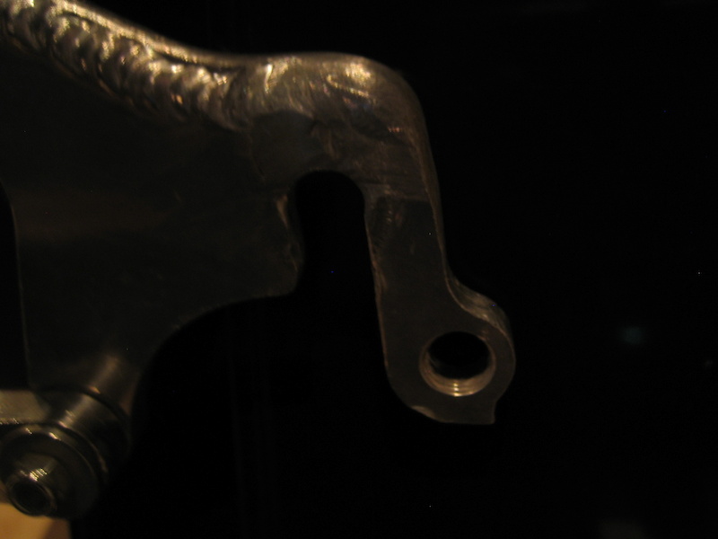

Her some photos taken close up,from the weld derialleurhanger.

That's a scary repair! Check that regularly when you ride it.
Good luck!

If this frame is 6061 aluminium like my Mongoose Amplifier 2 as I suspect then I would be very careful with this weld as 6061 looses its strength when welded and must be re-heat treated. Found this on wiki:
Quote:
6061 is highly weldable, for example using tungsten inert gas welding (TIG) or metal inert gas welding (MIG). Typically, after welding, the properties near the weld are those of 6061-O, a loss of strength of around 80%. The material can be re-heat-treated to restore -T4 or -T6 temper for the whole piece. After welding, the material can naturally age and restore some of its strength as well.
If its 7005 then it should be ok.

hmmmm., you really think that is going to hold? from what I can see of the repair, the weld is along the top leaving the hanger still separated from the drop out by the crack.
The hanger/drop out looks to be one thick chunk of aluminium so no fancy bending required - I think you would be better of remaking the drop out and hanger then welding it onto the stay.

While I think the repair will probably hold if it were mine I would take that to a machine shop and have them cnc you a new one and then just weld it back on like the original. They could very easily reproduce that piece even with the Amp logo on it. Not sure how much that would cost though.
