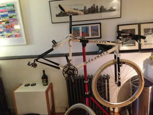

Bought this years and years ago but much to my shame the fully build pics never made it on here - spent last year or so tucked away in a storage unit after a house move but is now back on the workstand to be built back up again.
Follow progress here....
Comments welcomed
Frame: Chas Roberts DOGS BOLX Columbus Max main frame.
Composite rear stays--
---Extra stiff 4130 horseshoe to minimize brake flex
---Silver soldered Reynolds 753 stays
---Columbus SL monostay
---White powdercoat base, finished in D.O.G.S.B.O.L.X Roberts team colours.
Fork: Chas Roberts ForkPlay fork, Reynolds 531 fork crown internally filleted then mated to Reynolds 753 NON tapered straight blades.
Headset: Shimano Ultegra 600
Stem: Syncros Cattleprod
Handlebar: Syncros
Grips: Syncros
Barends: None
Brakes: Shimano M900 XTR with X-lite canti bolts
Brake Pads: Shimano M900 XTR
Brake Cables: Shimano XTR
Cantilever cable hangers: Syncros Hang Doggy
Brake Levers: Shimano M900 XTR
Shifters: Shimano M900 XTR
Front Derailleur: Shimano M900 XTR
Rear Derailleur: Shimano M900 XTR with SRP Bolts and Jockeys
Derailleur Cables: Shimano
Cassette: None currently
Chain: None currently
Cranks: Syncros Revolver
Crank Bolts: Syncros
Chainrings: Syncros
Chainring bolts: Syncros
Bottom Bracket: Syncros Ti
Pedals: None currently
Hub Skewers: Hope
Rims: Mavic 121 Ceramic
Hubs: Hope Silver
Nipples:
Spokes:
Tyres: Specialized Cannibal Umma Gumma Front and More Extreme Rear
Tubes: Specialized
Saddle: Selle Italia Flite Titanium Kevlar - White
Seatpost: Syncros
Seatpost Binder: Bolt
Weight:

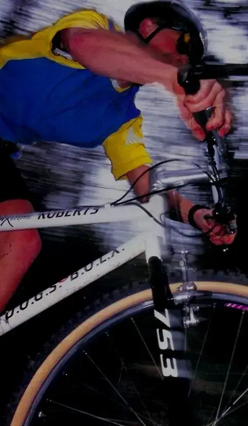

PostPosted: Sun Jan 20, 2013 2:57 pm
BoTY & PoTM Winner
BoTY & PoTM Winner
Joined: Tue Jul 13, 2010 10:19 pm
Posts: 7228
Location: KEEPING THEM SAFE FROM HARM, ANYWAY I CAN....!
correct tubing specs for above example.
Frame specs---
Ultra stiff Columbus Max main frame.
---Massive clearances to eliminate mud build up.
---Optional Roberts ForkPlay fork, Reynolds 531 fork crown internally filleted then mated to Reynolds 753 NON tapered straight blades.
To my mind, this was one of the most carefully thought out "Steel" race frames on the planet.
A benchmark to be measured by, and quickly suggested by the press at the time as the "Ultimate" in Steel.
