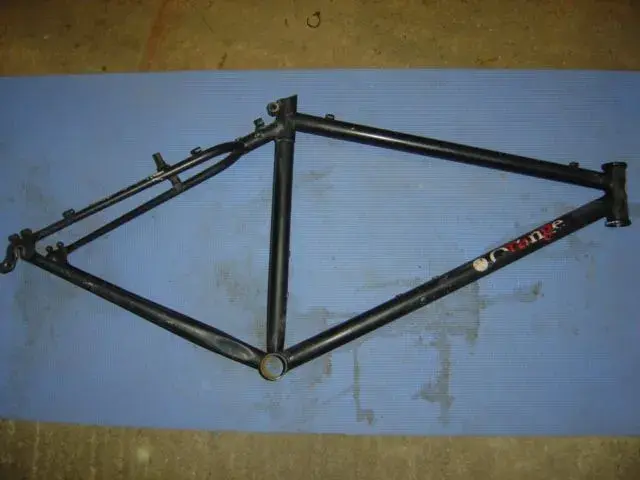

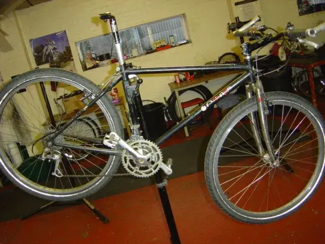

Recently I have volunteered to help out occasionally as a bike mechanic at a local recycling centre. There is BIG workshop full of donated bikes. As you can imagine, most are lemons. However, last week, whilst rummaging about amongst the lemons I came across an orange. As seen in the photo it is somewhat dishevelled. Despite my enthusing about its pedigree and talking it up the manager was happy to let me have it for only £15.
So I have now stripped it down to see what is what.
Frame: Clockwork Orange 17" (centre to top), black, no A2070215 (July 1992). BB was completely shot but came out. No obvious dings or serious rust. Cheap headset with some pitting in both cups- haven't tried removing yet.

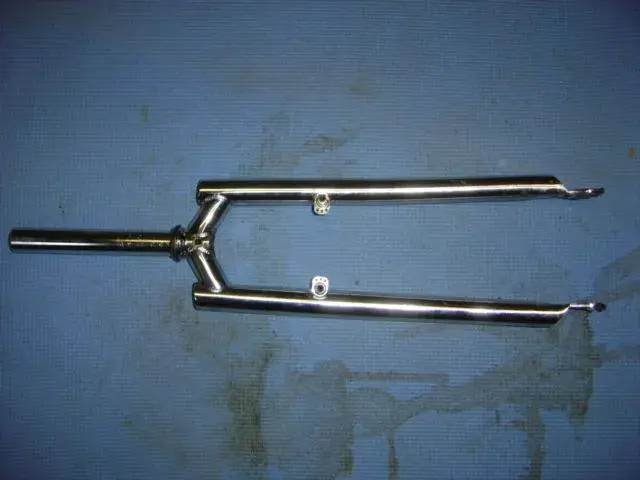

Forks: 1" Plated F7 stamped June 1996
Brakes: LX cantis, Shimano MT63 levers
Drive: Exage M300 cranks, Pace rings (46 36 24), 7 speed cassette M737
Gears: XT 735 mechs front and back, Deore shifters (one missing its lever cover)
Wheels/Hubs: Rear - Vuelta scout rim with shimano Altus CT90 hub. Front - Alex AL VP20F rim with Acera M290 hub.
Other: Dec 1996 seatpost (missing seat bracket), Acor stem, unbranded riser bar
So a bit of a mixed bag. Initially I am going to clean all the bits up thoroughly and decide what to keep. Will strip the frame bare and see what is there.

I'm not familiar with the brand so keen for any build tips.
Confused at the moment about seatpost. By all accounts it should be 26.8 but a 26.8 is a VERY tight fit - requiring a lot of twisting and damage to seatpost. A 26.6 is a nice snug fit. Not sure whether to open up the seattube top a little to try and better accommodate a 26.8, or accept is is a 26.6. Any 92 clockwork orange owner able to confirm seatpost size?

Confused at the moment about seatpost. By all accounts it should be 26.8 but a 26.6 is a VERY tight fit - requiring a lot of twisting and damage to seatpost. A 26.6 is a nice snug fit. Not sure whether to open up the seattube top a little to try and better accommodate a 26.8, or accept is is a 26.6. Any 92 clockwork orange owner able to confirm seatpost size?
Mine is a 26.6, You will find the binder may have closed up slightly so feels tighter than it should. Orange shimmed seatposts on many bikes.

Orange looks fantastic for £15!!! F7 Forks ('94 on) aren't same age as the frame (92?).
Build up as is for a fun low theft risk town bike (remove decals?) or lavish some time and get the correct fork and a period DX groupset. Forks alone would sell for more than you paid.

My current plan is to clean up all of the bits it came with, paintstrip the frame and rebuild. I am initially going to build it up low budget to see if I get on with it being a 17" frame. At 5ft 10" I would have preferred a 19" frame.
Bits to source: 26.6 seatpost, 68x122 BB
Damaged but probably useable bits: rear mech, left brake lever, left thumbie

i like the forks! £15? can't be bad at that price,good luck with the project.
