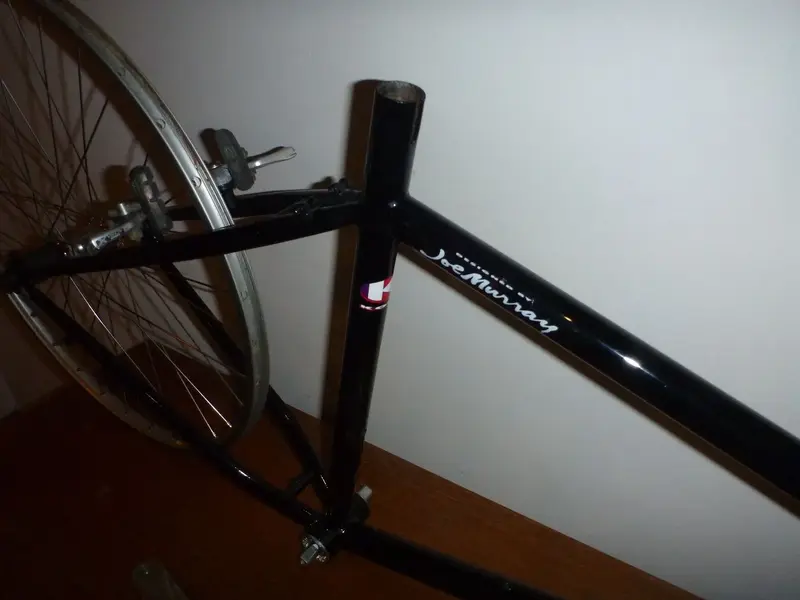

Thanks Spanky, I can crack on with seat post order now. She was black before resto and I have a couple of litres of toyota solid black 2K left over so no brainer, black she is with clear coat on the tubes bearing decals only. Seem to be able to get an excellent finish straight out of the gun on bike resprays, compared to the handfull of car resprays I have carried out, which more often than not needed arduous flatting and polishing is an absolute result. :D. Hoping to set up a spray booth with extraction and heating. Watch out Argos??? appologies for bad light on pics.
