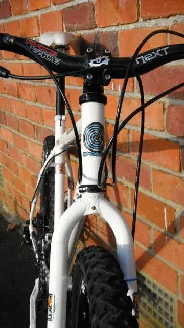

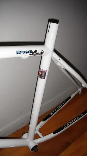

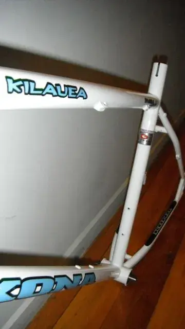

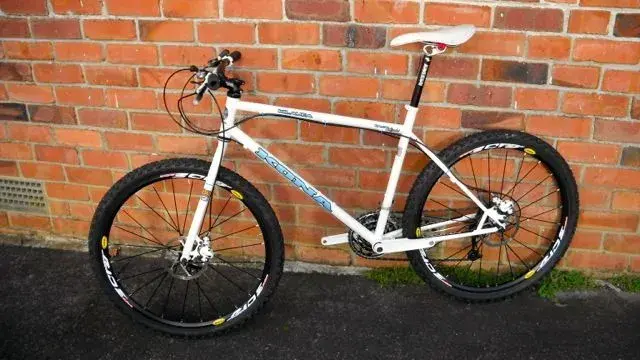

So I finally after a couple of years thinking about it and a few secrets kept from wifey - finished the upgrade and restore of my beloved ex-racer, the Kona Kilauea 1996. It was never the best bike out there, but when I got it at 18 it was the best I could afford and it carried me some miles both racing and recreation.
So here are some pictures of the kona having a new breath of life. Some of the bits are original, some are modern, but all in all what I have now is a sweet trail bike that is in my mind as nice as anything that i could have bought new yet features a lovely columbus steel frame :)

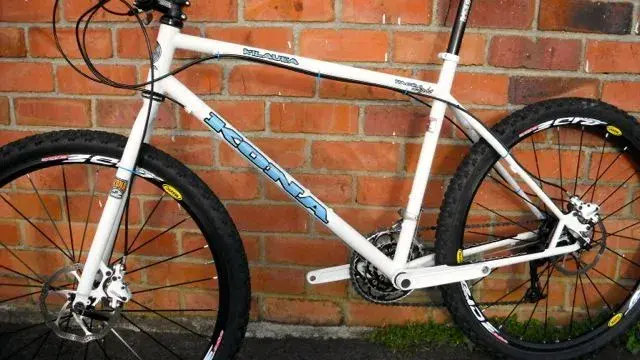

The frame had a tiny crack on the rear brake posts - had been there for 10 years and never got worse, but I fancied a disk upgrade so I had Jeff from Kiwi Bikes in Rotorua, NZ do some work: http://www.kiwibikes.co.nz/
--The project two forks got a threadless steerer conversion
--Also disk mounts
--Rear disk mount also added
--Single speed Jeff asked - No!
--Also cable routing mounts added for the full length hydraulic cables
Following the frame work, off to Pro Coat in East Tamaki, Auckland, NZ (http://www.procoat.co.nz) for I think three coats of powder. White, then the stickers added. Then pearl over the top, then finally clear. Yes, you can powder coat over stickers! Result is exactly what I had hoped, white pearl with clear coat. Never dreamed this could be done with powder but hey!

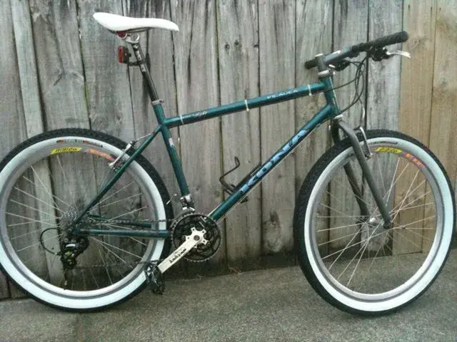

Good point - i do have this one from maybe two years ago when i put cruiser tires on it for commuting...

I tend to agree with your photo caption, where it says "Front and rear risks and new cable routing added"!
The rear risk should be ok as the restorer has added a brace, but I would think the P2 was certainly a risk. When Kona modified the design for a disc tab, they made it a much more heavy duty fork. I'm not sure they ever had a butted version for discs, certainly not for the years I am aware of. Your P2 is quite thin metal down near the dropouts and it will have been weakened further by the new welding/brazing. I wouldn't use it. Why not fit a nice 80mm suspension fork to go with your nice bar/stem combo? There are SIDs around in white.
I don't think you can have a pearlescent finish over the decals. The pearlescent element is surely granules in the top powder coat - normally powder is applied in one coat only, so perhaps multiple coats is the way to achieve this finish? Then they might have done a clear coat over the decals. The decals look quite good incidentally, did you have them made specially?
