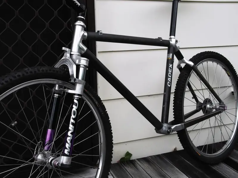

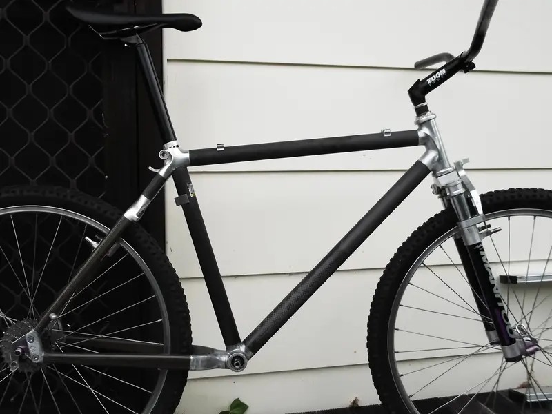

Righty. I bought the frame from Trademe (A New Zealand auction website) and have started collecting various parts and what not to build the bike I was riding back in 1991.
I've scored a couple of new bits since the pic was taken + early 90's XT shifters, etc. but this is where I am now.
I stripped the pearl paint from the frame and have started the re-laquering, polishing the lugs, new decals etc to make the old girl really shine.
The manitou2's are somthing I bought from a really helpful guy here in NZ named Andrew. I grabbed the 2's and some Manitou Sports from him and canibilised the Sports internals for the elastomers and the coil spring.
It took a little work but the 2's are back together after the sticky mess was dealt with.
A wee tip. Once you manage to remove all the sticky gloop from your Manitou forks, drop everything into a large jar of acetone. It won't disolve anything usefull, but it will get rid of everything sticky and useless.

I bought a new box of blades and gently scraped the paint off along the length of the tubes then sanded the tubes with 3m spongy sanding pads (superfine wet).
I use airbrushes and have access to booths everyday at work but I have found Plasticoat Superclear laquer in an aerosol to work pretty well.
I've sanded the laquer with 1500 wet to get rid of the orange peel and then I polished it with toothepaste and a wet cloth.
The pics at the moment are pre laquer, but I'm really pleased with the results from using the toothpaste (which I didn't expect).
I'll post some new pics soon.
I didn't need to use such a `number 8 wire' technique (due to the resources available to me) but simpler seemed to work better after some testing.
