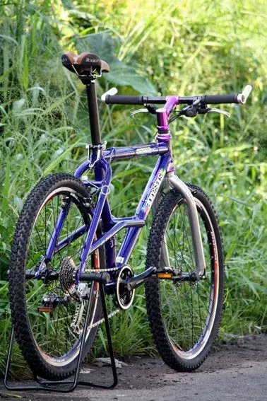

And here is my aplinestar almega DX:

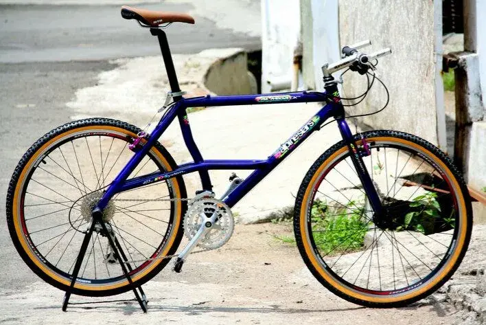

Just got crank, stem, and fork.. :)

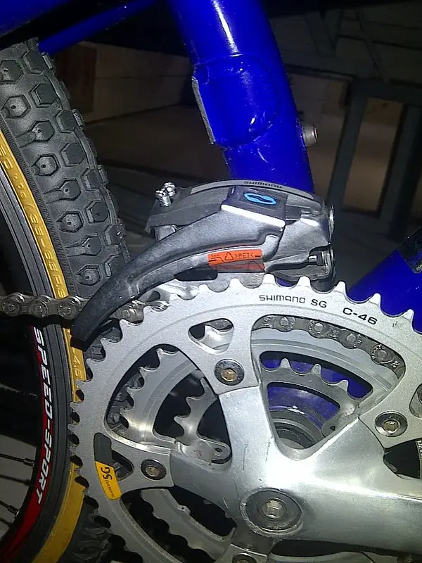

please help, the FD hanger at my cromega were crack on delivery when i buy it, so i just cut it in order to make it cleanly...
now i use ACERA fd, but the problem is it can only shift at the biggest and middle chainring.
Should I grind the rest of FD hanger on seat tube? what kind of FD that can fit on my LX crank? (downpull, clamp 34.9)
PostPosted: Sat Nov 24, 2012 1:09 pm
Joined: Fri Jul 23, 2010 4:13 pm
Posts: 4873
Location: Royal Forest of Dean (Still looking for the Bear !)
Hi Mr Kingcab
I've been following your thread for a while now and note that you've recently replaced your cranks ?
Personally I think your problem is due to the axle in your bottom being to long for your current cranks
best thing to do is remove your cranks and measure the Axle length and then check out the site below to see what the recommended lenght is
At a guess (and thats all it is) I think you should have an axel around 110mm long..
It is a common problem... enough for Sheldon to have a whole website dedicated to it.
http://sheldonbrown.com/bbsize.html
b.t.w Thumbs up for the changes you've made. :P
Hope this helps, If I'm talking boll0cks then I'm sure someone will flame me pretty quickly
