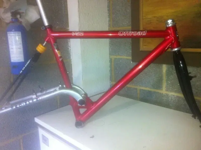

so i picked up this little beastie from Ebay, i used to have the 552, same frame but in blue so when i saw this i contacted the seller and asked a few questions, all answers seemed positive with the exception that he didn't have the rear brake cable rocker assembly.
having now received the frame and both forks i can see it's all in pretty good condition for 20 years old although the rear mech hanger is slightly bent but not so bad that a bit of a tweak won't sort it out.
first impressions are that it weighs a tonne! :lol: and i'll definitely need some new elastomers but i think i know where i can get some so that's ok.
haven't decided which fork i'll use yet but i like the idea of the original rigid fork, and before you ask drystonepaul has first refusal on the suspension fork, but being honest i don't even know what the fork is! early marzocchi i assume
anyway, here's the initial pics :D

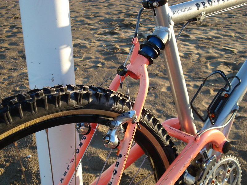

Well, here they are
They are the LT model. In my case the medium hardness (blue). There are 4 different. I bought them here:http://www.chainreactioncycles.com/Models.aspx?ModelID=11272
and here: http://www.wiggle.co.uk/es/elastomero-para-tijas-de-sillin-cane-creek-thodbuster-lt/.
You must make bigger the orifice. I drilled them until getting 12mm of diameter. Then I made them shorter. I don't remember the longitude, but you can use the same size of the broken ones.
If you get the black ones there will be practically identical to the originals.

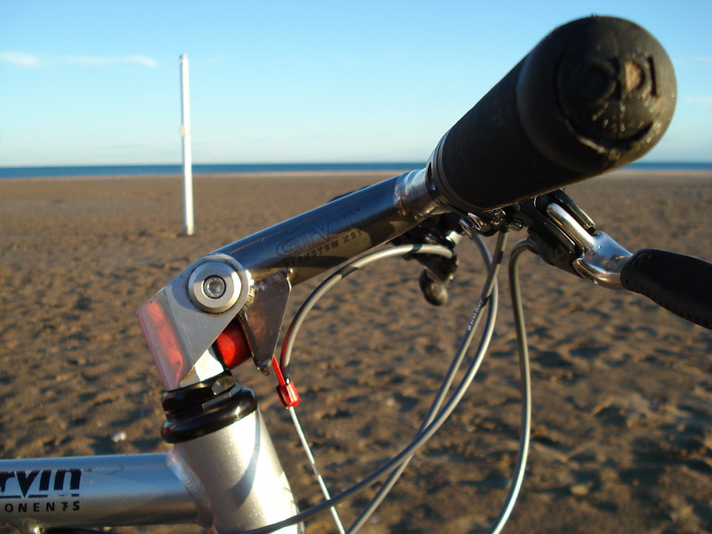

I prefer the original fork with a ti XST flexstem like this:
(yes, it's mine)
Or if you get a black one it will be nice too
