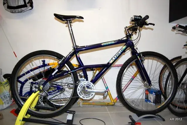

Here is a pick of my TLC to this A* Almega DX 92. New seat, post 2 front chainrings, XT front mech from ebay and 3 hours of a saturday fixing the front STI shifter which was out of action. Front mech now does not slip!
