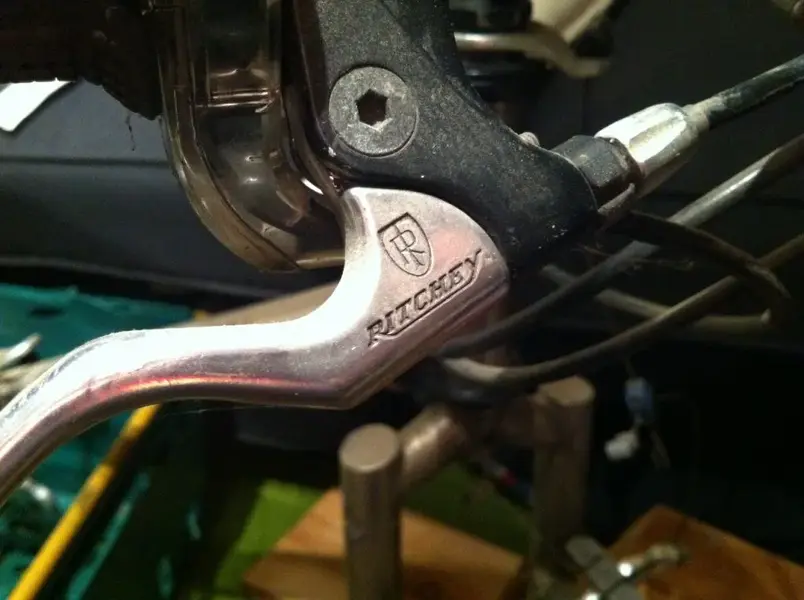

OK here are some pics I took last night in the shed.
File comment: Brakes

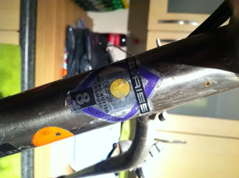

File comment: Decals 2

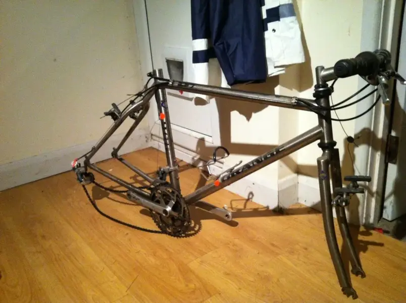

File comment: Frame, Forks and Bars

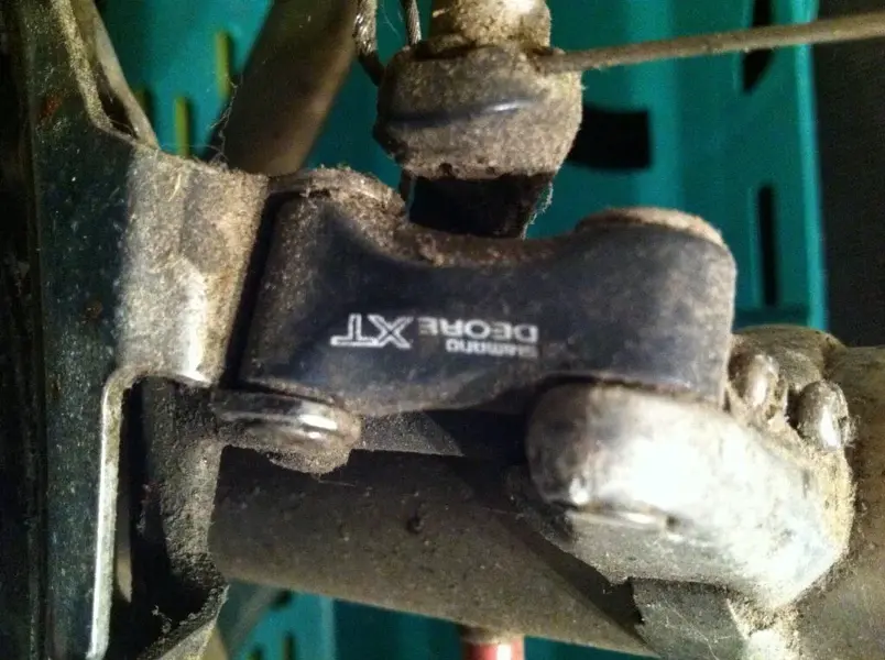

File comment: XT Front Mech

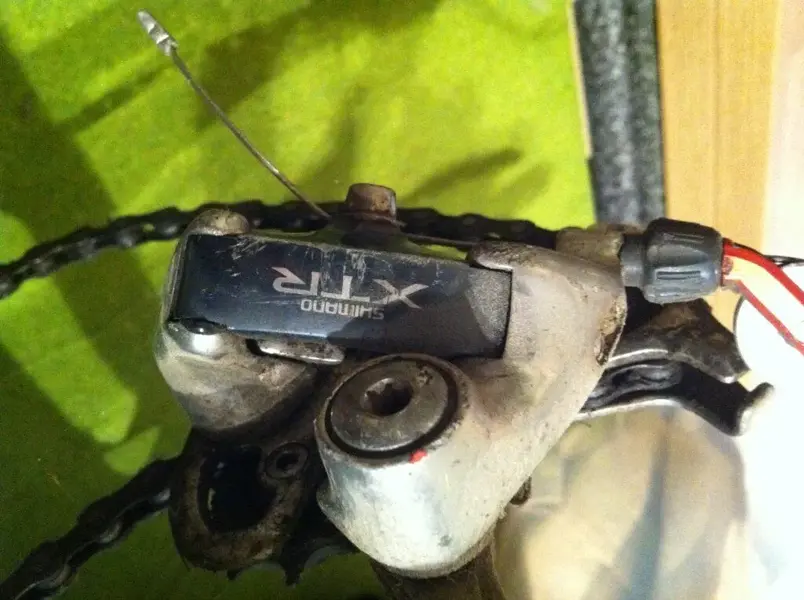

File comment: XTR rear mech

This is cool.
This may (I stress may) only need a good clean and lube, and cables plus chain replacing. Looks like the frame is in pretty good nick. Cleaning dérailleurs and brakes (remove if needed to do a good job) plus sorting the cables will go a long way to seeing this working again. Think I can see a grease guard headset there, so new injection of grease may be all thats needed there. I'd remove the chainset and do a real good job on that before seeing if the teeth on the rings are too worn or not. Think I'd probably get the bottom bracket removed and maybe replaced to be sure its not stuck and a hidden problem for the future.
What are the wheels like ?

p.s. looks like rear mech needs new jockey wheels as a minimum
