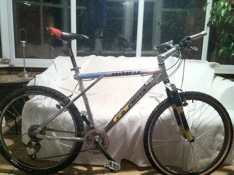

The donor frame was a 97, with some scratches and one small dent, but on the whole a tidy example. I bought it as a whole bike and came fitted with a lot of XTR M950 components but I wanted to replace most as they didn’t fit in with my plans.
I will be reusing the Mavic X618 on XTR M950 hubs, XTR M960 Front mech and Kore Seat post. Everything else will be changed.
Have a set of Pace RC36 Evo forks (returned as they had been physically altered dimensionally by previous owner, dumbass!!) already to fit and also just bought a very tidy 2011 Raceface Evolve XC Crank and chain ring set that will be tweaked slightly. More on that when complete.

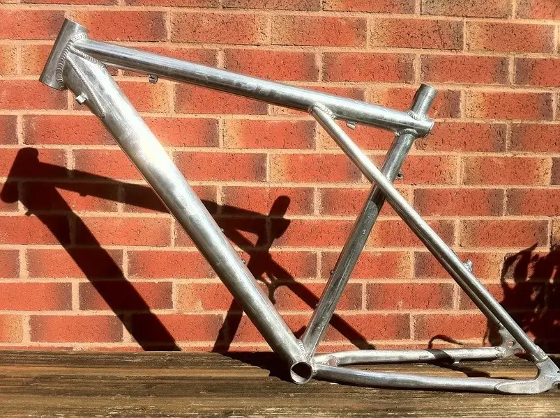

Pictures of bike as received when I got it home and few days later after strip and sticker removal. Sorry to rape your bike Tony ;-(

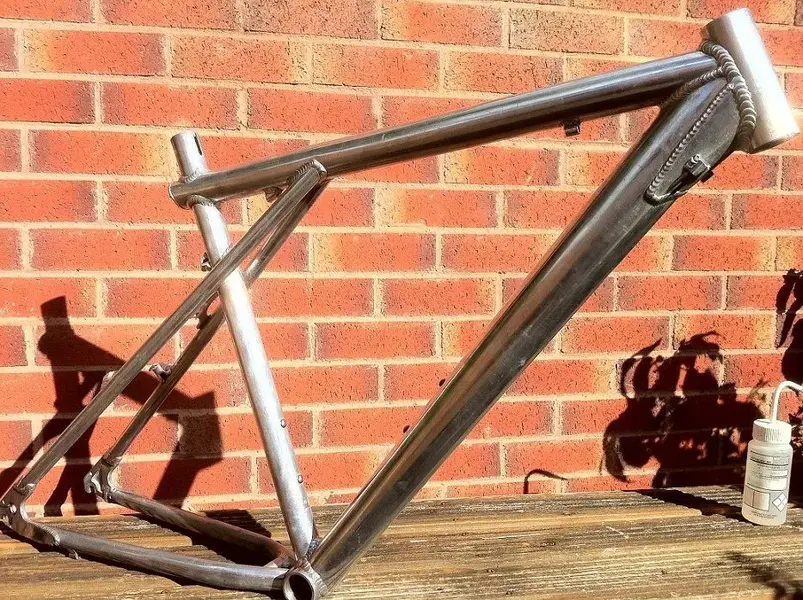

Frame is now being readied for a dam good polishing. Almost finished an initial light rub over of the worst marks with 400 paper. Full 600 and 1200 on the weekend and maybe first polish if I have time.

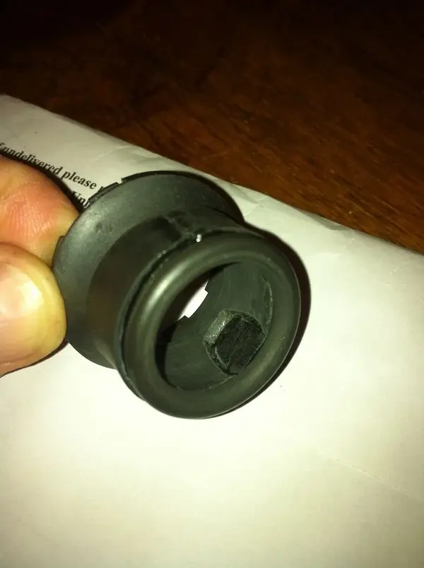

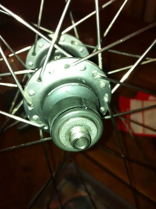

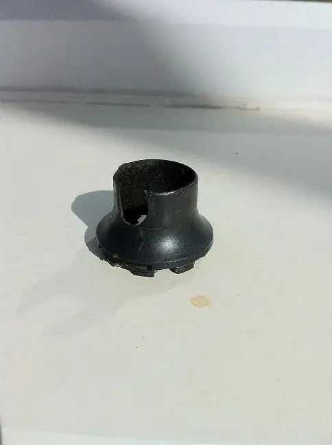

Posted a few days back looking out for a hub dust cap as mine had a hole init. No responces so thought of a way to repair it. Hopefully I can get a replacement one day, but this will last well I think.
Basically neatly cut a piece of rubber to size and stuck it down, then stuck an O ring on the face. I had to sand it internally slightly so it allowed spindle to spin freely. Also sanded down th ejoin to make it less noticeable. Wasnt sure how else to save the day but seems to have been succesful :idea:

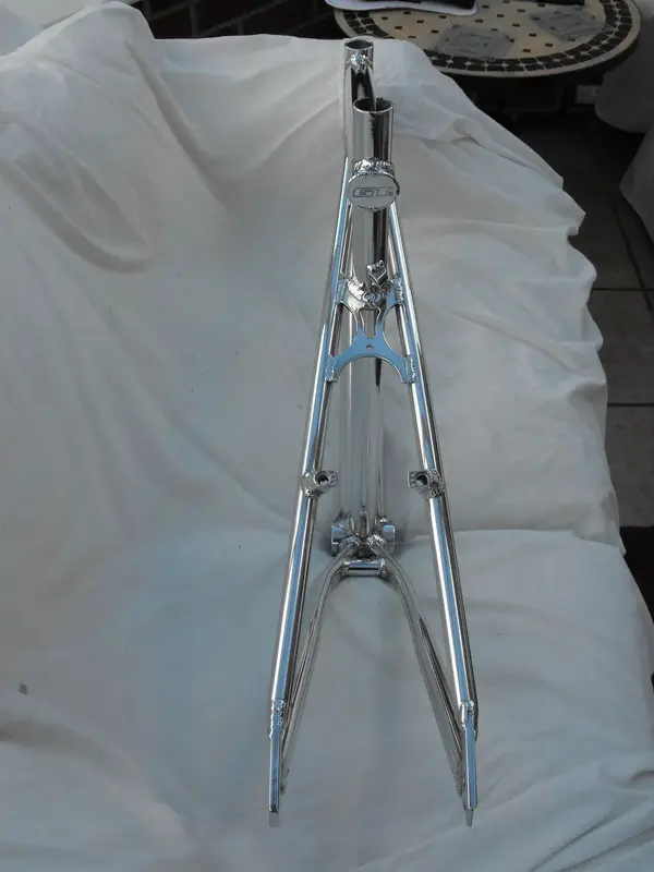

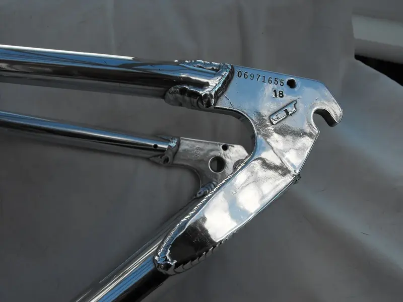

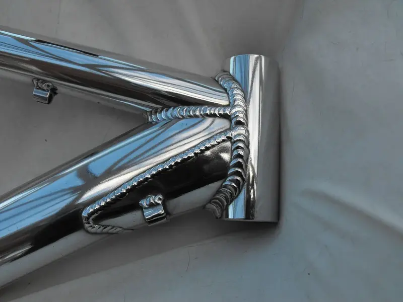

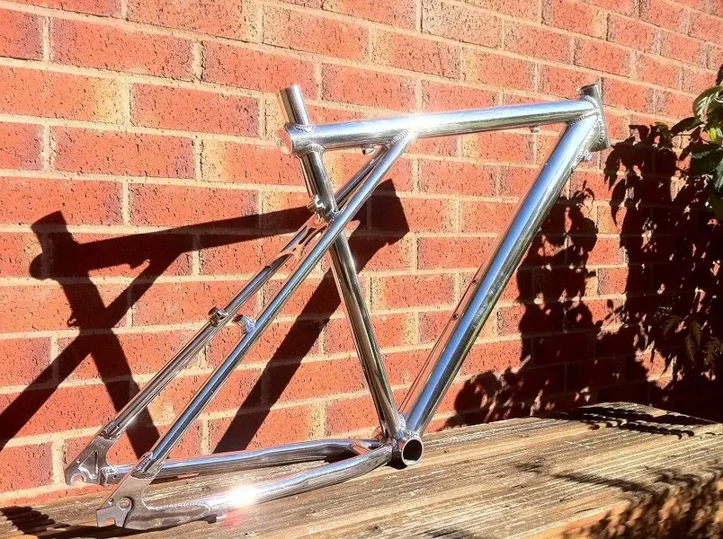

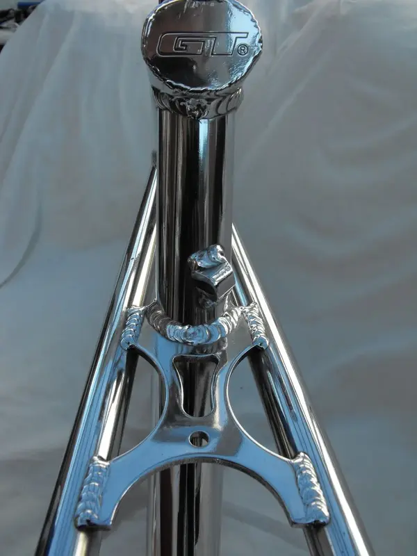

So been a busy boy this weekend. Last week frame was all drab after the wet 'n' dry and wire wool treatment. Then this weekend went crazy with the Peek!
I have left the deeper marks as don't want to go thinning the tube down too much plus it looks kinda cool I think, bit of battle damage.
Still undecided about decals, despite being a 97, I really like the 92 versions with a slight colour change to suit the scheme I'm going for. If any decals at all? Decisions!!
Enjoy
