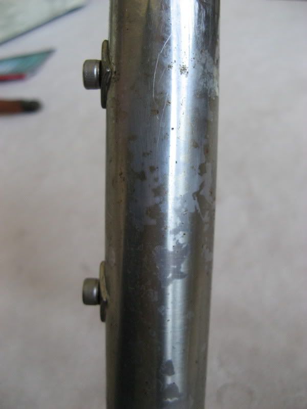

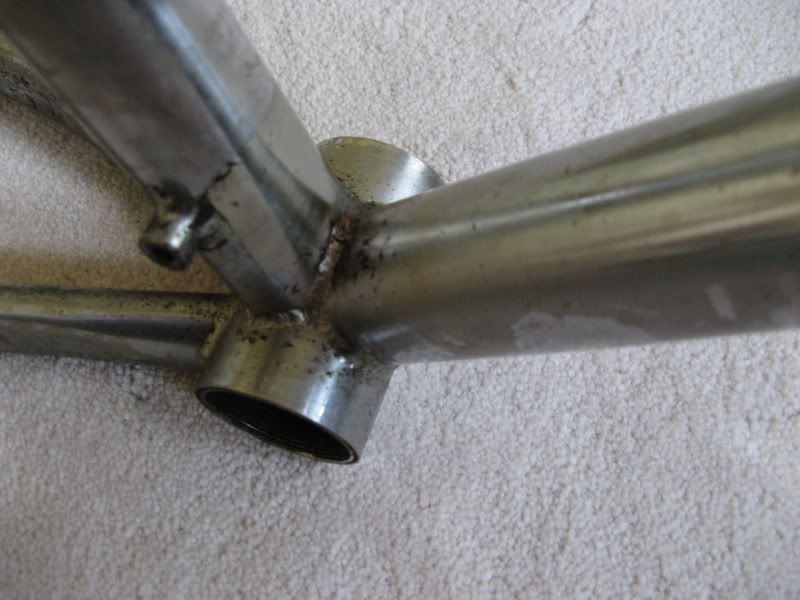

Unfortunatley, it turned out to be a bit of a dog. I wasn't expecting much but everything seemed to go wrong with this. The finish was pretty bad with rust spots everywhere, a big dent in the down tube near the bottom bracket, a small crack in the weld where the brakes bosses are welded on (discovered later when stripping the frame) and worst of all a nasty repair job on a crack on the driveside chainstay near the drop out which it seems the previous owner tried to disguise by painting the dropouts black on each side :twisted: As a result of this the mech hanger wasn't straight so you couldn't get the gears to shift nicely across the range. It as just about rideable but to add insult to injury the cranks fell off while I was riding it home. I had to push it home and got heckled by a roadie while going up a hill - I guess he thought I was beign a lazy MTBer but I was tempted to throw the offending crank arm at him!

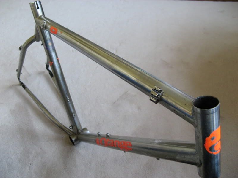

Some pics of the frame to begin with

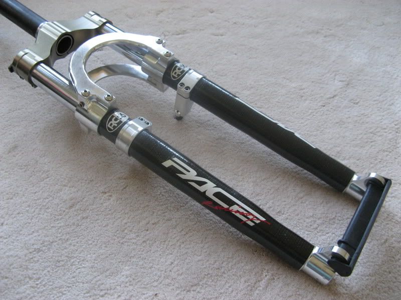

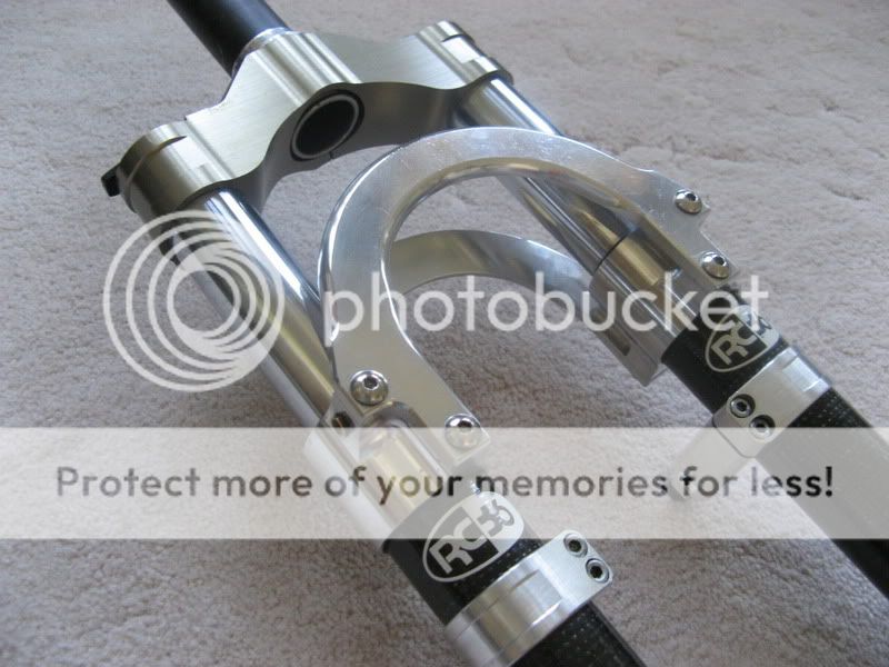

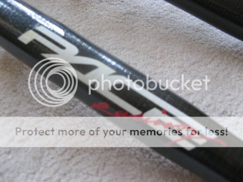

Up front I already had a lovely Pace RC36 that had apparently just been serviced by Tim at Fork English just before I got it. I've given the metal parts a good polish and fitted new decals from Pace. Had to get a 1" steerer and shim from Tim too - top guy, very helpful, knowledgeable and friendly. Cheers Tim!

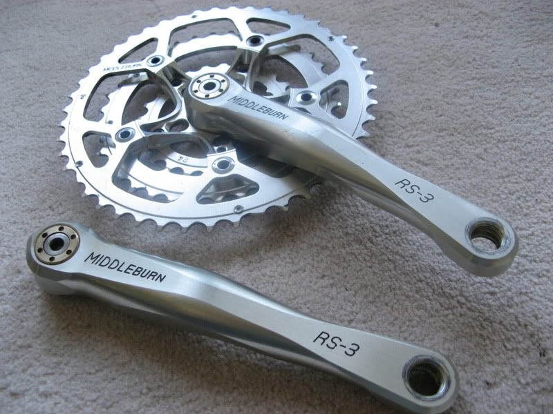

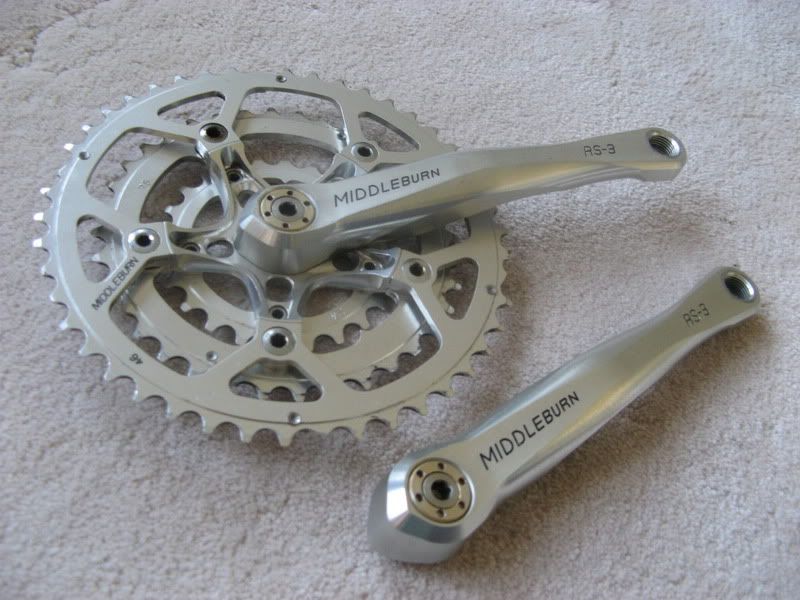

Cranks will be Middleburn RS3s

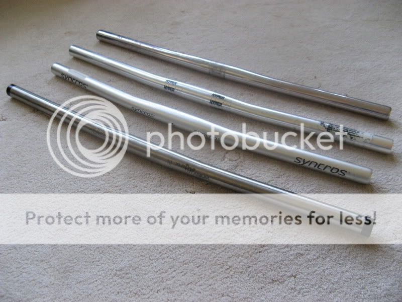

Was considering a variety of bars but will go for a lovely X-Lite XLR ti, front

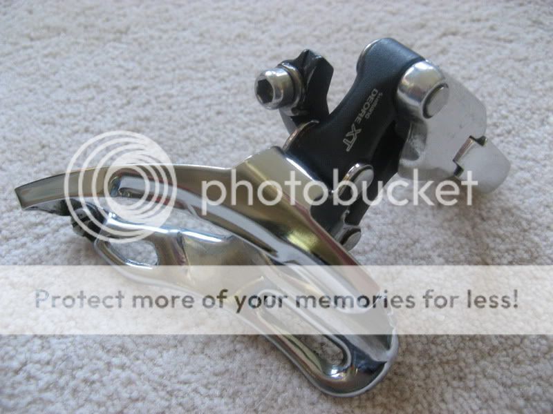

Rest of the drivetrain (STIs, mechs and brakes) will be near mint M739 XT, probably my favourite group

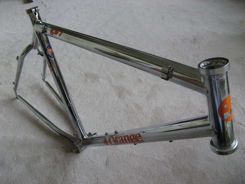

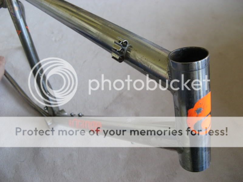

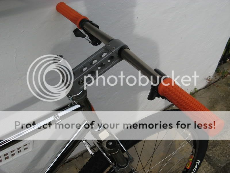

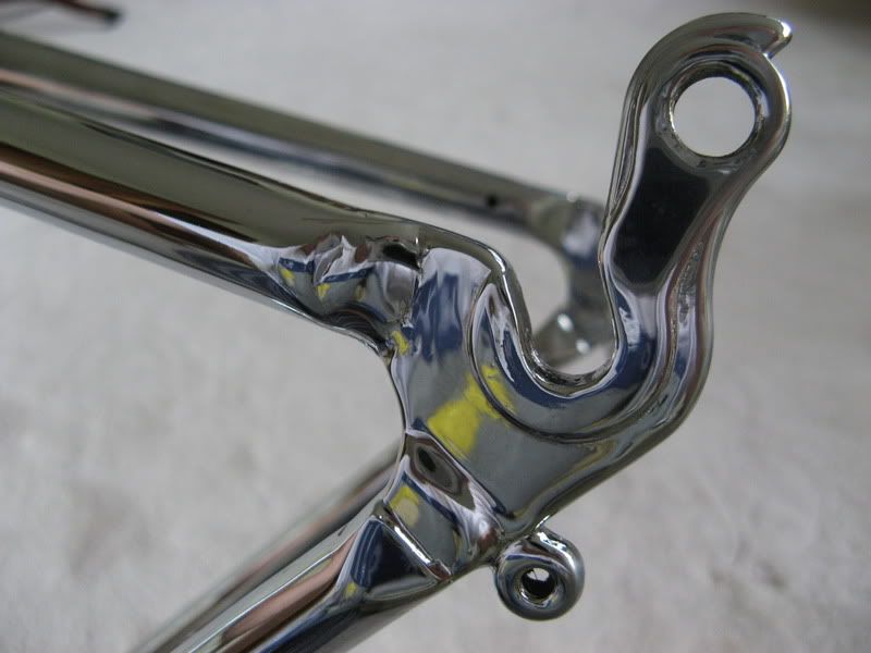

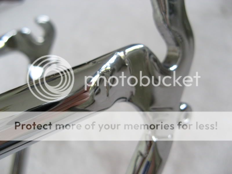

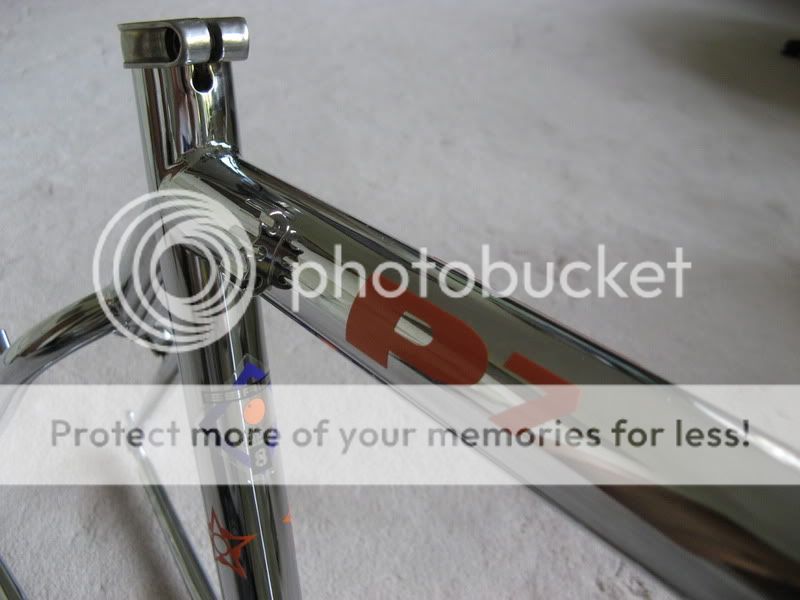

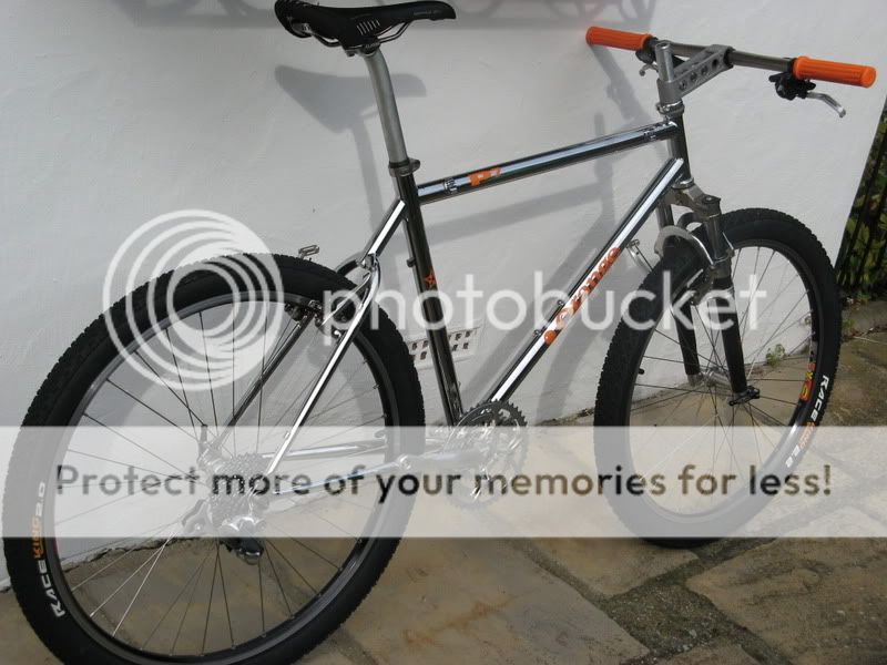

Got the frame back from the electro-platers and its turned out pretty well I think - not perfect but pretty good considering the state it was in.

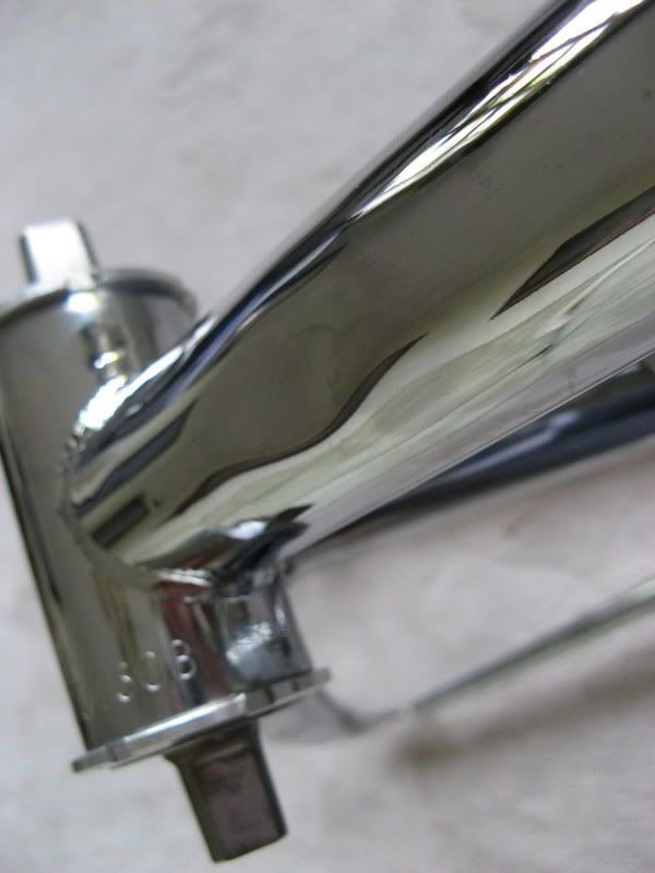

The dent in the downtube had been filled. The filler would come out in the plating process and make a mess so it was removed beforehand and the dent pulled out as far as possible
This is the cleaned up repair in the chainstay

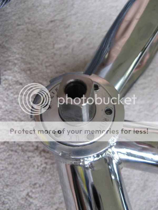

Royce ti BB 8)

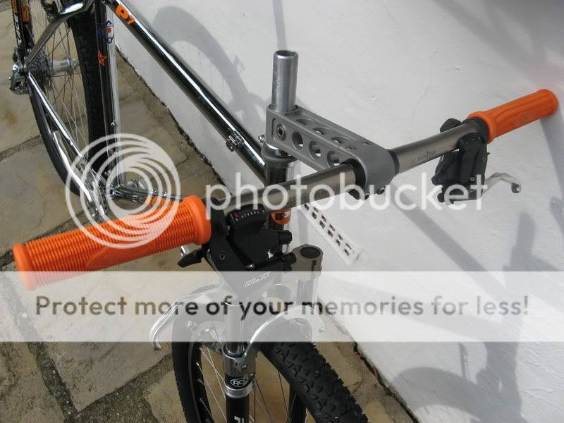

X-Lite finishing kit
Wheels are silver Hopes on black 517s with black Hope skewers

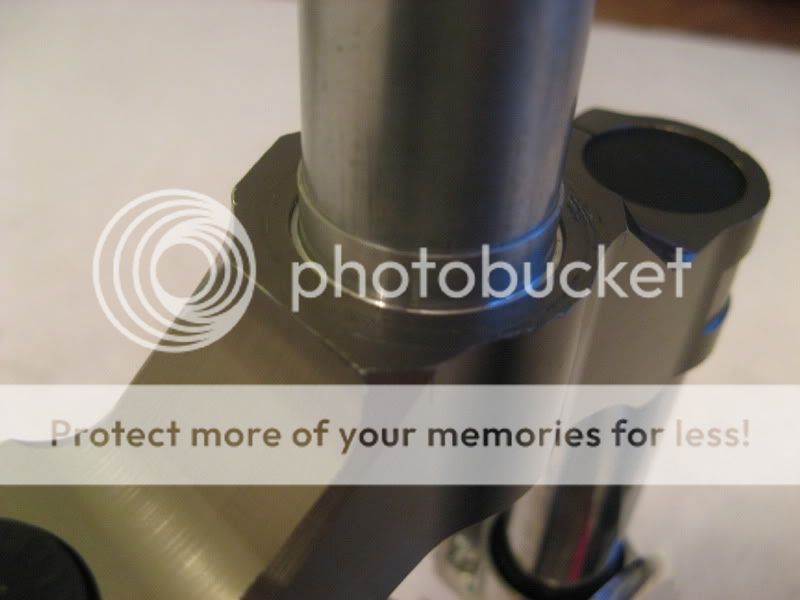

I still need a few bits before I can finish the build. I need a larger band front mech, shim for the seatpost and I need to sort the crown race. With a new 1" steerer and shim the crown race isn't fitting snuggly even though the shim has a step that is meant to accomodate it. Not sure if I've missed something :?

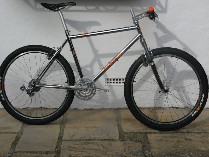

Until then, some mock-up photos. The seatpost is temporary until I get a shim for the X-lite XLR, and the saddle and tyres will probably go for something more retro. Not sure if the stem suits the stem suits this build either now its fitted.
