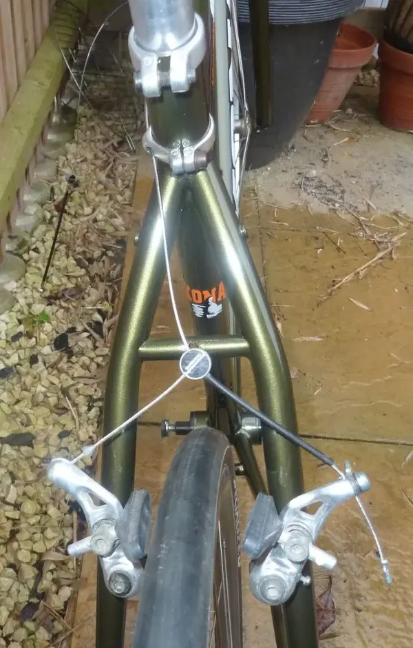

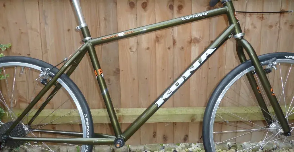

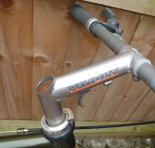

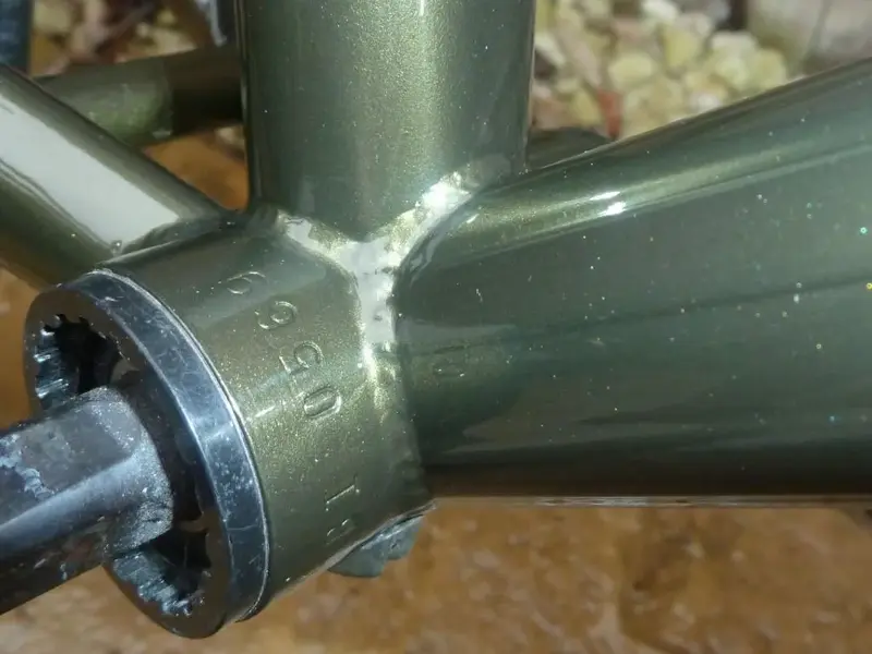

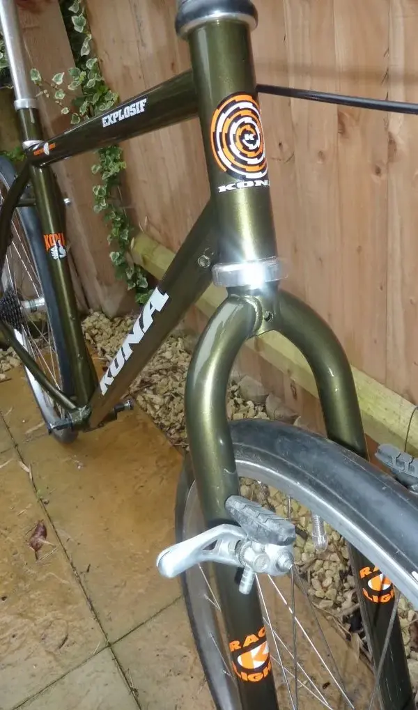

Photos:
Love the one of the BB area showing the "ribbed" down tube.
