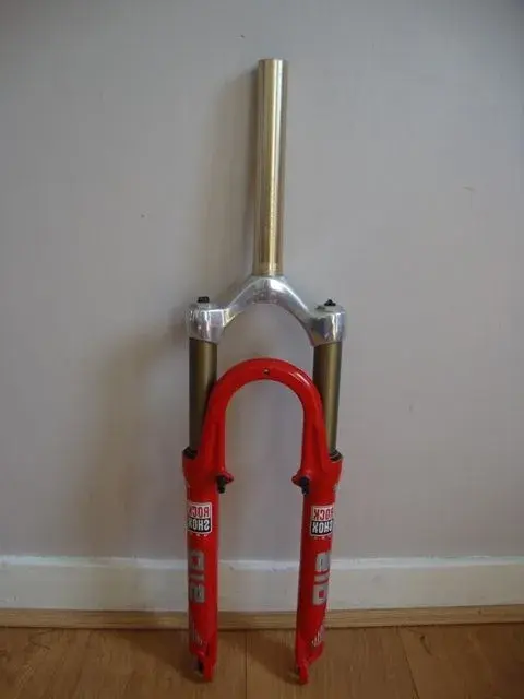

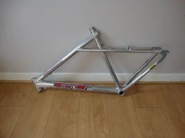

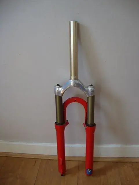

I bought this frame on ebay at the weekend and bought the forks to. I'm now looking for ideas for the rest of the build.
And information on the best way to polish the frame

Check out bikepedia for parts specs and the GT catalogue for how it used to look.
Also, there's a fair few Zaskar builds on here if you're looking for ideas.
Autosol metal polish.
On the scratches use 1500 wet & dry, then 2000. Keep it wet. Then Autosol to mirror finish.

I'm doing up a 97 Zaskar at the mo and found that fine wire wool is excellent for cleaning up the welds.
I actually went over entire frame after the wet 'n' dry in prep for polishing with it, which is going to take place this weekend. Progress pics coming soom :wink:

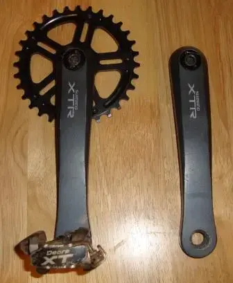

Going for xtr 950 group set as I have wheels and cranks.

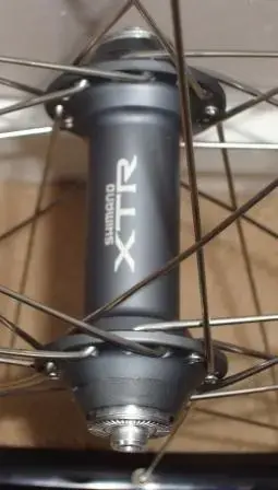

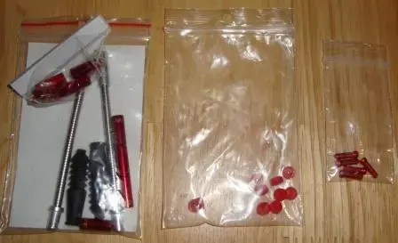

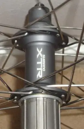

A few more bits for the build
