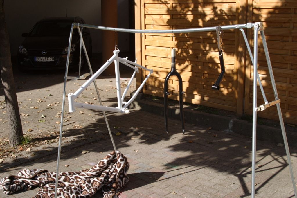

A few months ago I bought an 89-90 Rockhopper frame/fork and sat on it for a while. With her B-Day coming the end of October, I decided to have some fun and throw something together.
Mind you I used what I had 'lying' around, however I did buy some stuff....

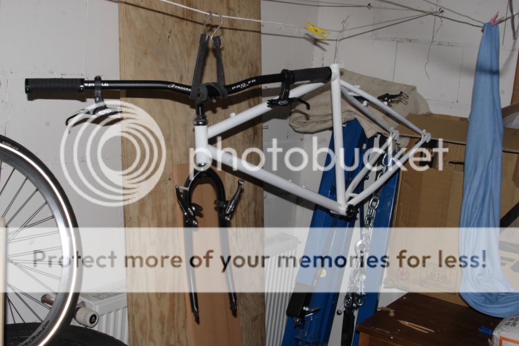

Yesterday:
This morning:
More pics to come....

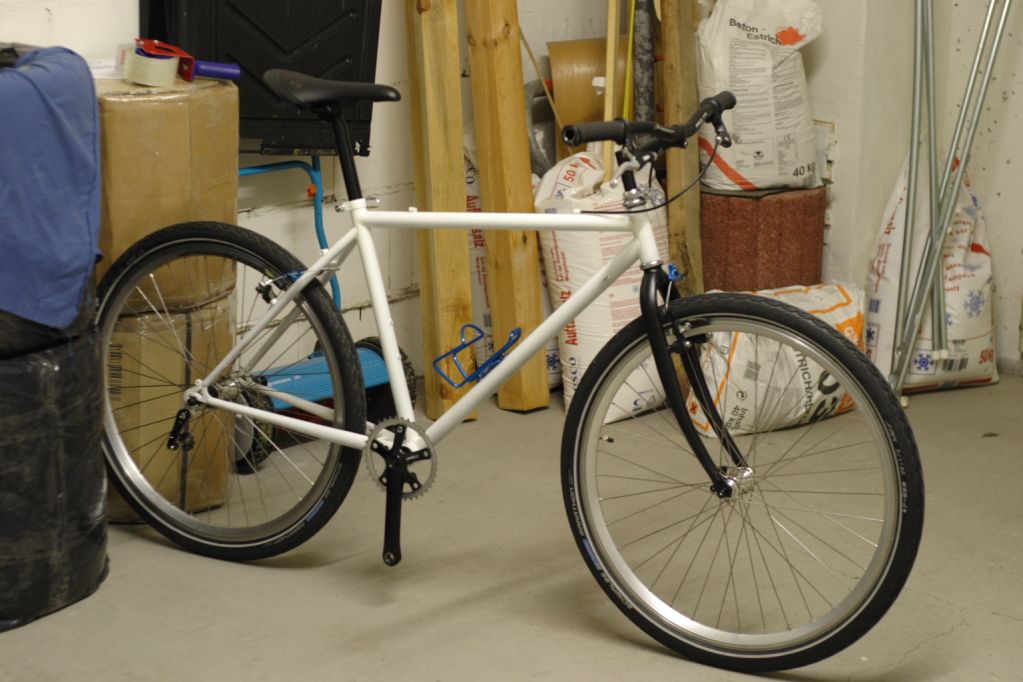

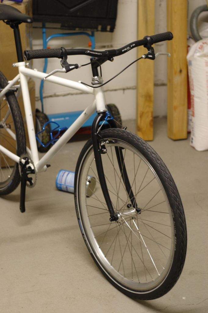

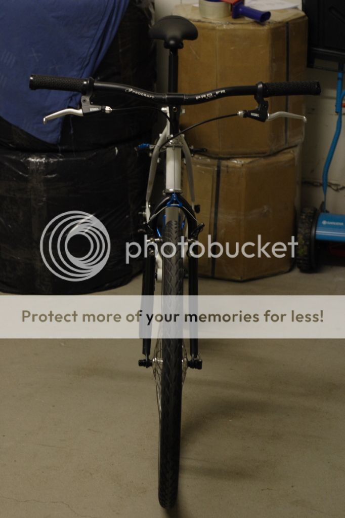

As it sits right now:
Swapped the Avid SD5's as I will be using them on my other project bike. Threw on a decent set of LX canti's I had lying around doing nothing, with some DiaCompe PC7 levers.
I soon thereafter realized that this frame has no rear canti-bridge.
I'll probably mockup something to hang from the seattube QR.
I'll have to make some spacers for the chainring. The chainline blows and i'm not putting in a new BB.
