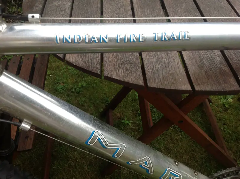

I first off want to get the aluminium back up to a good look (concourse if I could!) but need some advice. I've so far taken off one of the very manky condition IFT graphics - which I will replace later with vinyl if need be - and have started on bits of the frame with Autosol metal polish. It's certainly brightened up a bit, but is bloody hard work and still isn't producing what I'm after.

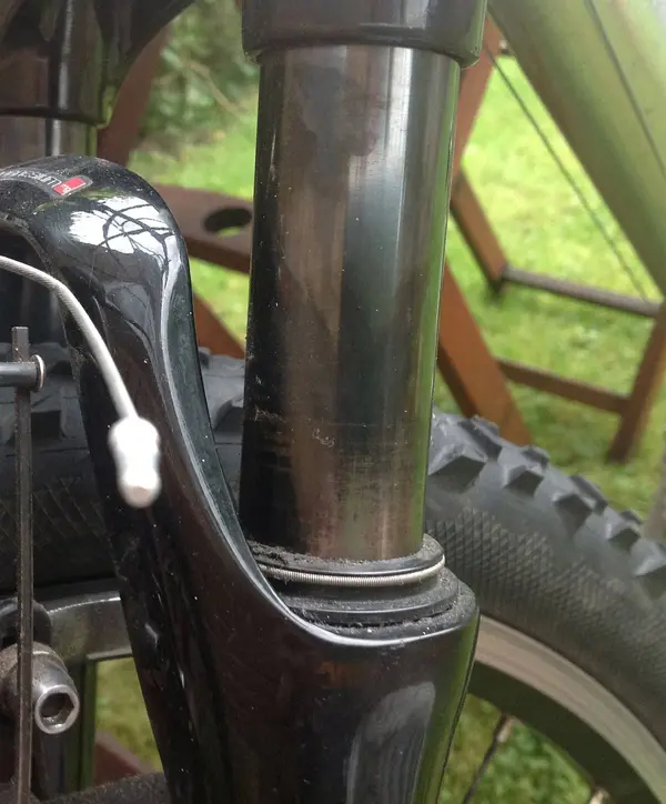

File comment: Are these Suntours knackered?
File comment: The pitting on the frame

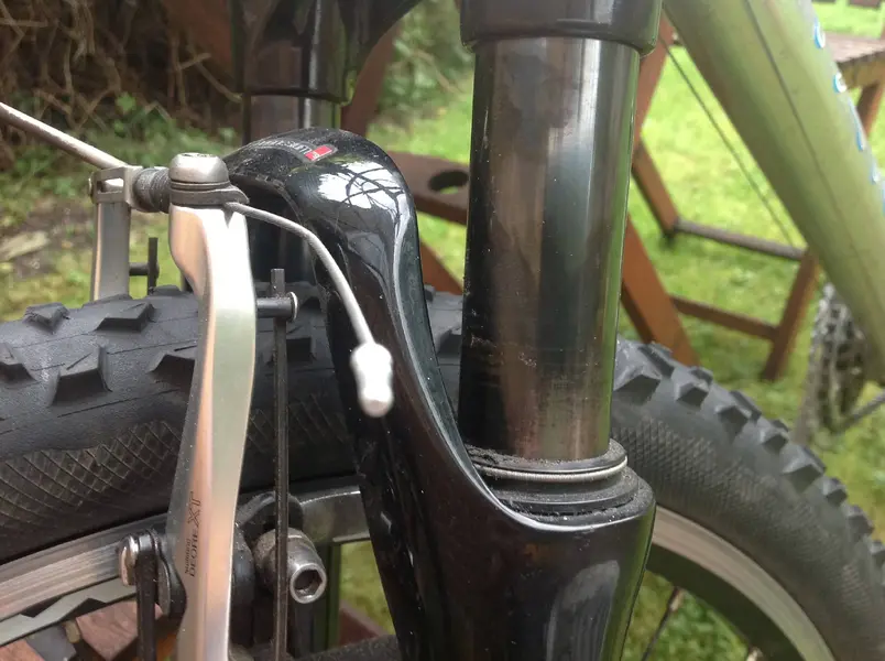

Hopefully a better picture of the shocks. The local bike shop say the shocks are on their way out due to the pitting. Any thoughts?
File comment: The possibly knackered Suntours

The good news is, no cracks at all. I thankfully looked on here before I bought it, so you guys have given me one good bit of advice already! :)
Probably asking my first newbie question, but how do you get through the lacquer and then what do you do? I know a good car bodywork person if that would do me any favours?!

Dude i have one of the ones you had originally and it shines like a good un... What you need to do is brush some nitromors on it and leave it a few minutes and then scrape the gooey lacquer off, be careful it using a metal scraper to avoid deep scratches but the lacquer's not that thick so comes off easy. Then hit it with the Autosol to bring out the gleaming shine 8) Perhaps give gil_m a message recarding new decals and the jobs done.

Do I use Nitromors on the decals area to scrape the decal's lacquer off, or on the whole bike and scrape ultimately all the bikes lacquer off? If it's the latter, do I then need to get it re-lacquered?
I've so far very carefully removed the right hand side IFT logos with a Stanley blade. It's more shiny beneath where the decal was, but then I'd expect that as it's protected from the elements more.
The Autosol is "improving" it for sure, but the result is minor and slow.

I used Nitromors to remove all the lacquer, it was a labour of love and besides i did it during work time :D I personally didn't relacquer because it's not too much of a chore to keep shiny but i read on a thread the other day that some guys use some sort of wax or alloy wheel protection spray?
