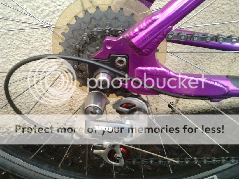

Everything was in good condition, apart from the freehub which slips intermittently. It's a Suntour XC Pro, I'm assuming the micro drive version as it doesn't have a lockring.
Are the freehubs user servicable? Or easy to get hold of and replace?

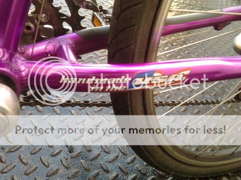

Any ideas on year? The dropout seems to indicate 1993.

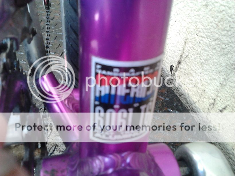

Congratulations and check the S/N under the BB first ;)

cool! he has a good uncle, that is for sure!
is the serial has a '93" in it yep, that means it was fabricated then. the two digits before indicate the month.
I doubt it's the freehub slipping, far more likely is an old chain and cassette that have stretched and worn too much.

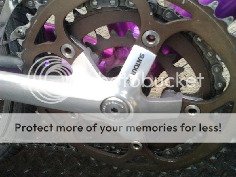

It's not micro drive, it's standard size judging by the rear dérailleur (long arm) and crank (110bcd). Suntour doesn't use lockrings, the final cog acts as the lockring, although it could even be a freewheel not a cassette.
Photo the rear hub out of the frame so we can see.

It's not the chain slipping Pete, it's the freehub not engaging. You pedal forward, the cranks spin but the wheel doesn't & the freehub/cassette turns. Then it works fine again for a bit, plus it does it when the bikes stationary.
I think I'll just try to double chainwhip the cassette off, remove the axle & freehub then see if I can flush it through. Hopefully it's just dried up grease like inside the brakes & shifters.

The serial starts 0293 so Feb 93.

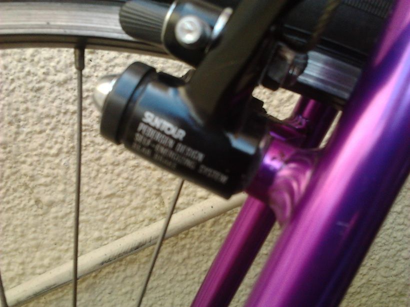

The self energizing brakes had me stumped for a bit as one side had loads of tension, the other side none. Realized they slide down on themselves & one side had seized, sorted that & they work now.

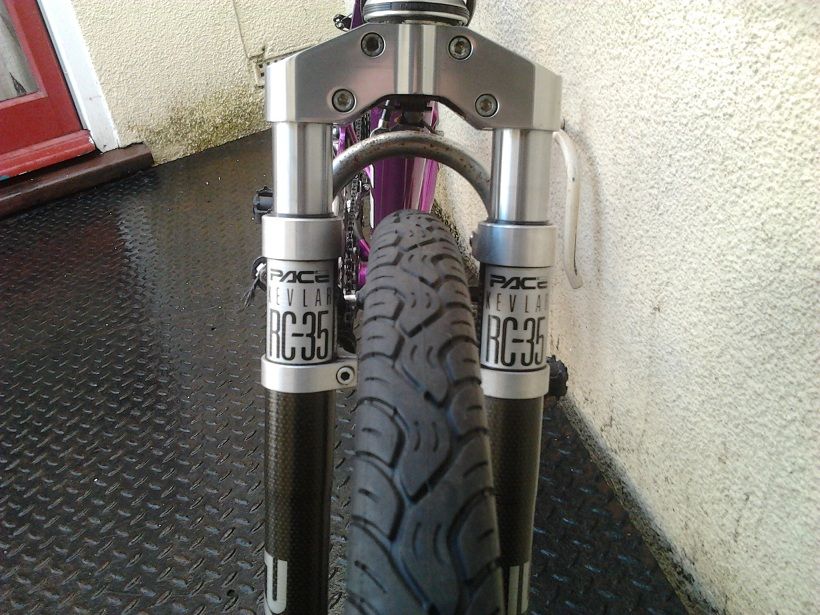

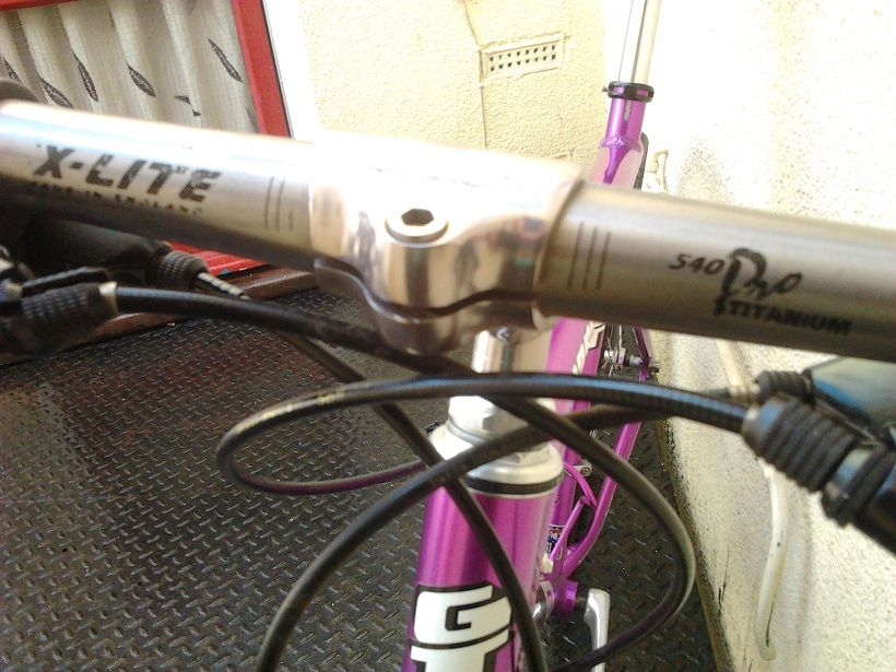

The Pace forks still work & rebound back, stem seems Ti like the bars but the welding is not too neat on it, campagnolo hs again was fine with a bit of grease.
I think I'll put some off road tyres on it, take the bar ends off & put a decent saddle on. Then take a couple of pics before I give it back to him.
