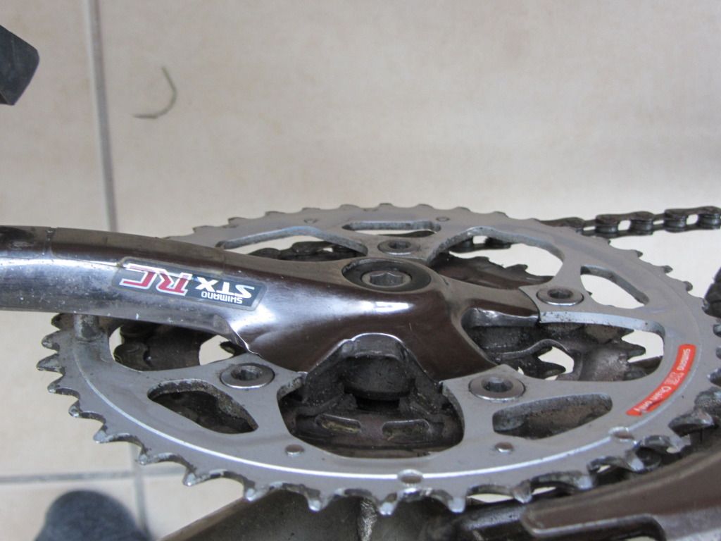

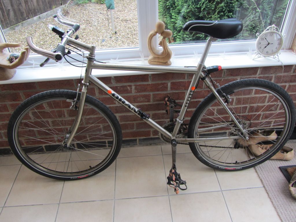

Hi all, really great forum here I've been browsing for info of similar bikes to mine, but not really found one with similar logo's etc. so can you help!!
I acquired this in a trade for some guitar fx about 5 years ago and shamefully I've been out on it only a handful of times since. Its sat in the shed and made me feel guilty everytime I see it as it's such a great bike. I've decided to avoid my wife's complaints (long story but riding a bike has been off limits for 2 years) and get it sorted.
So pics should be below but I have a few questions if thats ok? The number on the bottom bracket (which I assume is the serial?) is A50100336 anyone any ideas on the year this was made? Looking round it, the whole groupset appears to be Shimano STX-RC (although the shifters aren't labelled there's just an embossed Shimano STMC-33 cast in them). It has Mavic 230 TIB rims, Orange SK8 handlebars etc (I'm a bit lost on all the part lingo!!). Any idea on what the forks are, the finish matches the bike but there's no logos on them I can find?

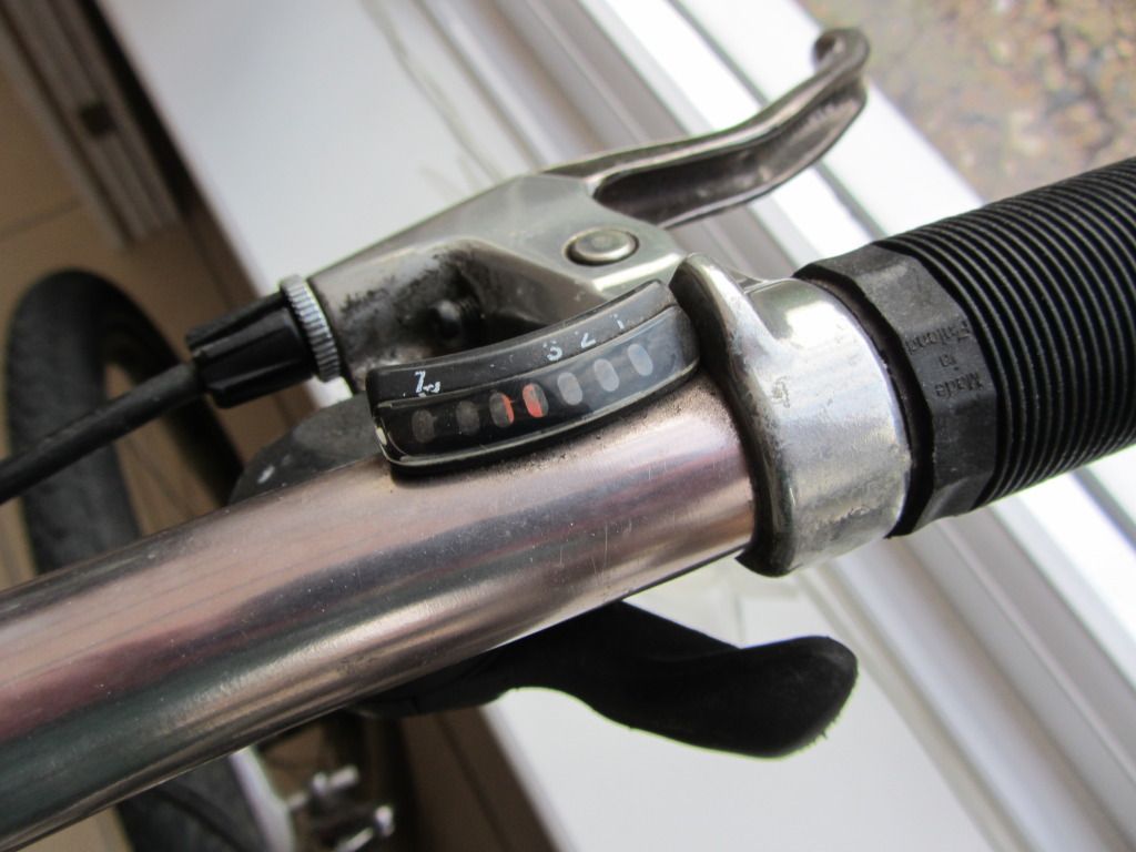

The right STI shifter will run up the gears but won't engage back down without repeated presses of the lever. Any suggestions on how to get this working, I've heard it's not a good idea to go opening these up! Also the frame is beginning to develop rust spots and chips in what looks like lacquer. Should I strip all the lacquer off and get it refinished, any suggestions welcome, and all help much appreciated.

dump WD40 into the cable replacement hole on the shifter
they get gummy with age.

Yeah as above, spray a load of wd40 into the shifter, then work it into the mechanism by working the levers.
I think you have a plated frame, the lacquer isnt lacquer but a metal coating on top of the steel frame. Stripping it will require a lot of work and or an industrial process. My preference would be to get some metal polish/chrome polish and an afternoons worth of elbow grease.
Your fork is an Orange F7, original spec for rigid Oranges of the time.

Welcome, yet another 'newbie' with a P7, that's a good few now in recent weeks!
Yours is a 1995 and looks very tidy, should come up a treat with a bit of TLC
