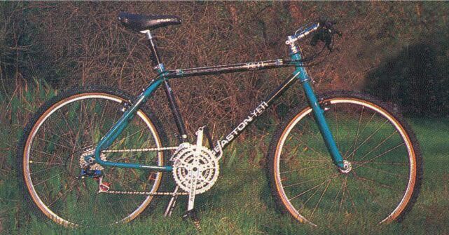

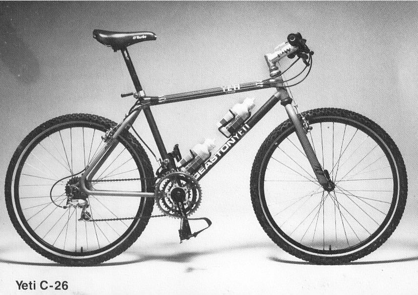

With the shipping of my FRO frame to Chris Hertig I officially kicked off my latest project aimed at converting a old school Yeti FRO into a C-26 prototype replica. My goal here is not to make another C-26, in fact it won't be labeled as a C-26 but rather to build a tribute bike to the C-26 proto which has not been done before. There are several replica or post-yeti built C-26s, but as the original proto has been destroyed there are non in existence at this point in time.
Here is what I'm going for:
Here are some pics of the donor FRO frame and a link to my blog post providing some more info:
http://www.secondspincycles.com/2012/08 ... oject.html
This specific FRO has several damaged areas (seat tube, dent in top tube, modified BB shell) which make it a suitable candidate for this conversion as the frame will effectively be destroyed during the conversion process. My previous FRO was far too nice to use for this project and I am very happy to have found this one.
This project will take a very long time to complete, so updates may not be that frequent, but I'll do my best. All of the work on the frame is being done by Chris Hertig who build all of the original C-26s, FTW is going to build a replica of the original stem used on the proto (clamps onto an extension brazed onto the Yeti fork).

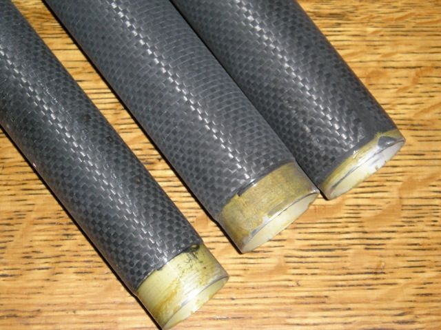

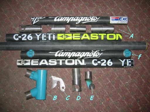

Pictures of what's left of the original prototype tubes:

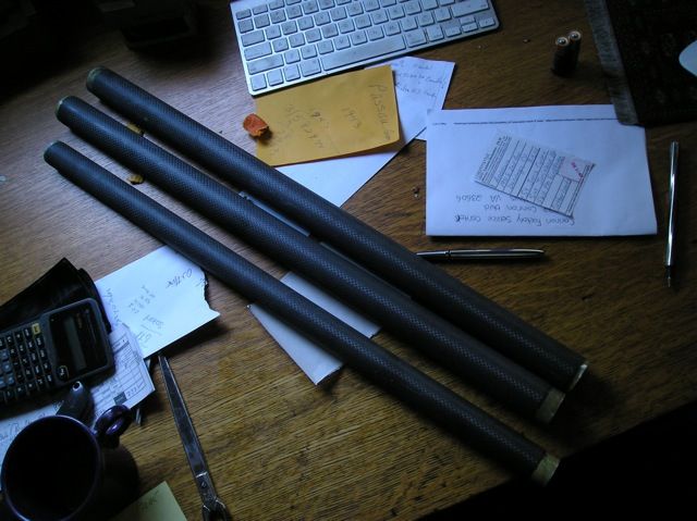

Pictures of my actual carbon tubes (supposedly the last set):

I am a bit thick, so bere with me, but how did the frame on the prototype frame you have pictured, differ from the others..?
Frame differences
1. Simplex dropouts vs. machined ones (like on later FRO, ARC, Ulitmate)
2. Cable stops on top tube are bonded onto the carbon section, later C-26s had cable stops welded onto the metal sections of the frame
3. No reinforcing gusset on the drive side chain stay like later FROs
4. Cable stop actuated front derailleur as opposed to using a pulley to route the cable to the front derailleur
Other differences
1. The prototype bike had a custom made FTW stem that was a sort of forerunner of the modern day threadless type stems. An extension tube is brazed onto the Yeti fork and the stem clamps onto that extension like today's stem. Fork is still threaded and uses a threaded headset.
2. Decals didn't say C-26, just Yeti, Shimano, Easton and so on in different photos
