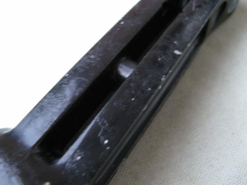

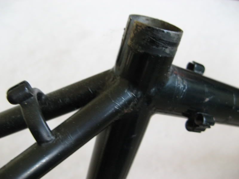

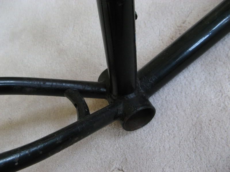

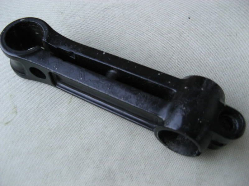

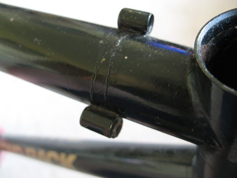

Since finding this site and rediscovering my love and appreciation for mid to late 90s mountain bikes I felt really sorry for it and wished I’d taken better care of it, and have been meaning to do something with it. I gave it an initial clean up and strip and realised it was going to need a bit more than a quick squirt of Muc-Off and a hose down. I didn’t take any ‘before’ pictures of the whole bike but you can get an idea form the state of the frame and stem – lots of spiderwebby rust under the paint, lots of tarnishing to all the metal drivetrain components.

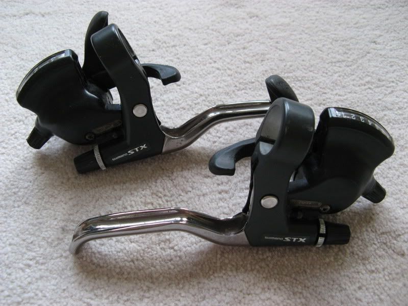

The frame, forks and a lot of the components then spent about a year and half in a box at the back of my wardrobe while I got distracted by other projects, although I did start hand polishing some of the components. I’m aiming to keep as much of it as it was when we were both younger and in better condition. I reckon I can salvage everything except the brakes, STIs, chain and possibly the cassette, and these will be swapped like for like, so it’ll be keeping an STX group.
Polished cranks

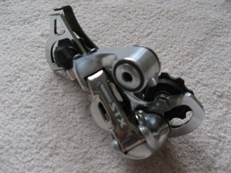

Rear mech

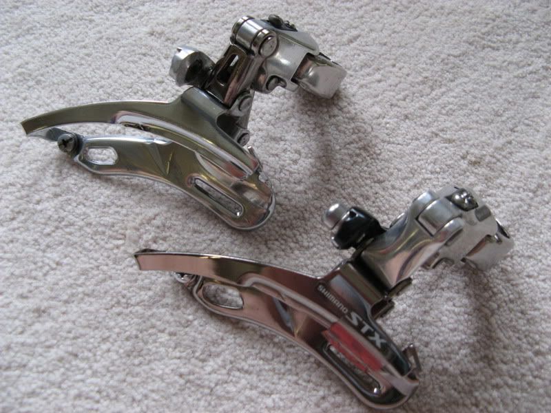

New NOS front mech or old polished one?

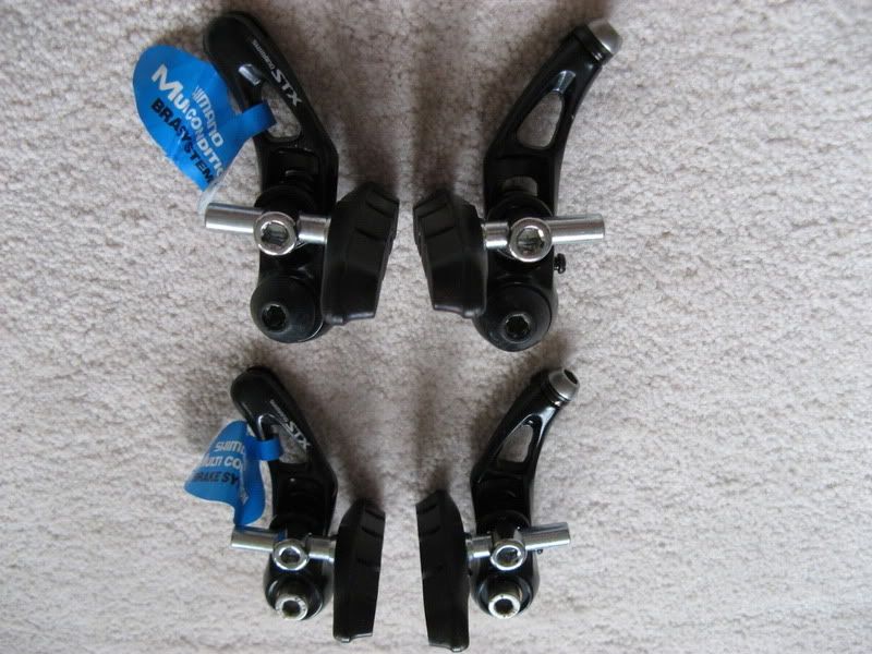

New brakes

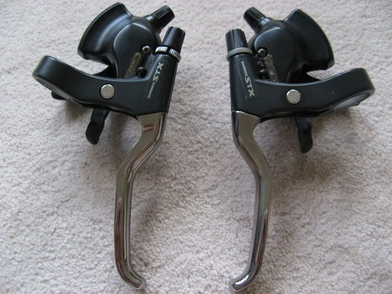

New STIs

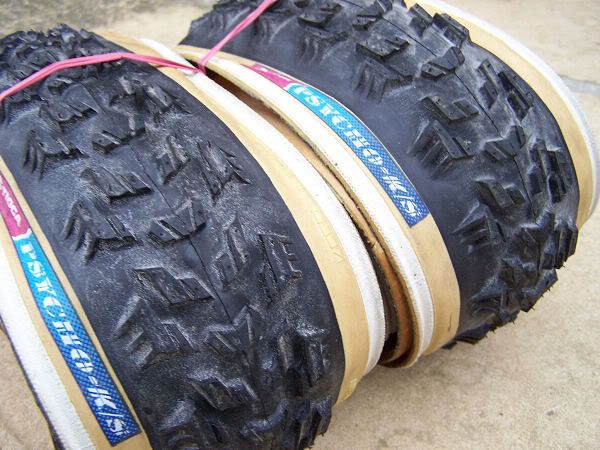

I have the original Avenir Vigor EX tyres but remember not liking these much back then. Think I used the classic Smoke / Dart combo instead. I remember the higher end Apex and Axis bikes having skinwall Psychos and thought they looked really good so managed to find a NOS set which I’ll fit.

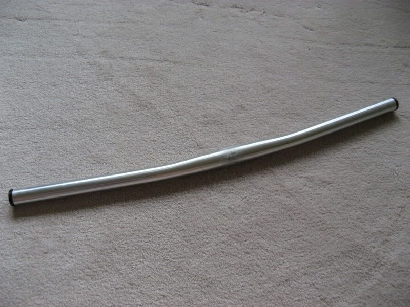

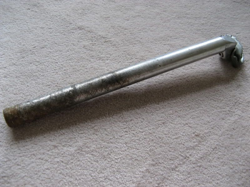

Also have the original bar which I'll use as its in really good condition, and the seatpost which I might replace as its tatty and looks just like a generic alloy one

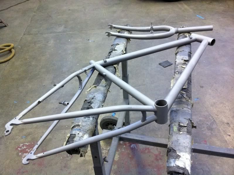

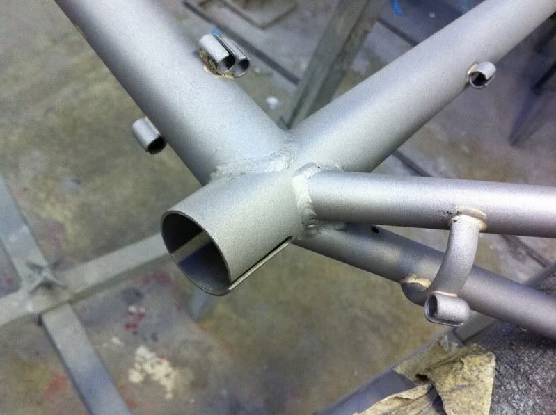

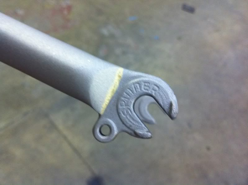

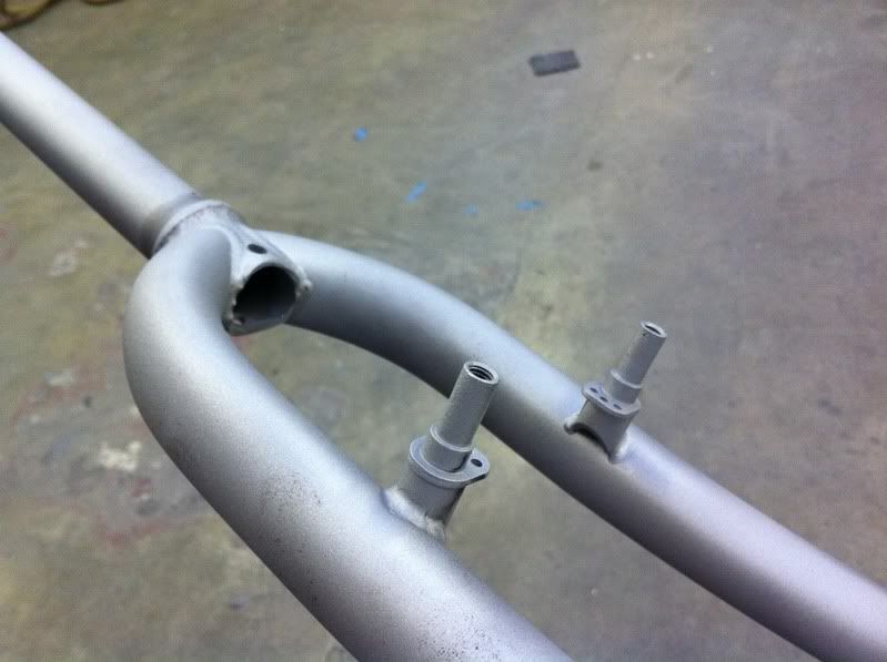

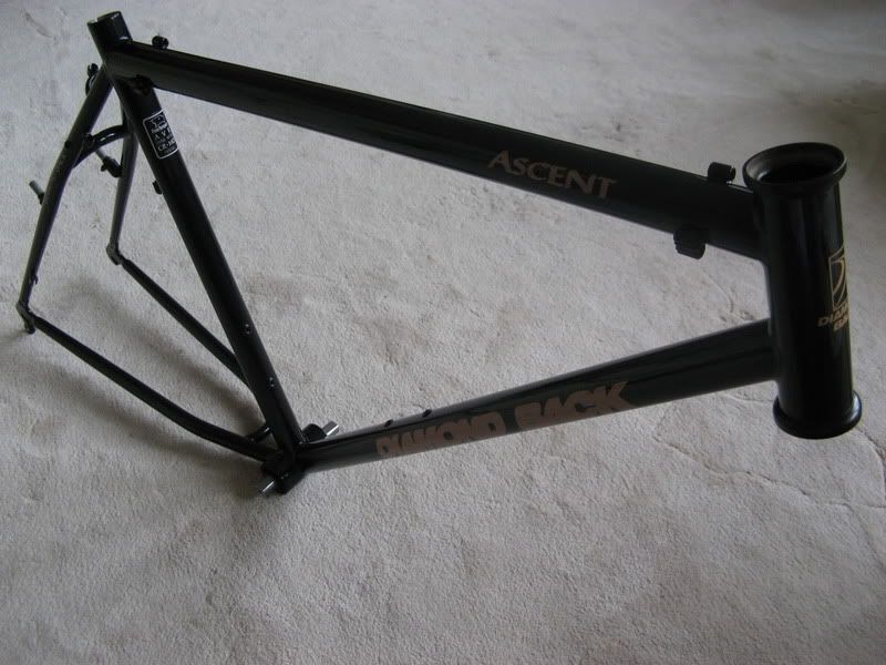

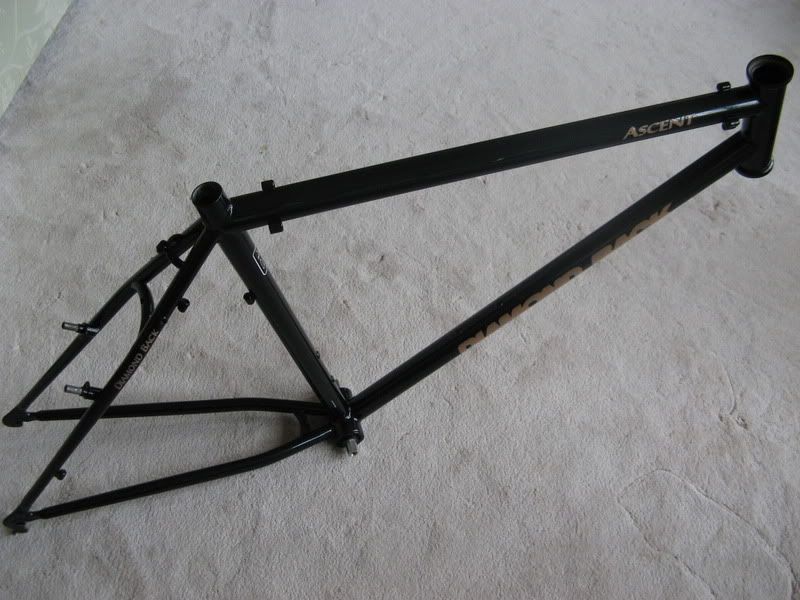

I’ve also finally got around to sorting the frame. Gil has made some great new decals for it, and the frame and forks have been shotblasted ready to be sprayed.

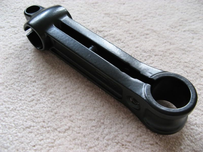

Also got some of the finishing kit like the stem blasted and powder coated.
Next step is to get frame sprayed in as close to the original colour as possible, fit new decals and lacquer, finish polishing up the components including the wheels (Araya TM-18 on STX hubs) then build and enjoy!

NOS Psychos - almost seems a shame to use them....

Finally got the frame back. Its been sprayed, flattened down, decals by Gil applied then lacquered over the top. I'm really chuffed with how its turned out. It really looks like it did when new. Being such a dark colour it hasn't photographed well but its a lovely really dark metallic green that looks different in different lights. Decals are spot on. Just need to pull my finger out and finish polishing up all the parts for it and get it built.

Is it paint on the frame, or powder? Looks stunning either way :wink:
 Post subject: Re: Paint
PostPosted: Sat Oct 13, 2012 12:32 pm
Joined: Tue Apr 27, 2010 7:15 pm
Posts: 662
Location: Eastbourne / London
Thanks, the pics really don't do it justice either, will have to get it outside in some sunlight. It's paint, sprayed by a car bodyshop. Think it was a Mazda colour. Would have gone for powdercoat but got a much better colour match this way.
