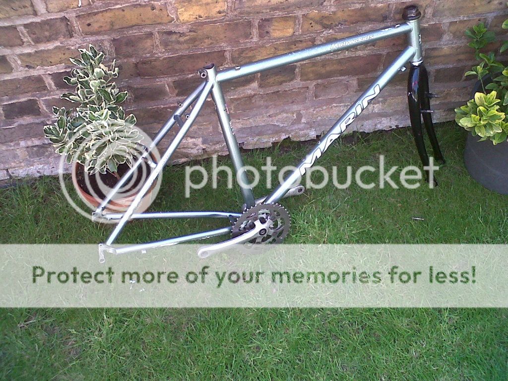

After initially deciding not to do a build thread on this, I have changed my mind!
Marin Muirwoods, with what appear to be resprayed forks, assume they are original. This is going to be a single speed commuting machine, so will be keeping as simple and cheap as possible. I have some wheels lined up for the weekend, which will take me a small step closer.
I will not be going for originality on this one, parts will be based on price, I would like something functional that I can use and not worry about. So far I have seat post and clamp, and have lined up some later Marin riser bars and tektro V's.
So, in short, this won't be a very exciting build, but it will be a very useful bike for me as I only have two road bikes at the moment, and have quickly realised that you need MTB!
I have one question at this stage:
I need a stem, and don't know where to start as it is a quill. Any suggestions?
I expect that this build will take two to three months, so hopefully at some stage you will be able to scroll down and see the finished article!
It would be great if anyone else has Muirwoods photos and can add them on to this thread, they would be very useful!

Must be a 97/98-ish model.
Will be a 1 1/8" head tube so you want a stem with a 25.4 neck, e.g. http://www.ebay.co.uk/itm/ZOOM-1-1-8-Quill-Handlebar-Stem-135mm-25-4-diam-NEW-/350575208894
Hopefully your bars aren't modern oversized ones and have a 1"/25.4mm diameter in the middle?

Thanks for the advice, very useful. Will have a look at the bars...
I would be lost without the help I get on here :)
Edit: just had a look at the zoom stem , I like that a lot, will have to get one of those!

Just spotted this lovely Tioga T-Bone as well which would match your black forks :wink:
http://www.ebay.co.uk/itm/TIOGA-AVENGER-T-BONE-25-4MM-BLACK-HANDLEBAR-STEM-/320928516846

Just checked the bars, they are 25.4 which is good, and low riser so hopefully won't be too modern looking. They are shiny and would match well with the zoom stem.
Thanks for the input, it is really helping me get some direction!
Just be wary if you go for a Zoom stem, you'll have to accomodate a canti hanger if using cantis (forget this if going for Vs), whereas the T-Bone stems tend to either include a hanger or have on integral to the stem.

Thanks, brakes are V so should be ok hopefully. I need funds before this one goes any further so maybe something else will crop up in the mean time...
