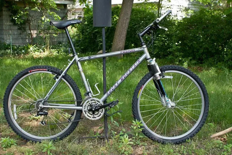

Hi folks, I was hoping someone would know the year of this RM Fusion and maybe give me some thoughts on a few fixes? [edit** seems to be a 93]
I picked it up this weekend and it seems to be mostly vanilla with only the fork being replaced [and possibly the rims/hubs but I can't tell]
I have not cleaned it - this is as it was when I picked it up yesterday.
There's a little damage [surface finish] from what I suspect is bike-rack wear.

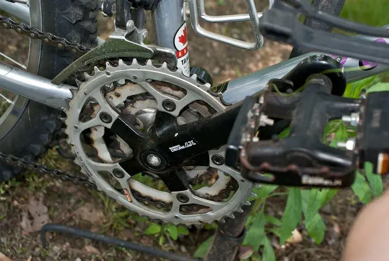

The rear derailleur doesn't seem to want to up-shift - the cable wont pull at all and the thumb has no tension. It will downshift and up-shift back to the 5th no problem. Just can get up past that.

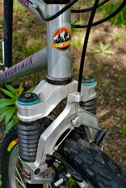

A pair of bottomed out Manitou 4 shocks [92'ish?] that either need replacing or fixing [not sure I've decided yet]

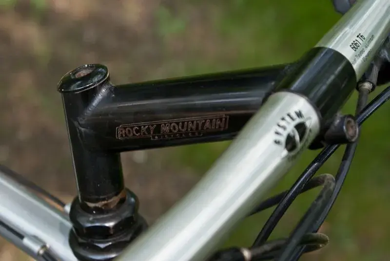

And something looks wrong on the stem. Some damage but I don't know how that happened and it looks like its riding higher in the head tube than it should - maybe someone has an idea? [i can post clearer pics of anything]

Maybe someone played with rear mech adjustment screw :?:
Few turns out should sort it I think.
Try to spray some penetrating oil (like WD-40) into shifter trough cable hole,that could help also. :)

1993 model year? Black Deore LX only appeared for 93.
T9212 = December 92?

You might be right-on there. I haven't looked it over in detail but I'll check the screws. Makes sense if the shifter is topped out but the derailleur isn't.

Was also thinking of replacing the stem. Any suggestions? Looking for something with a lower profile - doesn't ride as high. Here is a pic of my Cirrus profile

I would say 1993, in it's Mercury colouring
A proper entry level MTB.

Nothing wrong with the stem, it's just been raised up from its standard position. Undo the bolt at the top and give it a hit to lower it.
I'll give that a shot.

I lowered the stem [thanks FluffyChicken!] and got the rear derailleur/shifter sorted. You called it, rider. Going back and forth between the screws and cable adjuster I can now shift through all the gears, up and down.
